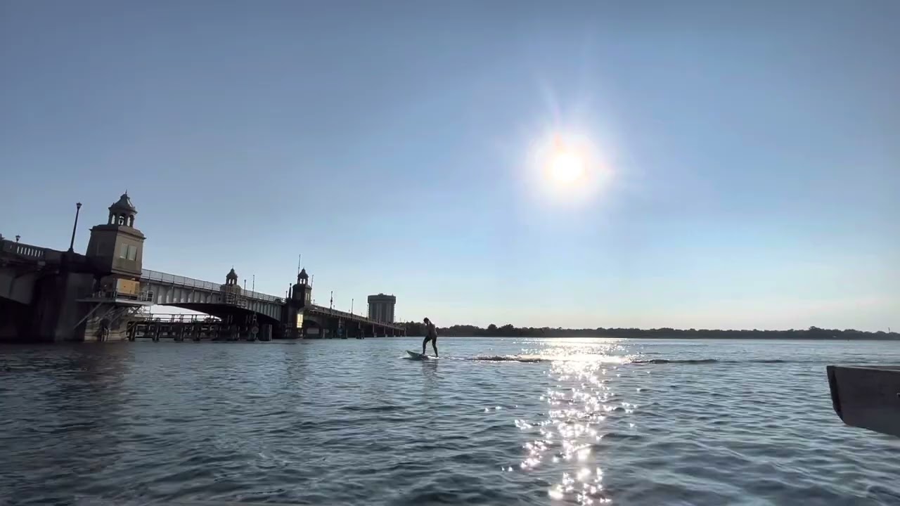

I think I’m out of ideas. Went out today with the new prop printed from enzymlefax and the mast all the way forward and…still couldn’t get up.
Today I used a slingshot outwit 6’6” 120L about 28” wide. I’m 85kg
Unsure what other things to try. The only thing I can think of is that my front wing is 1263 cm2. Maybe too small to provide enough lift at these speeds?
It’s hard to imagine anything being able to get out of the water moving this slow though
Apologies for the video facing directly into the sun lol
That’s a small front wing for what you’re trying to do. My friend has one that size and he needs to be going at a really good pace to get enough lift.
I have a Gong Curve MT, which is a 1150 cm2 wing. I weigh about 67kg. I need more speed than you had in the video to get up.
So weird. @Foil_A_Lot is able to make this work with a similar sized wing and running 6s, so like 1/4 less rpm?
This may be one of the greatest mysteries of all time
