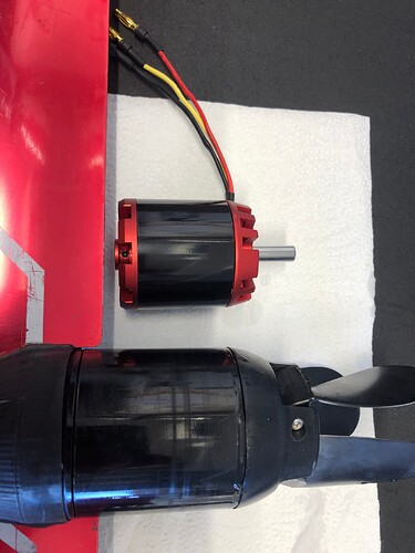

I tried the 5065 140kv motor and was pretty amazed that it worked. Not as efficient as the 6362 motor but not bad. It actually pulls the same amount of wattage I see on my Flipsky 6374 motor when getting on foil and when up and riding around (12s2p, same front wings, rider weight, board, conditions). Obviously it is much smaller and lighter as well. I made a two blade hub for the motor that fits the FD aluminum blades. This hub still needs some work. I left my mount and side cowling pieces the same for testing which are a bit oversized for this motor. I assume after updating these and streamlining better I will see some improvement in the efficiency. Pretty excited that I was able to ride with such a small motor. Thank you @Jezza for recommending this motor.

What is the motor weight?
390 grams per the manufacture, I have not weighed it myself yet.

This board is 4’11” and 18.5 inches long. Weighs 4.6 kg empty, 10.8kg with this motor ready to ride including 12s battery and foil, mast, leash, etc. This motor would work on your 4’8” board but would probably struggle on the 17L one.
I wanted to try some smaller motors to see what lower limit in size is. I think I have reached that with this motor. Will continue to test and run the 5065 over the winter but feel that the 6362 is a little better all around. The 5065 would be my choice for SUP assist but for prone assist the 6362 feel like the better choice.
