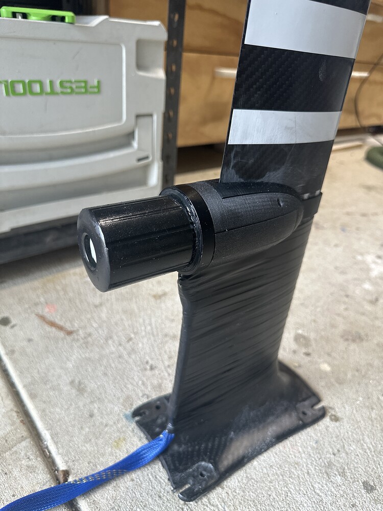

I am using the standard MR60 connector with dielectric grease. This has been run weekly submerged in saltwater without any issues. The only step I take is to always apply fresh grease before each use.
I will share any files you need for the setup but I do not currently have the free time to make changes to fit different masts, etc. If the current motor cowling works for you let me know and I will share it with you.
Swapping masts might make the 5065 work a little better but it still has less power then the 6362 motor. Also the 6362 fits the standard foil drive propellers making it easier to run different prop setups. With the 6362 and two blade FD propeller on 12s2p I get 35 minutes of continuous efoil time and about 55 minutes of prone surfing non stop on an 850cm front wing.
The 5065 motor does have much smaller wiring and I use 16 awg down the mast for the phase wiring, 14 awg down the mast for the 6362 motor. The maytech 5090 would probably work well but would need to be rewound to lower the KV down to a reasonable value. Maytech motors are also hit or miss quality wise. I will try to get some good photos over the next few days to share with you.

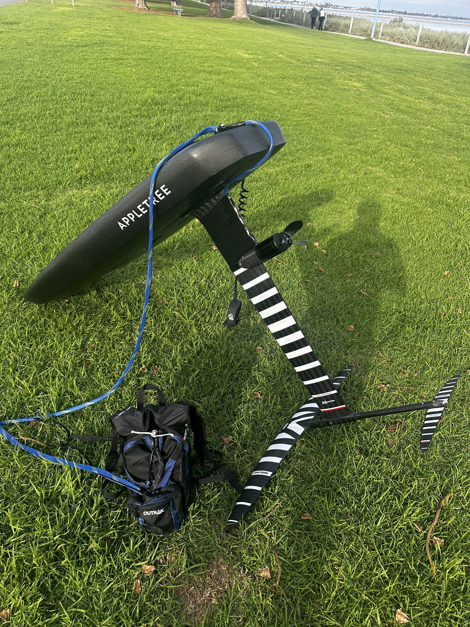

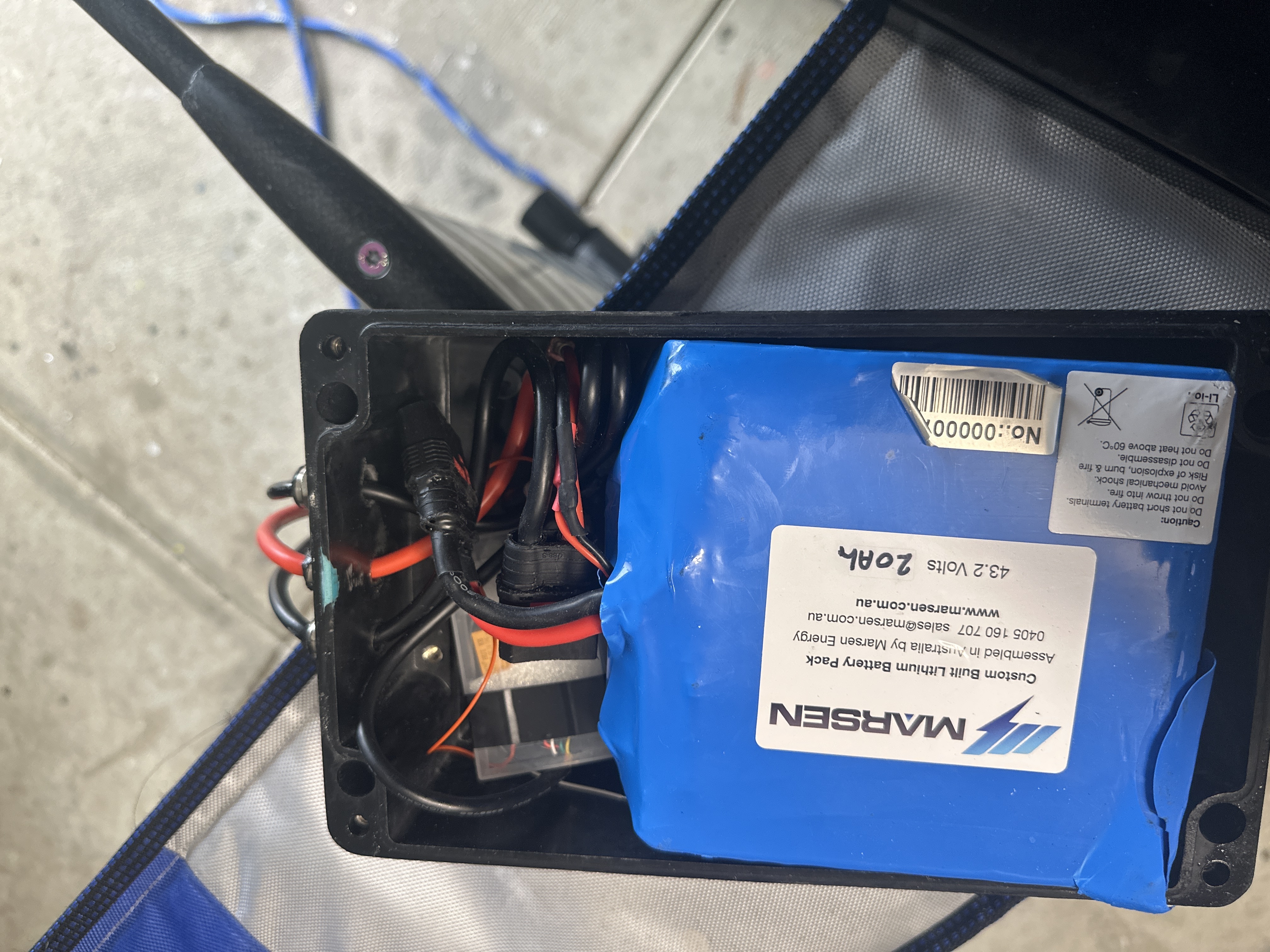

My lastest setup I’ve gone with now is flipsky 6384 water proof motor, maytech 160amp esc water proof. Kparts motor mount and 3 bladed Ali prop. Battery is molicel 21700 50p 12s3p inside ip68 rated box in camel pack. I’m 95kg on 80l apple tree 5’4” x 22 board Armstrong HA980 with 180 speed tail gets up and going easy I’ve been getting 30-40mins 7.5kms at full efoil.

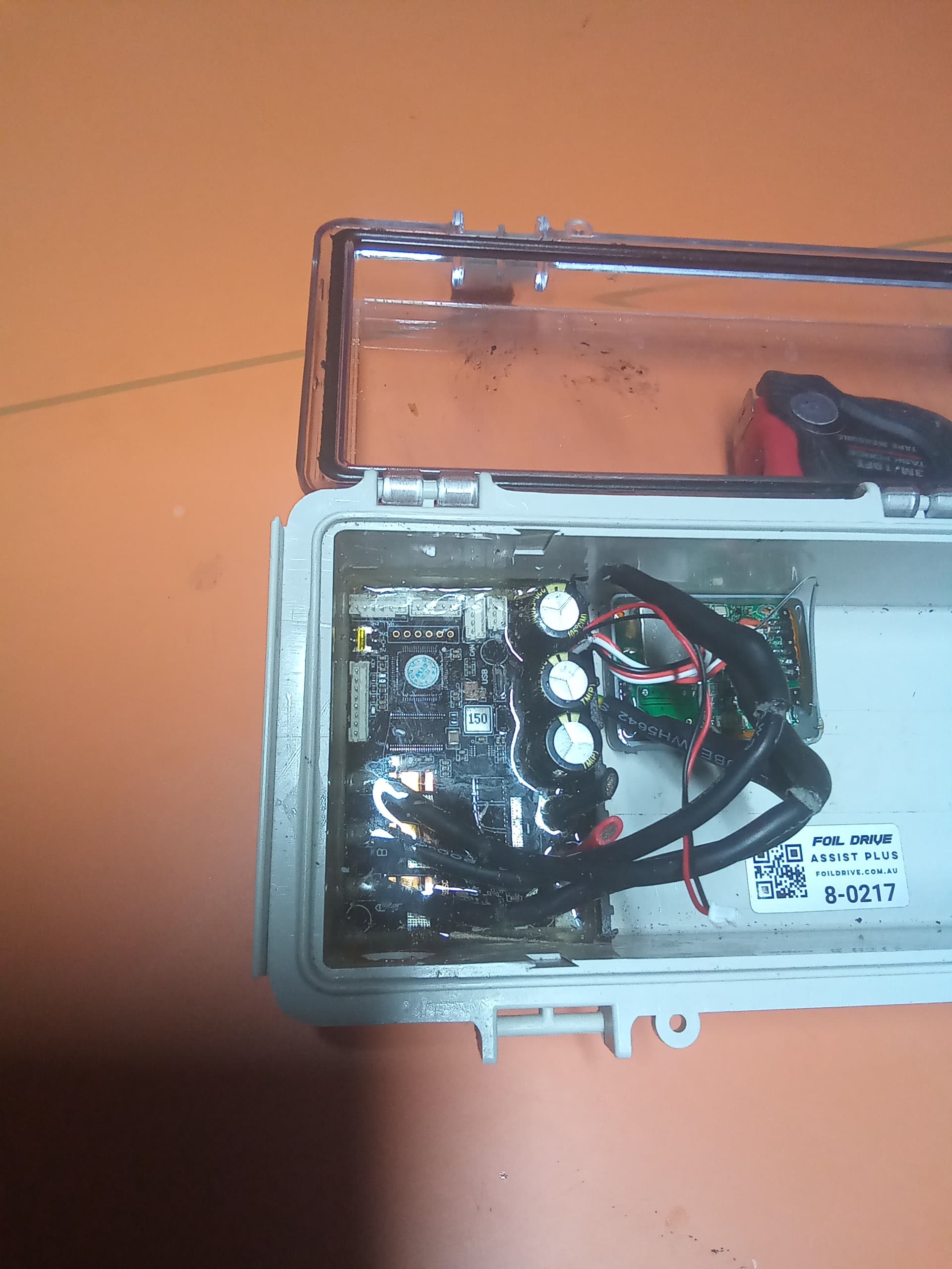

I didn’t get to run flip sky 150amp vesc for long it cut out as soon as I went in water to try so I went back to maytech 160amp speedy.

I built this board with negative angle so angle of wing is slightly down but I’ve added maybe 3 or 4 degrees which is too much for assist.
My other boards are fine and sit more level.
