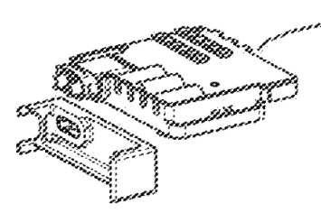

Foil Drives patent application for the Gen2 was filed in Feb 2023 with a launch in October 2023. (WIPO - Search International and National Patent Collections).
Foil Drive claims the priority date for Gen2 was 25 Feb 2022, but that seems a bit odd considering their assist plus only launched on 14 Feb 2022.

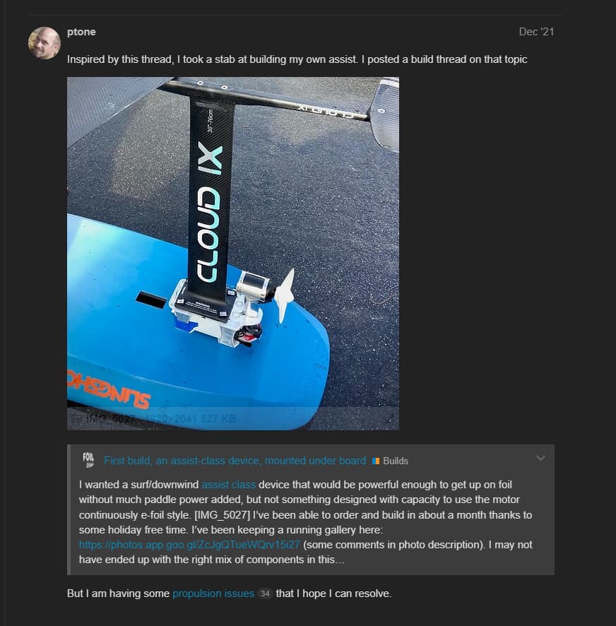

Then there are open source systems that pre-date foil drives claims:
Foil Drive Assist, DIY - #119 by ptone?

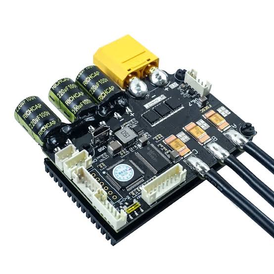

I wonder, given the compact size of the controller and FoilDrive’s penchant for Maytech devices, if this is the model they use?
I think for Gen1 they used FSESC_6.7_PRO
Pretty sure its what they are using.

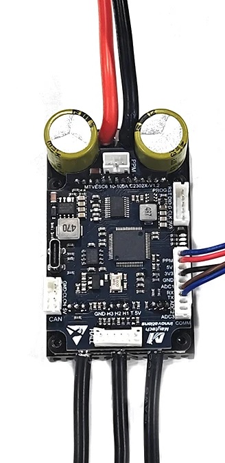

The 6.6 looks like a better fit and already includes the XT90.
They are indeed using that one. Interesting that they picked a 60A max controller…
How do you tell users that you have a low-power controller that is overheating?
Here’s how: we give you a free 10-second boost.
Whats more amazing is how they convince their users to buy into the obvious engineering faults…
That picture is a 6.7. Its written on the board.
FD uses the 6.7 pro v2.0. Its a 70A and the FD units top out at 1800w.
