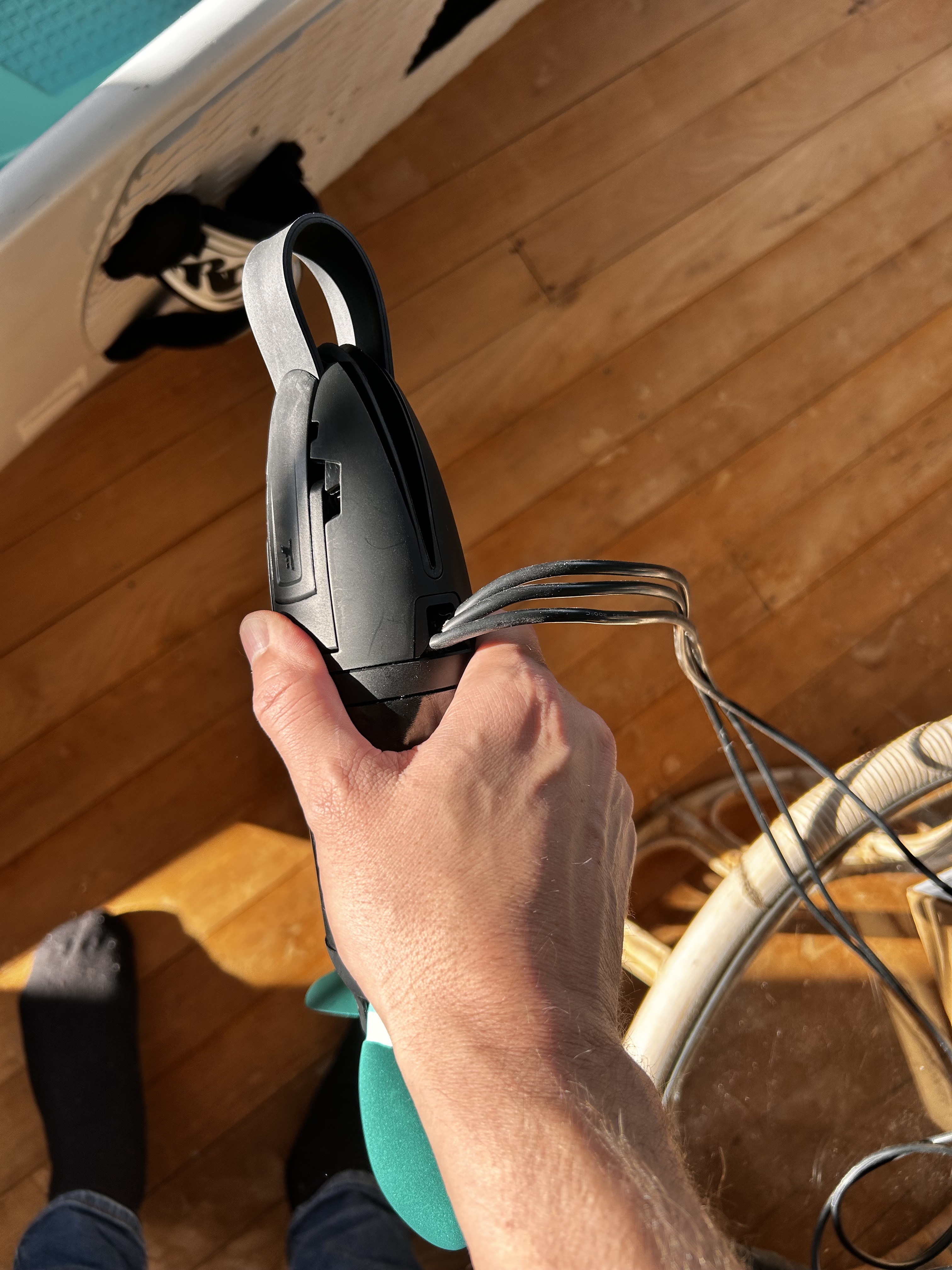

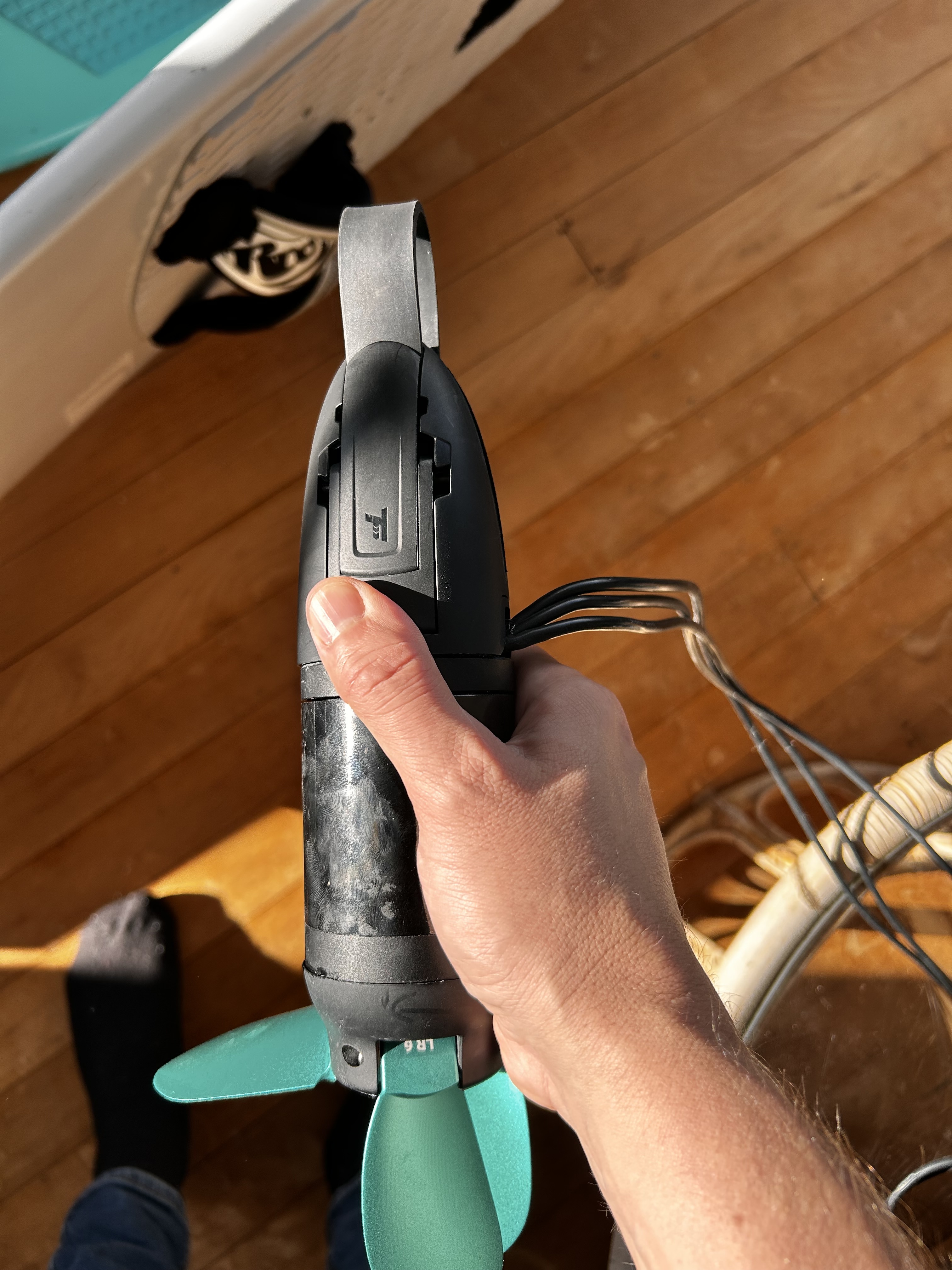

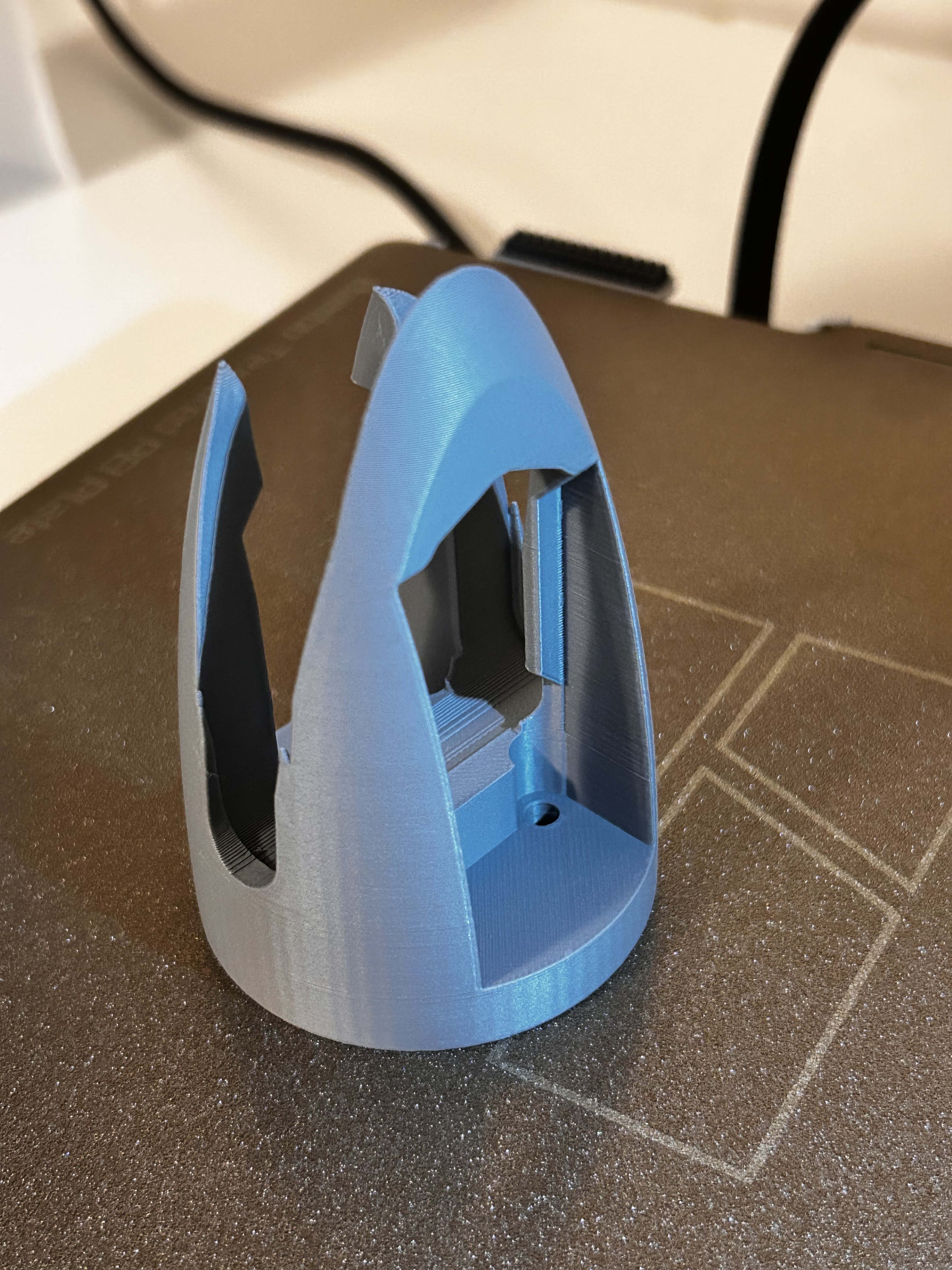

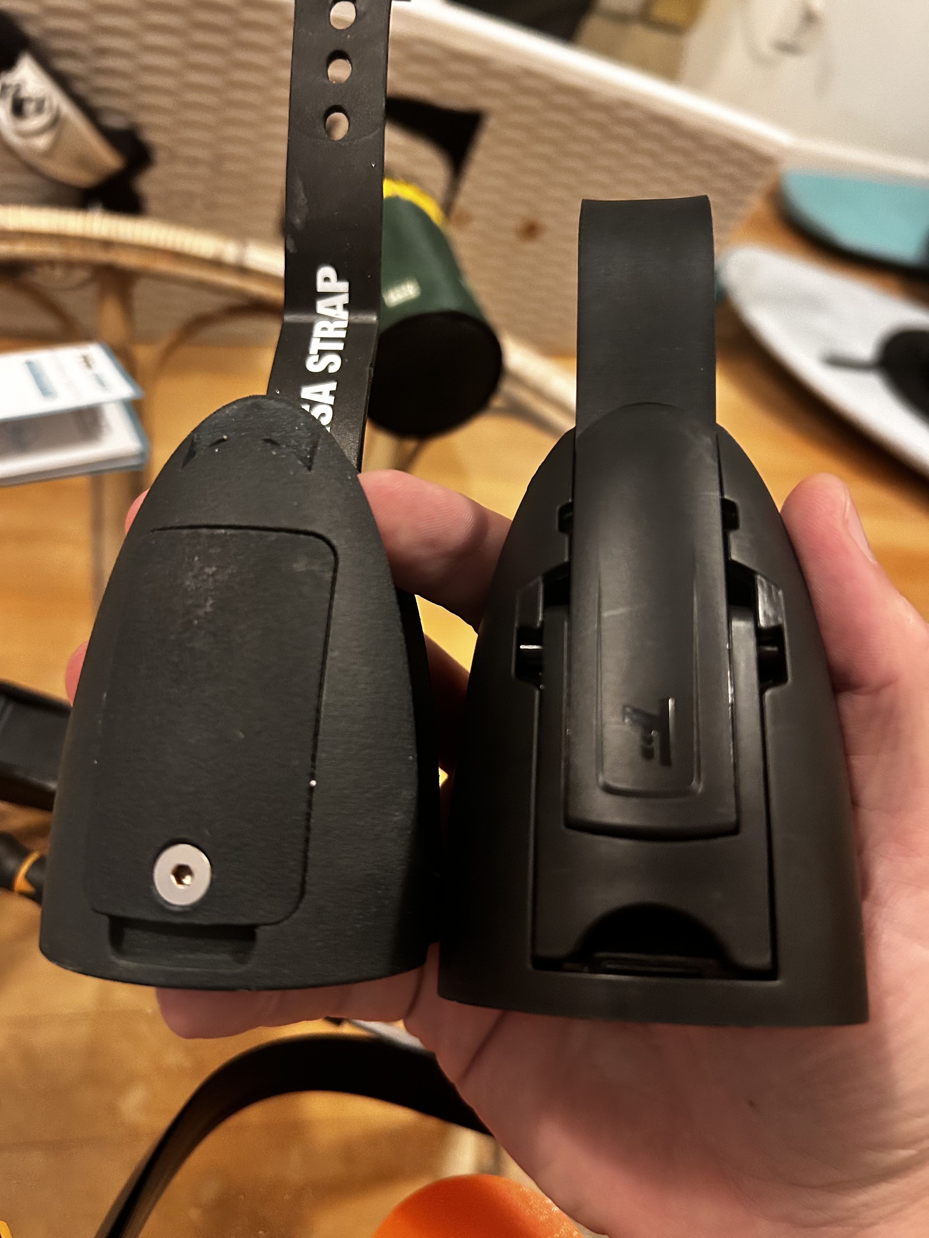

For those wondering if this combo works, i’m sure it will. The cables come out the side just fine, but i’m going to have to print an adapter as the FD HP bolt PCD is a bit different to the Flipsky 6384’s PCD. I’ll share the STL for free as soon as it’s done. Also the FD pod is nice, but doesn’t look as hydrodynamic as @foiling_moose’s one and its way more expensive!
Haha where did you manage to get you hands on the FD copy of the nano pods?
If you are after a toolless setup its great, but I never really change masts anymore. Having a dedicated alloy mast is so cheap to do and there are ways to do nano pods on alloy and carbon masts without the strap.

Per the FB FD groups looks like the FD mini pod is now at retailers in AUS, soon stock to start appear in the USA.

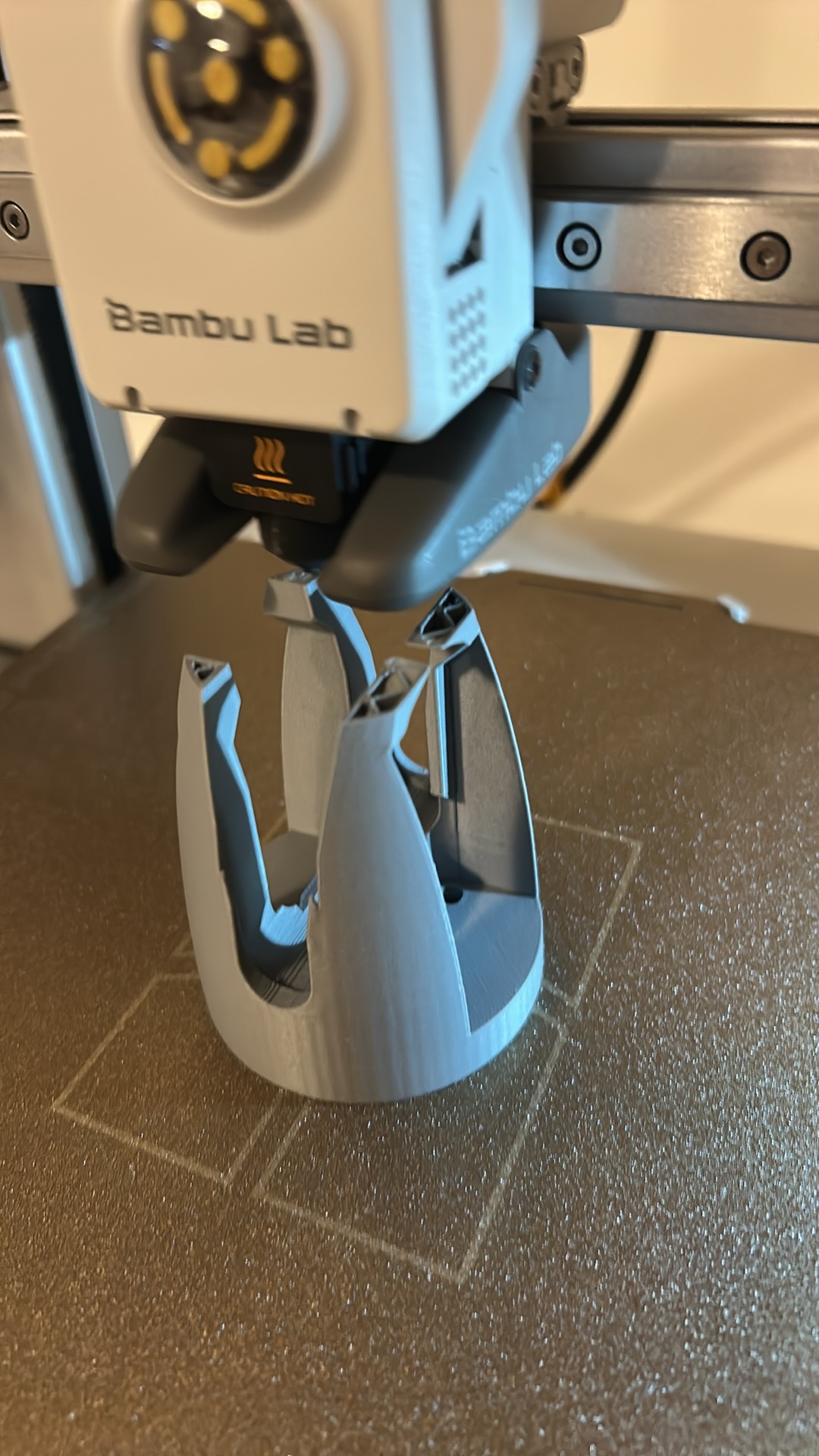

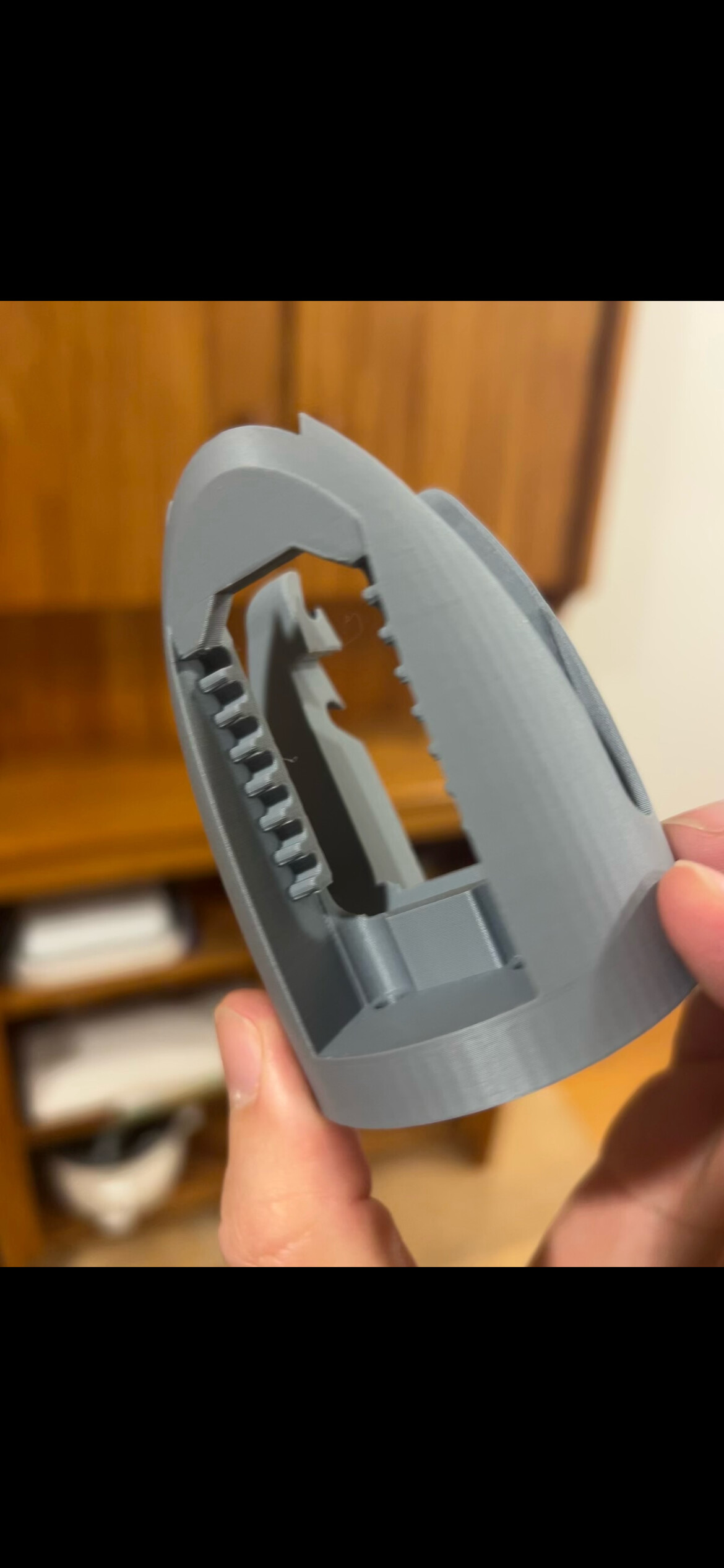

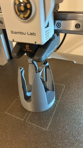

made a bit of progress on the flipsky adapter today

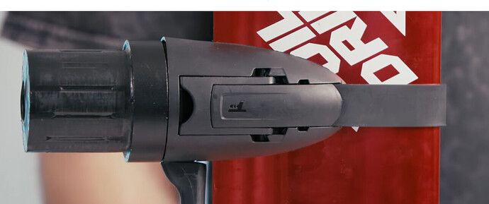

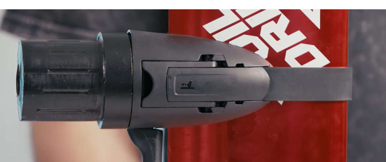

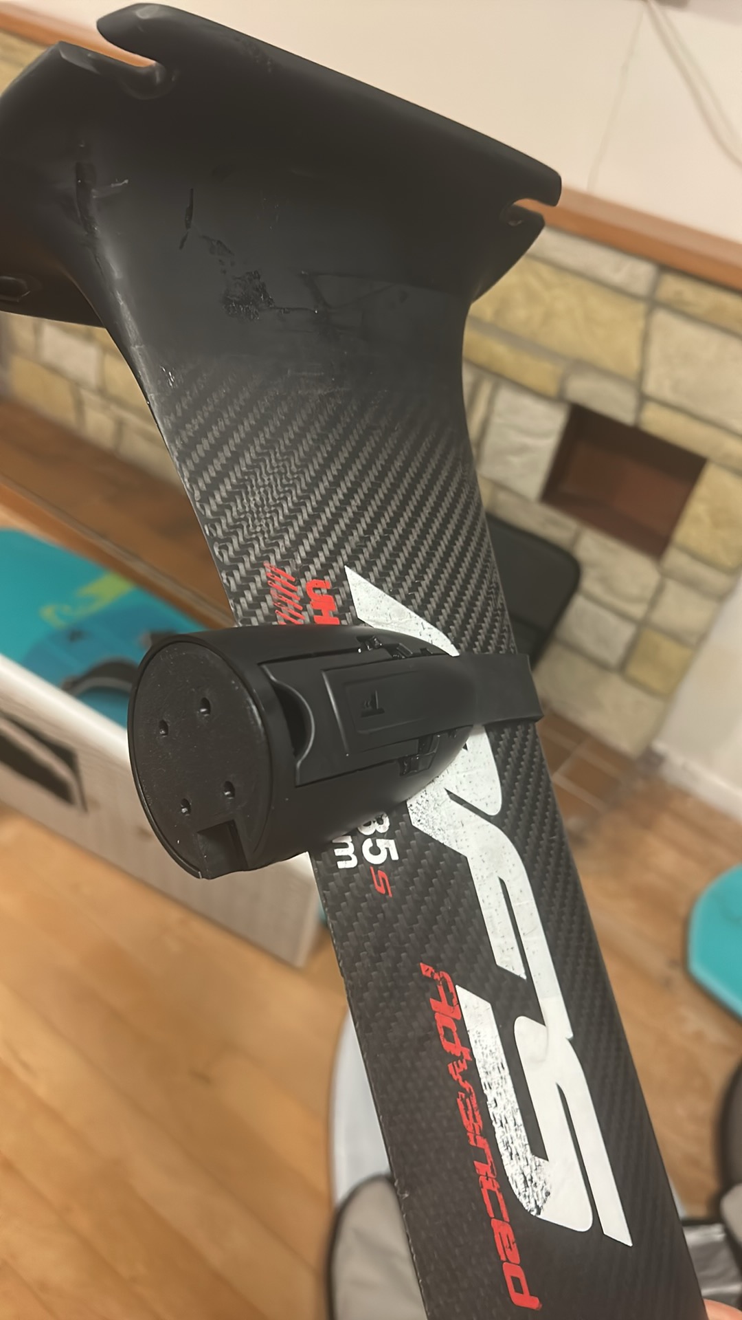

I’ve also noticed it distorts quite a bit on different masts

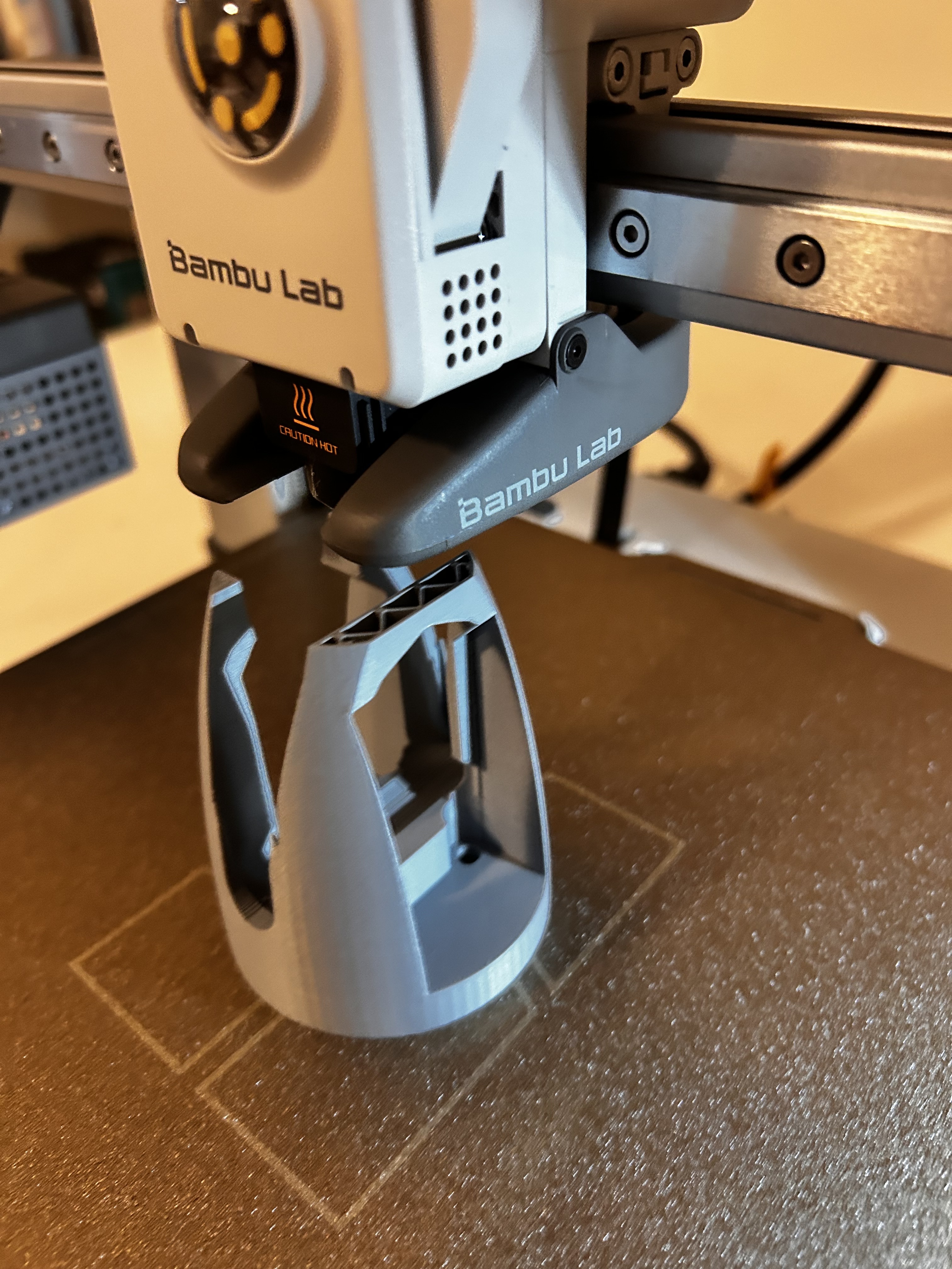

yeah i noticed the distortion too, definitely gona 3d print my own version, done the hard bit already so it will work with a flipsky motor
Also, had a bit more of a think about this, i’m not going to share my stl, FD has put a ton of effort into this design and they are GC’s I bought and will use their pod, my printed part is just an integrated adapter really for my special use case and will definitely be weaker and less optimal than the oem part especially if used with FD motors.

What’s interesting here is how in the past everyone has waxed lyrical about needing the pod at 90% to the mast. With the new FD mini pod on carbon masts, its almost always at an angle depending on mast. I wonder if they will release a new rubber insert to fix it.

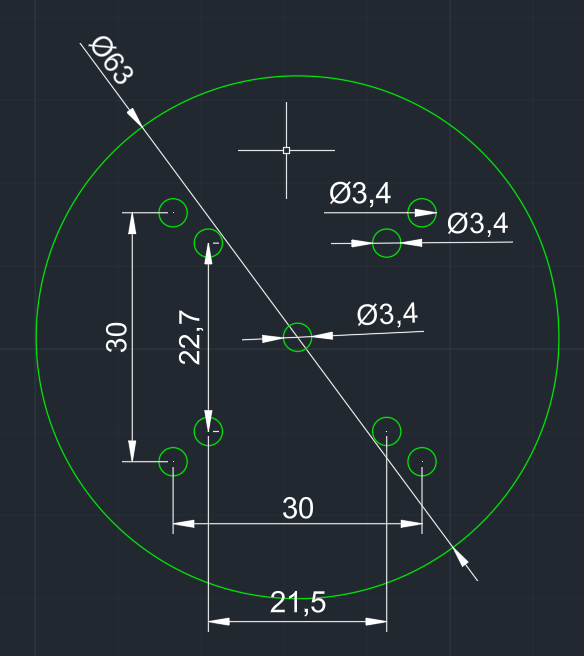

Finally, I got off my butt and drew up a diagram of the hole geometries for the original Gen2 motor and the new Mini Pod.
I’m sharing the information. Tomorrow I’ll finish fabricating three 6mm aluminum parts.
Of all the options I’ve been sketching and creating 3D models, the best option is CNC or laser cutting and machining the holes so that the outer ones have countersunk screws and are perfectly integrated into the part.
90nm anodizing or 120nm epoxy paint will be the finish… pure showmanship…
Your dimensions are wrong. They old motor is 30mm spacing diagonally across the centre. The new motor is 44mm diagonally across the centre. Use a circle to get the bots in the right place for the adapter.
Use acetal instead of aluminium, that way you don’t need any finishing. Adding 3mm thickness won’t have any weight penalty either.
*Sorry I know I asked dims, but managed to find them onine.
the new FD mini uni pod has bolts on a rectangular layout not a normal PCD (square) layout
