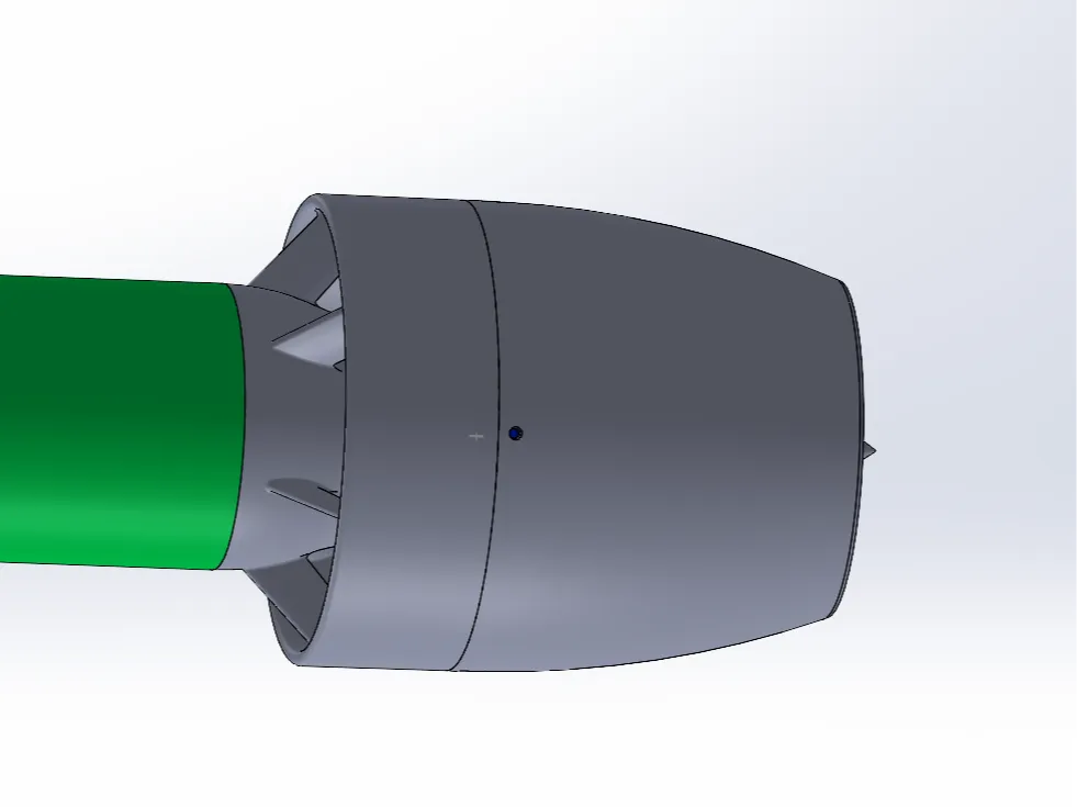

Hi, thats me. It is something between Jet and ducted prop.

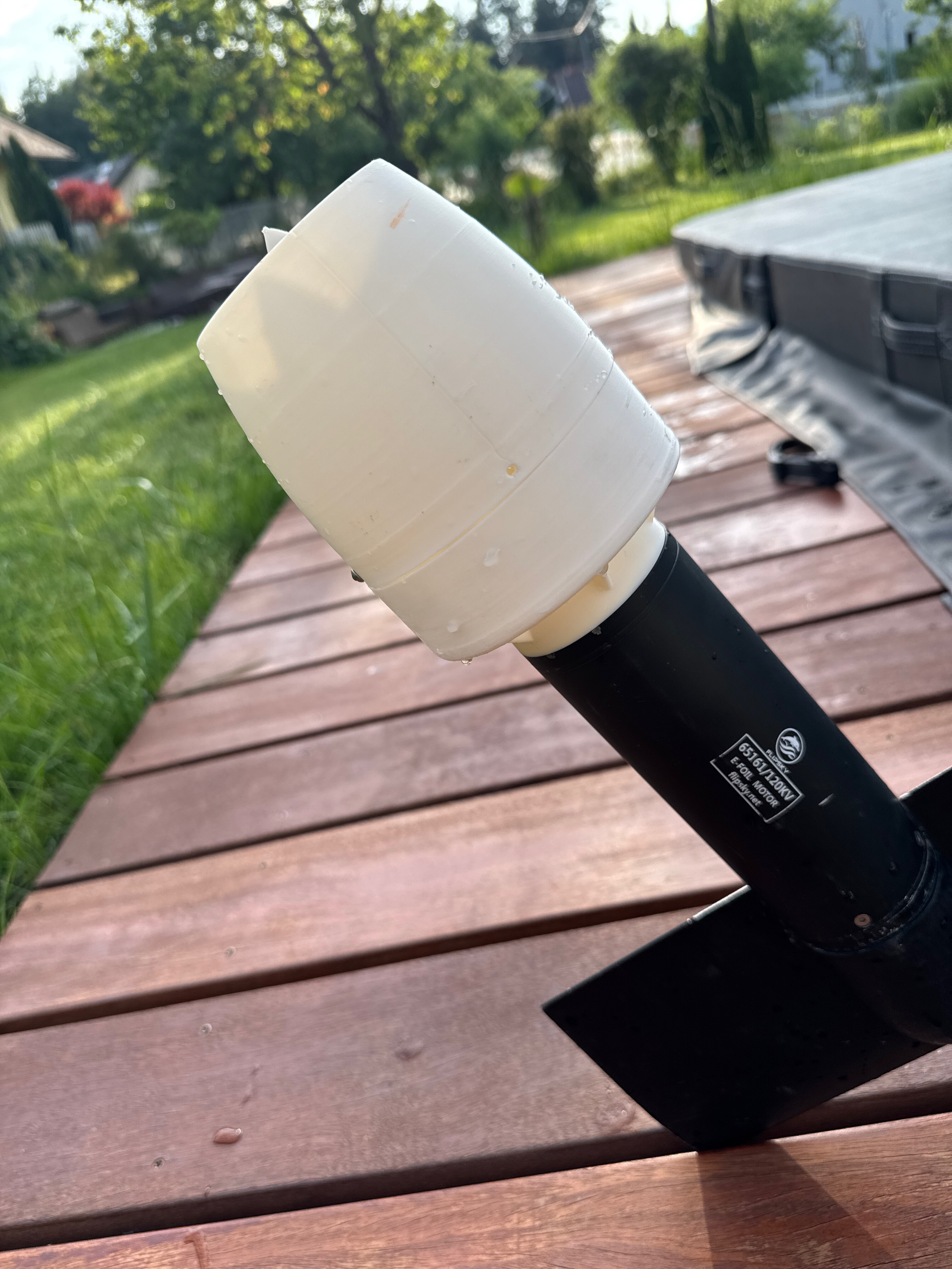

I printed it in ABS. I drove it only 1 time so far, no log. Stability gain is massive due to the duct. Should be possible to use smaller stab.

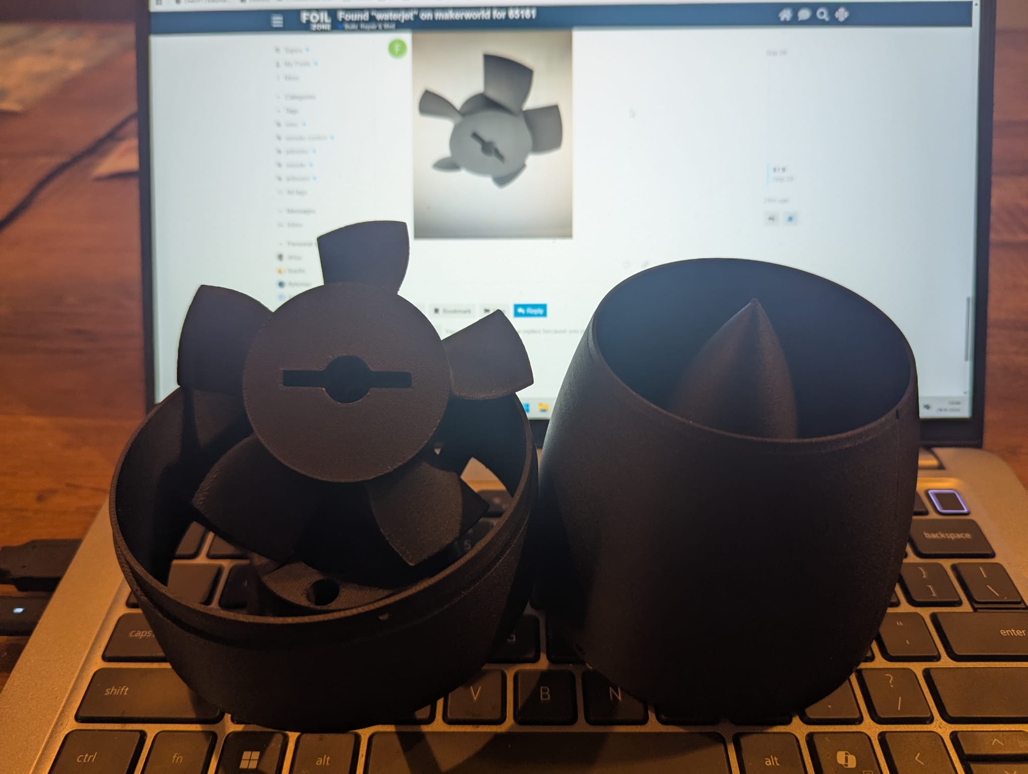

I have decided to try it in PLA-CF as I don’t have a venting setup for ABS. The props I’ve printed in this material are nice and stiff and have not failed (so far :grinning:)

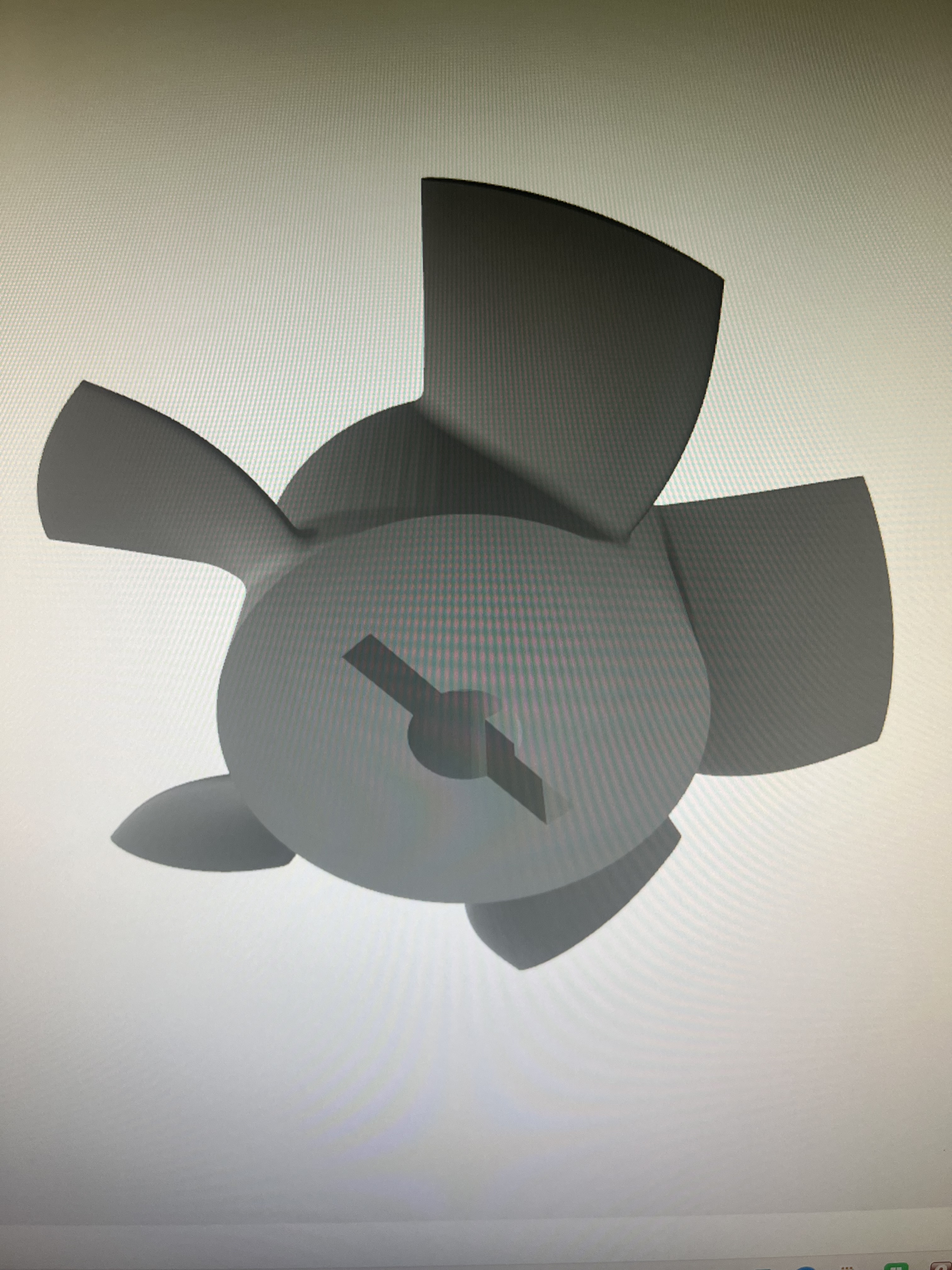

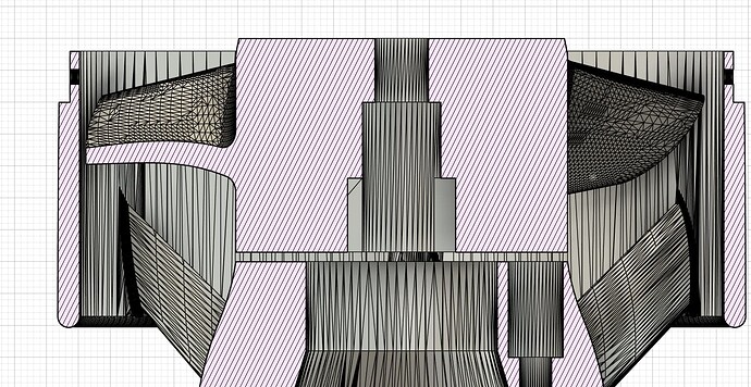

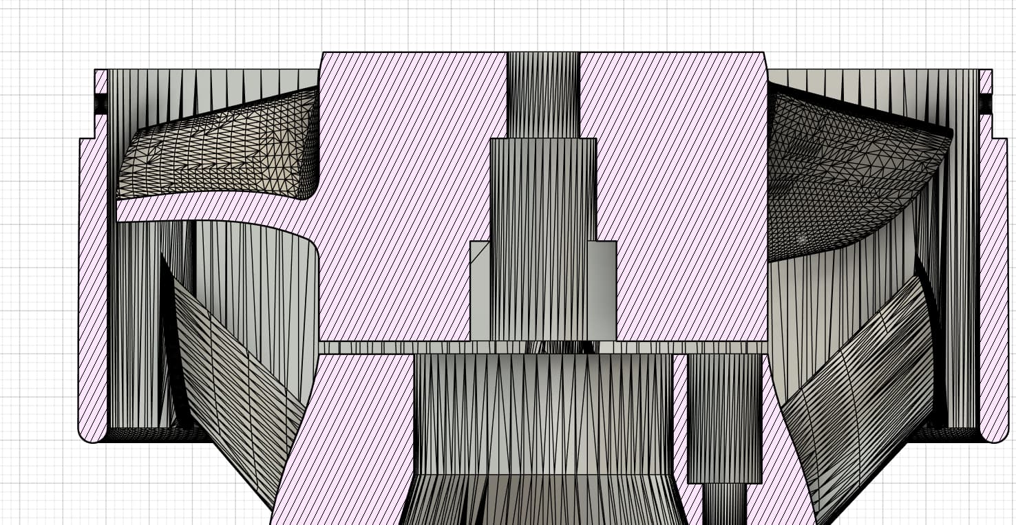

Can you tell me what the dimension of the gap between end of impeller blade and inside of rear part should be. I had to mod the impeller part for a different pin size and don’t think I messed up outer diameter of the part but would like to be sure. My CAD skills leave a lot to be desired😜
I have the back printed and it fits the motor really nicely. :grinning:

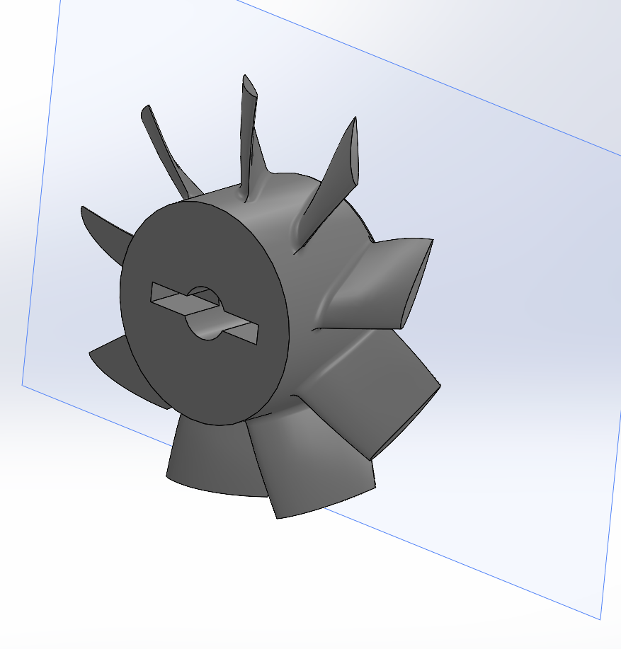

Printing impeller now.
I attach a size comparison of Flite prop to the rear part.

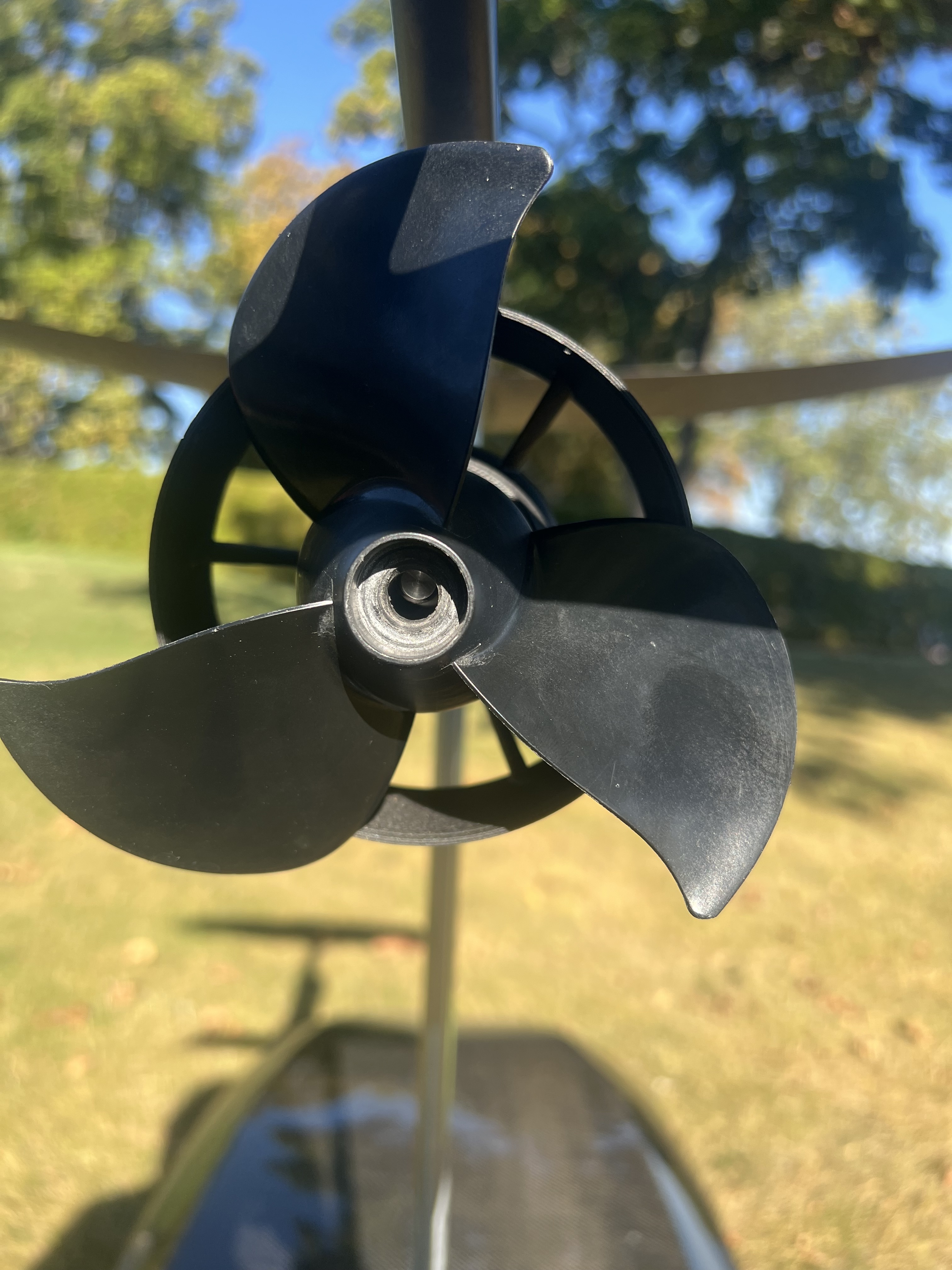

That is exactly what the original Lift Jet drive is. Tiny 3 blade prop inside a duct with very tight gap between end of blades and inside of duct.
@Toto44 version looks more like what I envision when I think about an impeller.

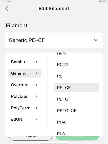

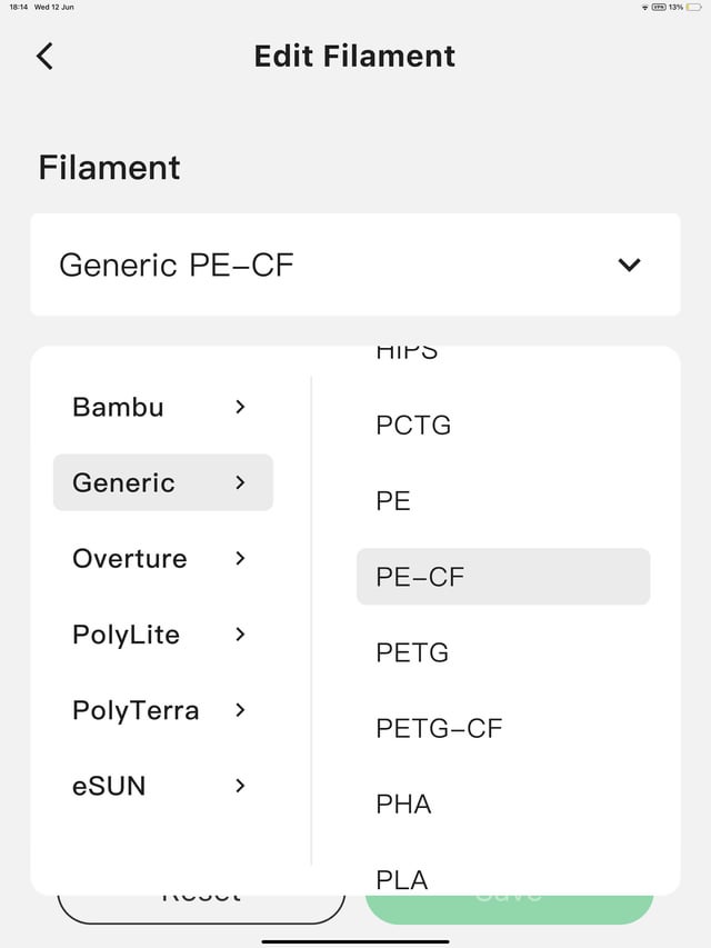

Casing PETG-CF,
Prop: PET-CF
Can you show a photo of impeller inside duct that shows gap between blade and inside of duct please.
Can’t find this on Bambu site?
It;s 1mm
My misstake. PET-CF
Thanks for the dimension - that’s pretty tight which I think is the reason the Lift jet drive works.
I searched for PE not PET Duh :slight_smile: Thanks
In the app it’s called pe-cf.

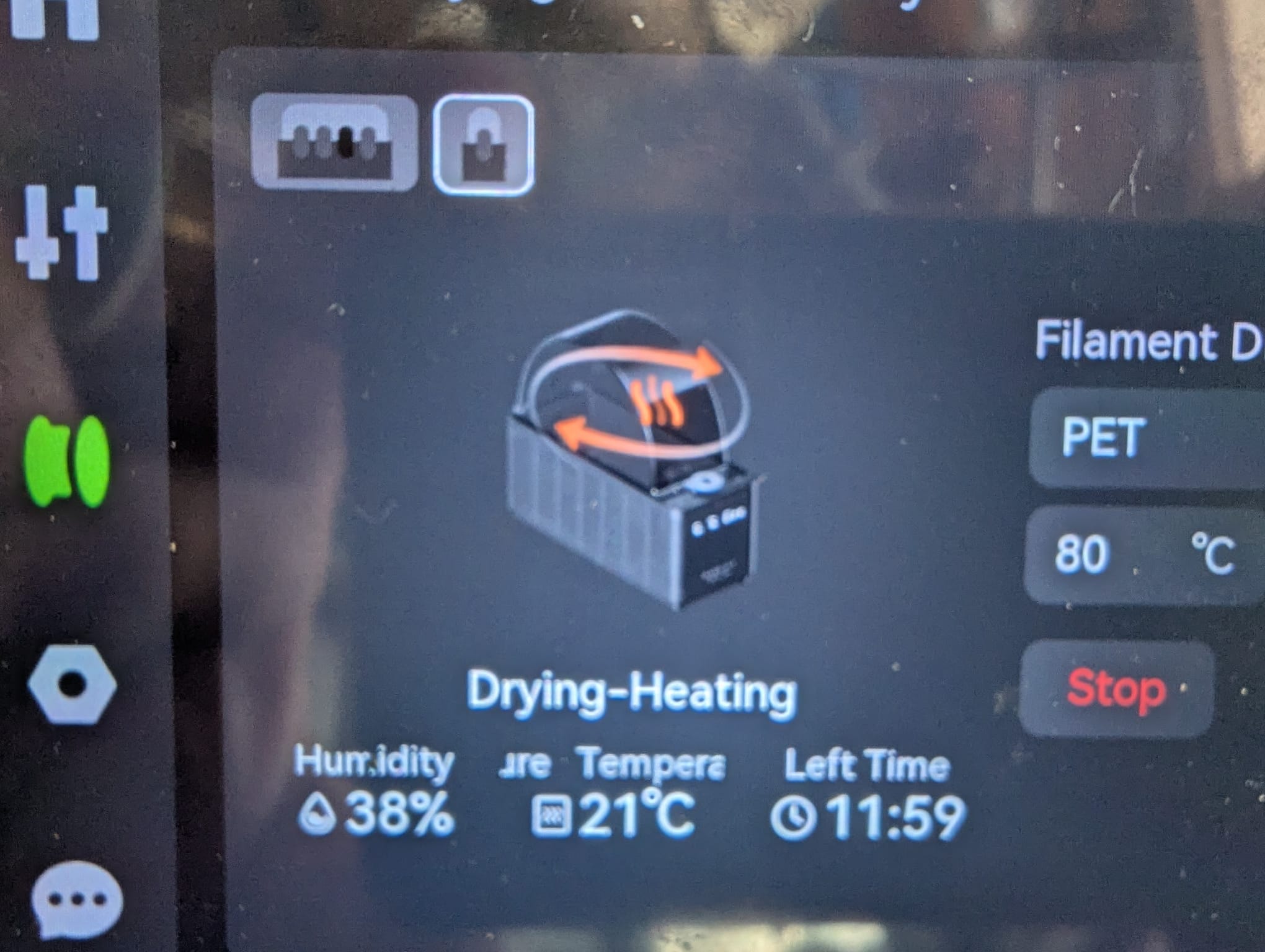

Drying the filament now so I can print it asap.
