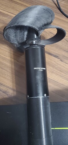

Tomorrow I will test this “monster” as a tow. Hopefully the prop will fall apart before the motor burns out.
Im running new alu versin of firmware.
New modified version is included in new vesc tool
Damn.
I would not wanna try that.
Looks dengerous.
I hopemotor will survive.
For the motor maybe. However for fingers and limbs, this long-chord MIT type blade makes it even safer than the mid-long chord MIT blade demonstrated as “safe” in this video:
'https://youtu.be/w90gM7bGdvk?t=364
The motor survived. However, traction is not enough. The use of two 6384 motors was much more effective. The towing itself failed due to the failure of the transmitter antenna at the base, which is why the control range was reduced to one meter. However, it turned out to be an effective bodydrag against a fairly strong current of the river.
