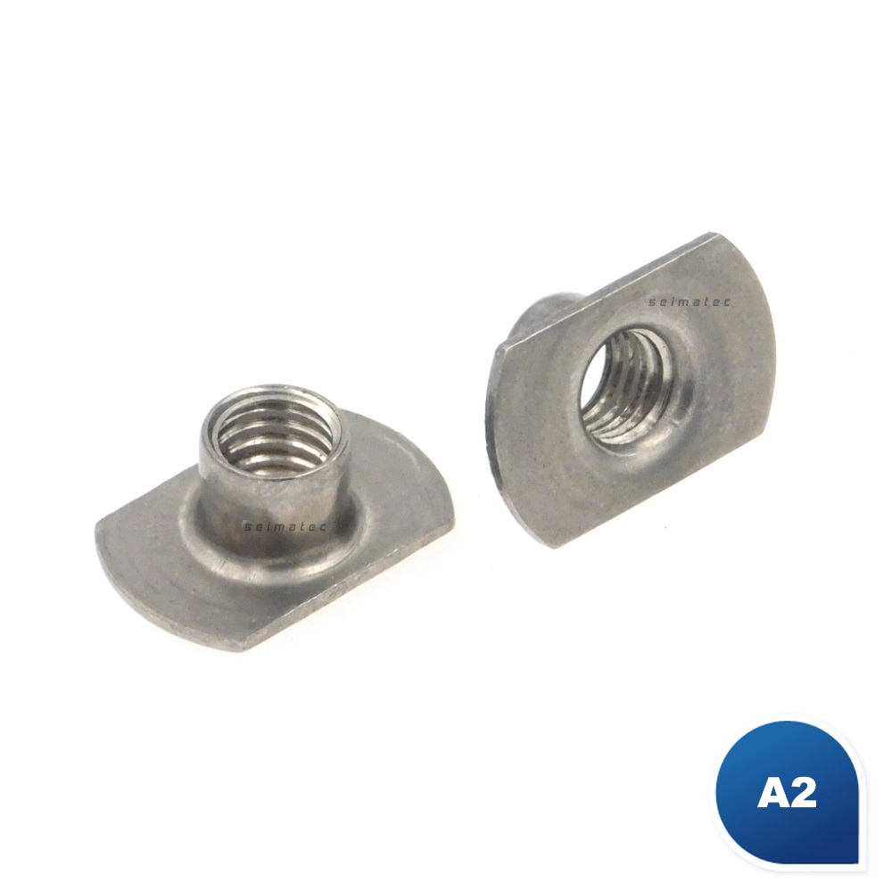

Stainless steel T-nuts with M8 threads and an overall height of 12mm. I have to close off the top, but that should be an easy task.
T-nuts have a very different use case. The inserts I posted have a 32mm base which is a much greater area and will provide more strength. You also need to make sure to us marine grade stainless steel (A4 or 316 grade) so that they do not corrode and rust.
You can try to find inserts from composite shops.
The material is A4, so that would be ok. Maybe I will find those real inserts, but I think they could be an alternative if nothing is available in my area
