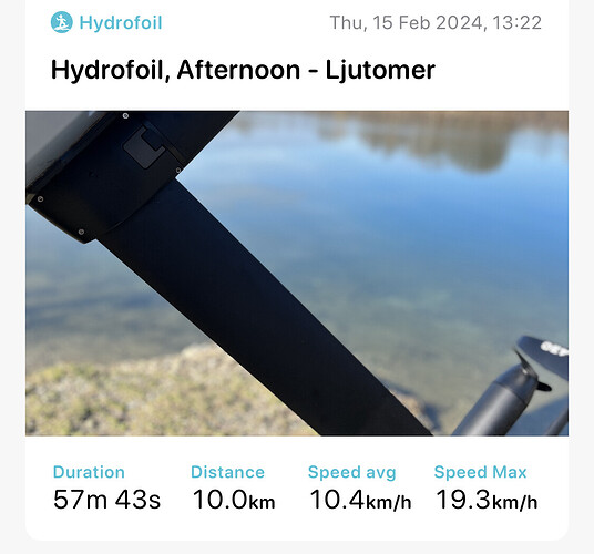

At what speed did you manage 51min. Guess it’s rather slow?
Today i will measure ewrething even max speed and awg.
If you want racing and doing high speed you must going on normal efoil.
I just want prove that you can also CRUISING with small system and for that dont need spend 8000€ pr more for regular efoil if you can buy small system and enyoj out on water :heart::heart::heart::heart:
Almoste 1h of ride but i made it 10km with 460wh batery :exploding_head::exploding_head::exploding_head::exploding_head::exploding_head::exploding_head:

More of a question of weight. With my 99cm board and 480Wh battery I’ve already ridden for half an hour in 2023. 10km distance at 20kmh average speed and 28kmh top Speed. (Topspeed Limited due Vesc, Setup could do Up to 40)

That amazing how slow you can go on that wing. I have a core 1250cm2 and can go 13km on 500wh but I am going 30kmh.Thats with flite prop and 65161.
9 kmh at lowest :handshake::handshake::handshake::pray::handshake:
