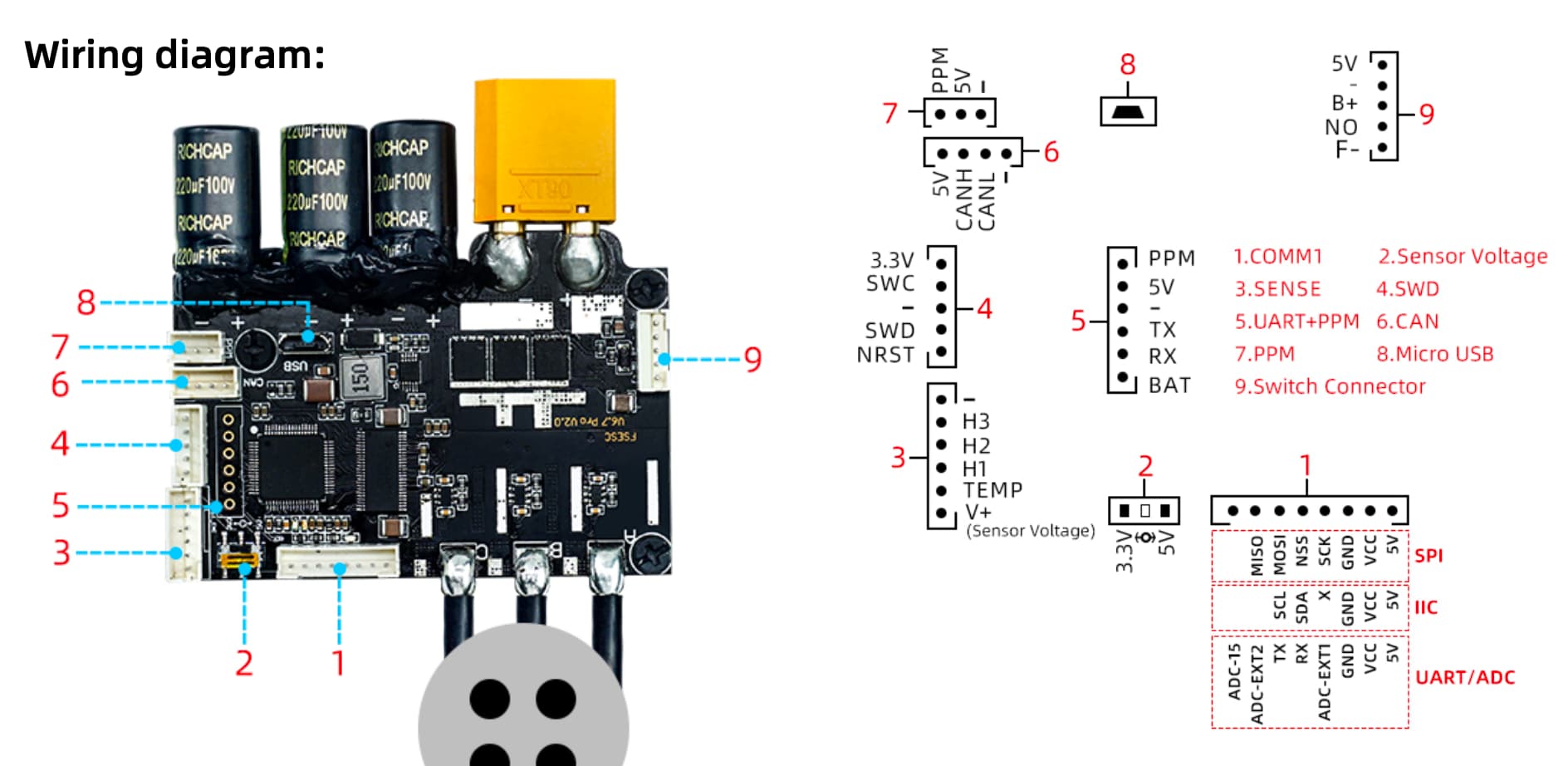

Your question is missing the type of your remote, how you have connected it,…
Thanks, sorry. My bad.
Foildrive remote V2. Paired as per foildrive video and then ran the setup input as mentioned in your video.
