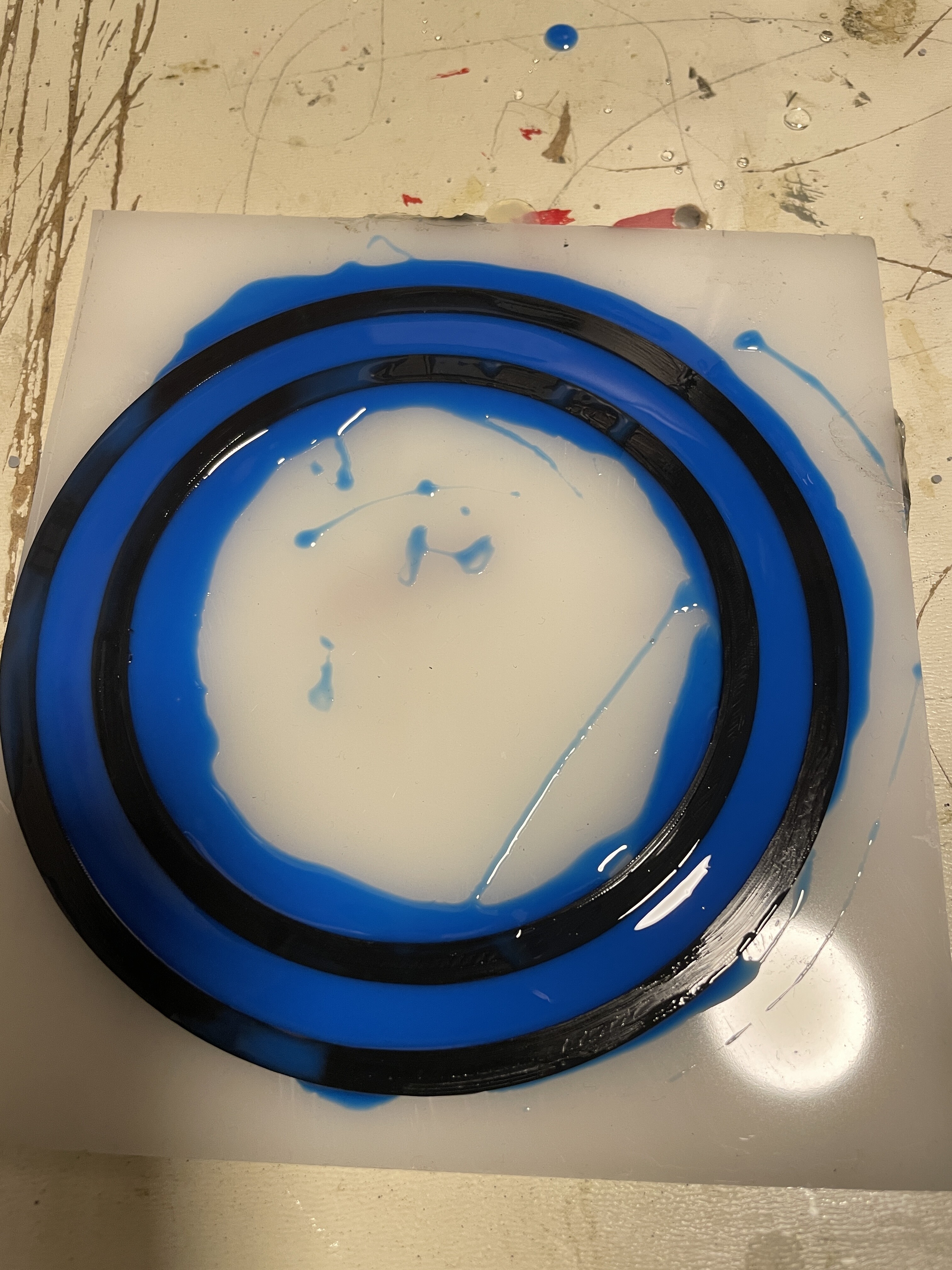

2k Wagnersil silicone. I print the sidewalls of a mold in position, leave it on the print bed and glue an acrylic board onto it.

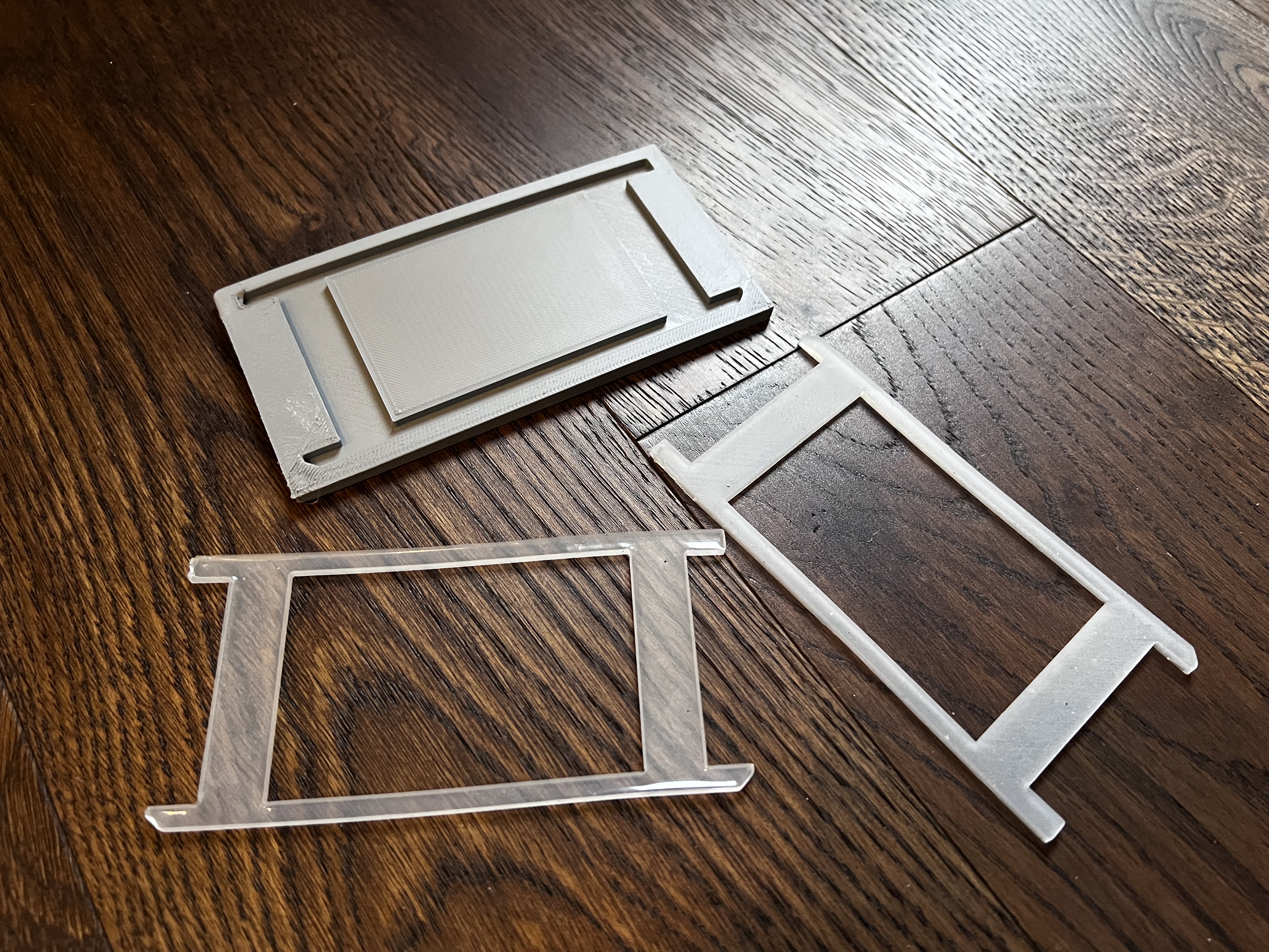

Just rounding out the thread I started. What ended up working for me was a silicone gasket made in a 3d printed mold. Fun discovery: “Ironing” turned out to be a fun practical feature for making the bottom of the mold nice a flat.

Show us some pictures please.

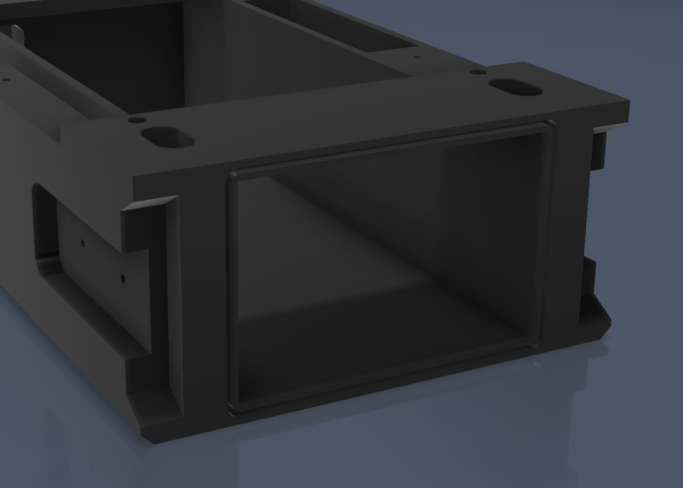

Nothing crazy but since you asked, here’s where I ended up. Showing the prototype grooves in the model too.
Ugh. Still struggling. Flat surfaces are great. Also found a good use for those channels: filling them with strands of carbon fiber. Made for very nice reinforcement and hard surfaces for the silicone gasket to push against.
Next up is: maybe combining the battery with the nose cone as a way to eliminate one variable. That way the only path of ingress would be where the gasket meets the body. Anyone else found this path as a worthy one?
Are the clear sections pictured above your gaskets ?
Yeah. It’s one of many approaches. It’s the one that passed the “sitting at the bottom of a tub for a few hours” test most reliably and repeatably. Unfortunately in actual use, the pressure from velocity causes it to fail somewhere where this relatively light static pressure test doesn’t reveal.
Is the main body ali ? or something that can flex ? Your gasket setup looks the opposite of how FD do it groove on the body and lip on the cone.

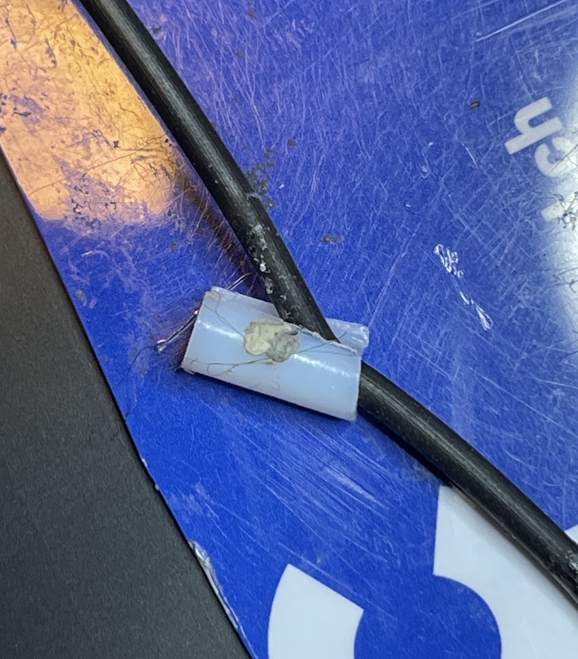

Interesting. How to you close the “loop” ?
Super Glue and I put the joint at the VESC end that is filled with magic gel
You can glue a custom lenght O-ring from nitrile rubber with superglue. I use a ptfe tube for 3d printers to allign the ends.
