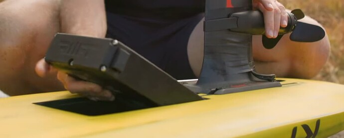

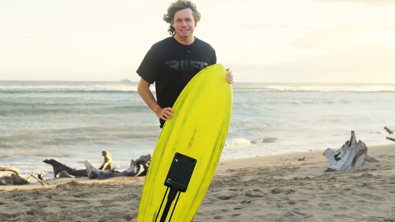

For those that haven’t seen yet, here are some links to a very slick system from Riift:
It looks well designed and in theory a much better option than FD
But considering FD already exists and there are plenty trench boards on the market now, what is the advantage of this system?
Less effort to change the batteries? Weight?
In Riift’s case, anyone that hasn’t entered the market yet they would most likely get the win as it does look more efficient and simple to use.
If I had a FD and a trench board I can’t imagine moving across as thats a massive investment to switch.

Rift solution looks good but will be so expensive I believe.
To make it work you will need to buy all the electronics + find a local shaper who is willing to remove the tracks from your brand new board to put this box in.
Lots of labor and risk to do so. What about connectivity??
It looks like the ESC is in the battery box, which means that when you are buying a spare battery, you are also buying a spare ESC — again, a very expensive solution.

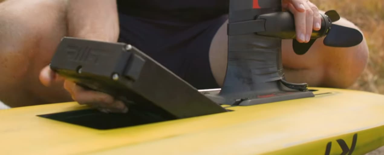

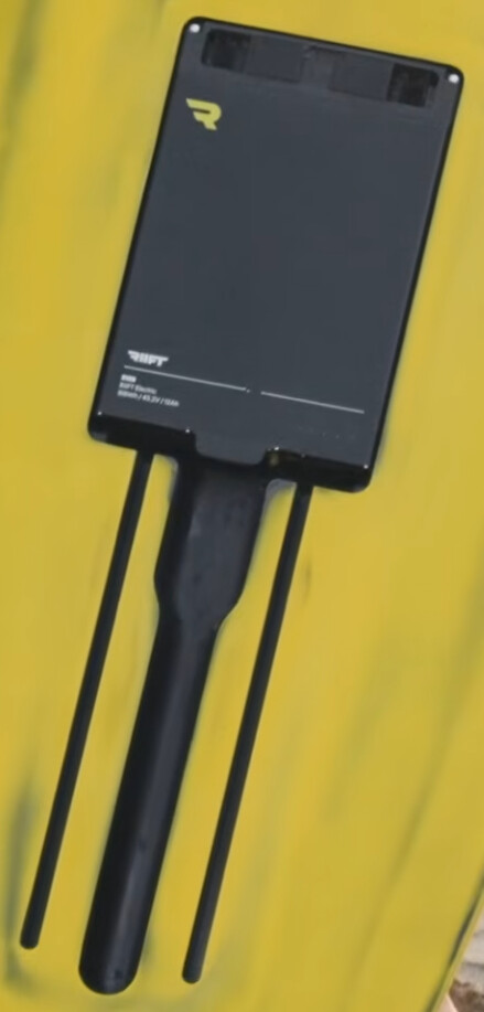

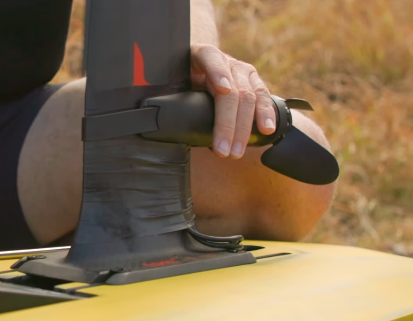

The pod doesn’t looks really good:
Cable going to the motor same…
Overall it does look better than FD, but at what price for the whole thing ready to go? At least FD has a good warranty.

I’m not quite sure why it would be. If the track system is well designed, it should be like $200 or so bare. Then the electronics aren’t particularly complex. Even if they stack a remote and receiver in every battery the realistic cost is only $150 more. But I imagine the ESC and RX is somewhere else like in the slot under the mast where you can guarantee a signal path. This system would make DIY in a board so simple for all DIY guys that want an in-board solution.

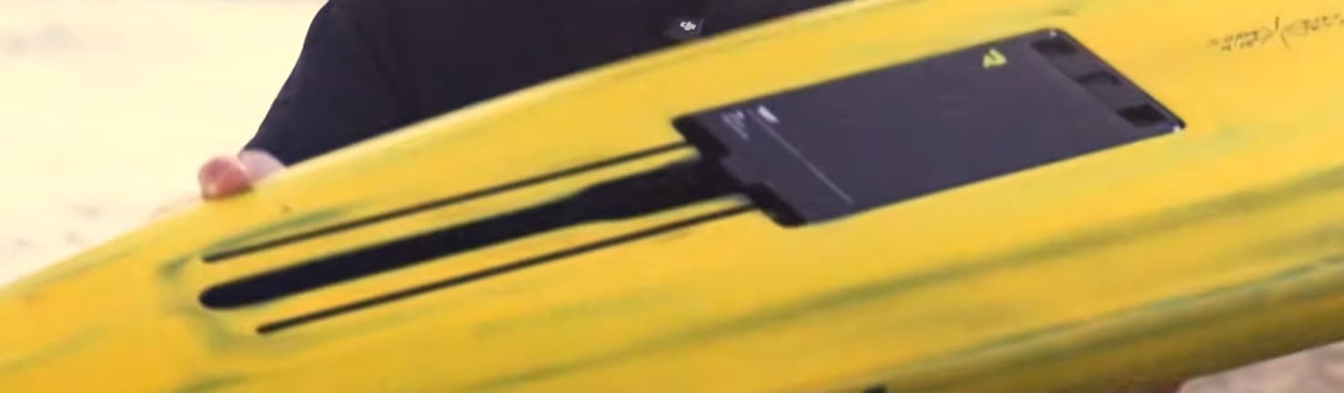

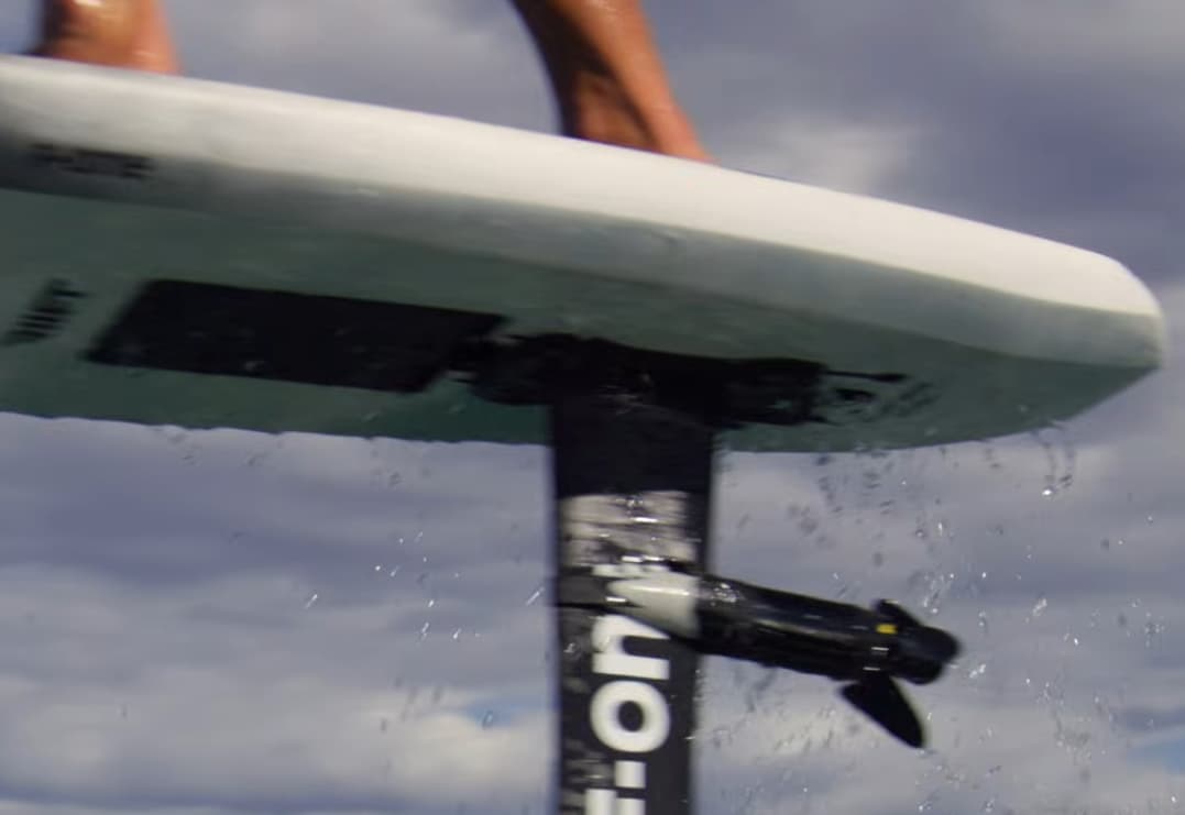

I wonder how much of an impact on ride feel does the system have considering the weight of the batteries are in front of the mast, VS FD where it is centered on the mast. I rememeber on FD gen 1 style setups, the weight of the battery up front of the board made it almost impossible to really pump.
Isn’t over centre of lift better. I’m running 3p over the lift on my apple tree and your barely notice it when your on a wave. 2p is easier to pump but that’s just the weight I assume
From speaking to some manufacturers, most modern foils place their COG around 130mm in front of mast. This means that FD’s COG is actually too far back.
The RIIFT system actually looks like it improves that distribution.
With the Gen1 right on the nose, then pumping was a tricky business, but move it between the feet on the rail and its a walk in the park.

They have different size batteries. Right now judging from the size of the cutouts they may be able to run up to 14s4p. Whether they’ll bother with a pack that big I don’t know as it crosses over into full efoil territory.
The beauty of their system is that it makes it super easy to custom build a unit to your own exact specs which then makes electronic replacement simple and cheap. It’s where foil drive failed. They made it impossible to replace an ESC or upgrade and instead your stuck with an entire new base unit cost. They are releasing a new version of the max (supposedly a v2.5) at AWSI so let’s see what they’ve changed…
