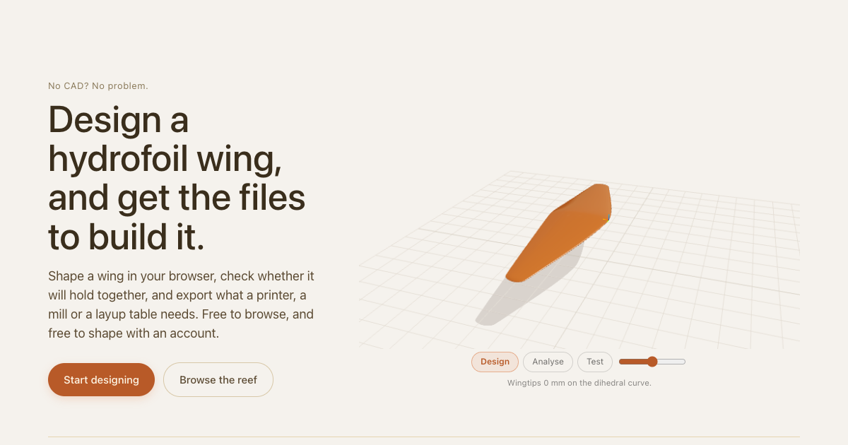

It would be interesting to know what airfoil section.s is/are used, locate washouts (twists), model it using a parametric wing design software/app like Winghopper (thanks @ZachMoves ), export to XFLR5, …analyse/think/predict, … start again, …
'WingHopper.com - Free Wing Design Web App!
