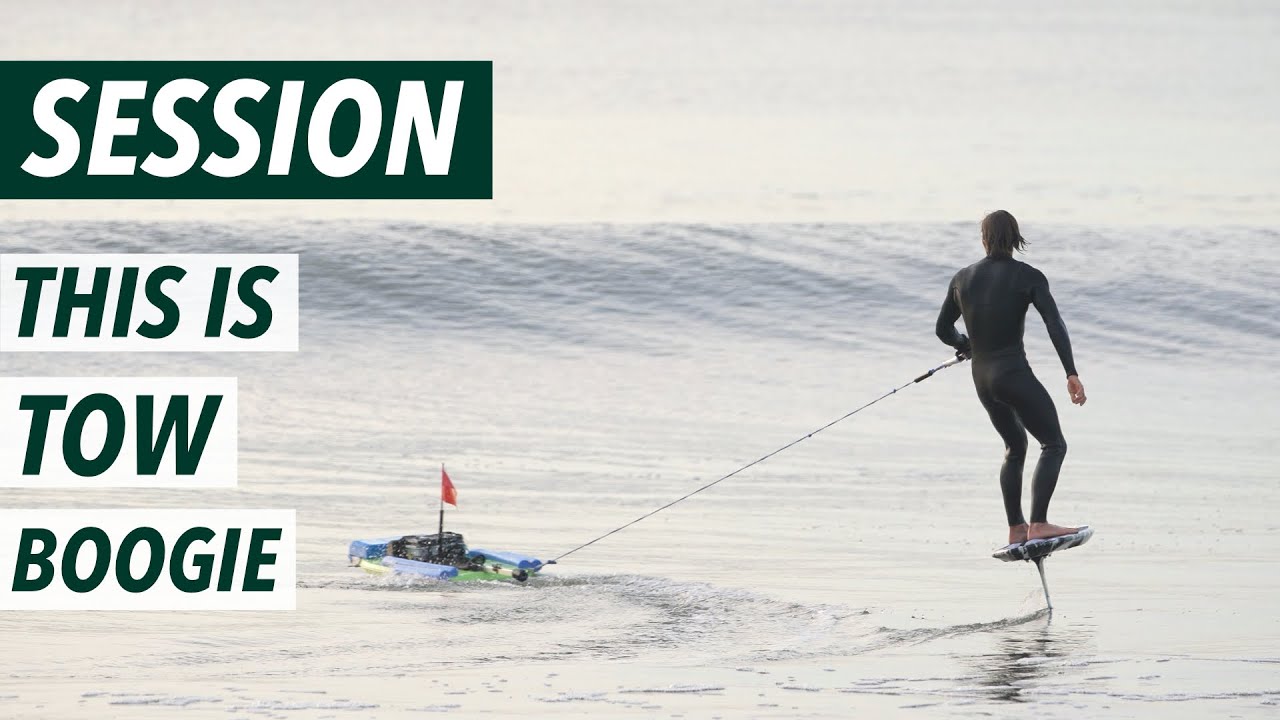

Hi Everyone,
My name is Hadou. I live and foil in france, south of Britany.
I’ve been riding DIY foil assist and official foildrives gen2 for more Thant 1/1,5 years now and finally got into the tow boogie fever recently !
I do lots of gear reviews on Youtube and the assist has been a game changer for all the boards and Foil tests.
Here is my first Tow. I call him “Tori-Tow V1”. Because a V2 is already in the work
In short.
I’m on a 4 batteries Setup 4X 6S2P (Samsung 50S)
1 Single Saite 6384 motor
1 Sequre 12200 ESC
Maytech classic remote and receiver.
48 inches Boogie board.
Kite foil Twintip fin under to counter the motor couple effect
Floating pole to straighten the outline of the bodyboard on the tail.
I used a Camdenboss larger than the one we use on the DIY F-Assist.
I use a Waterblock for ESC cooling. It’s doing a great job.
Added a few EVA blocks to get more float ability on the front in choppy and windy conditions.
Total Weight is 10,2 KG
Here is the beast. I will release a video this week to show you how it works.
Enjoy !

One first video where you can see the tow.
Here, I was just showing my way of taking off to my friends :
Continuing the discussion from Hadou Tow Boogie "Tori-Tow V1" Build:
Here is my First video with this Tow !
Enjoy !

Thanks for posting all the build information. It looks like a very effective boogie.
With your 4 x 6s2p packs. How do you configure them for a session? Do you connect to give 12s4p overall? If so, how long a surf session does that give you?
Thanks,
James
Amazing Hadou!!! As usual! Thanks for your reviews. I guess you are preparing a new video Tuto to explain how to make it DIY :grin: and share component sourcing? What is the propeller model for example? Cheers
Hi James ! Right ! I pair them as a 12S4P

Great you can do this on a single 6384 motor and 200A ESC! What prop have you got on there? and do you know what RPM you’re using during starts?

I don’t know for the RPM. every time I’m on a build, I’m lazy and only solder the wire to get the battery indicator on the remote :joy: I don’t have the RPM. But yeah , the 6384 works awesome even with a current max protection set to 50 amp for me mainly riding AFS 850 silk and Enduro 900/700 at the moment. I weight 62kg but don’t need all the power it gives.

Thanks for the response. I also have a dual motor boogie based on @Jesserosco build, it’s so much fun, but looking at something to replace my 3D printed props because they are fine in clean water but keep breaking when running into debris, even seaweed breaks them. Keen to know which prop you use because it must have some good power to pull you up on one motor at <50A!
Hi.
I’m using the BL HEli version.
