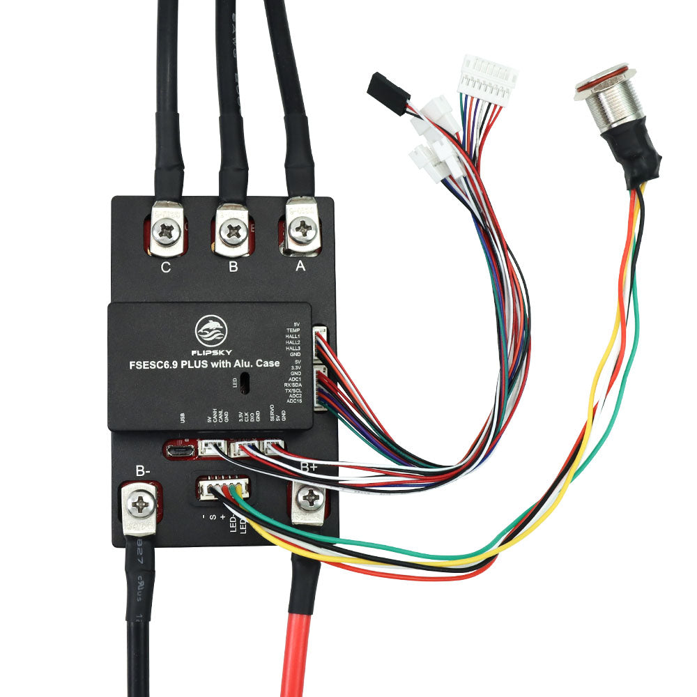

The batteries are not in the picture, I use one or two 10S4P Scooter battery packs, fully enclosed and waterproof I offset them to the side to help with motors torque. I like 10S configuration as the AMPS are lower with higher voltages. Also the motor spins faster so I use lower KV / RPM motors. Grunt straps secure them.
The motor is Flipsky 7070 110KV and used a VESC 6.9 with power button. The remote is also Flipsky, I like them because the Vesc has UART connection to the Remote Trasmitter and the remote tells me AMS and battery percentage.
