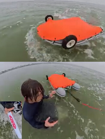

Will do currently I only have this: https://photos.app.goo.gl/Z8CqCCB1DNL5rKZx8 this is my 10 years old son (35kgs). :slight_smile:
FYI I move my tow bar below the boogie and now it stays in the water and I manage a couple of takeoff with a 38l board and 1000cm2 foil (my self being 88kg baked). Only remaining trouble is that when I accelerate I have some hickups (engine seems to stop for 1s and restart straight away) when I reach around 50% don’t happen every time but maybe 8 out of 10 starts. Suspecting some esc parameters like motor timing or demag compensation may help but not sure. Any feedback of course welcome.

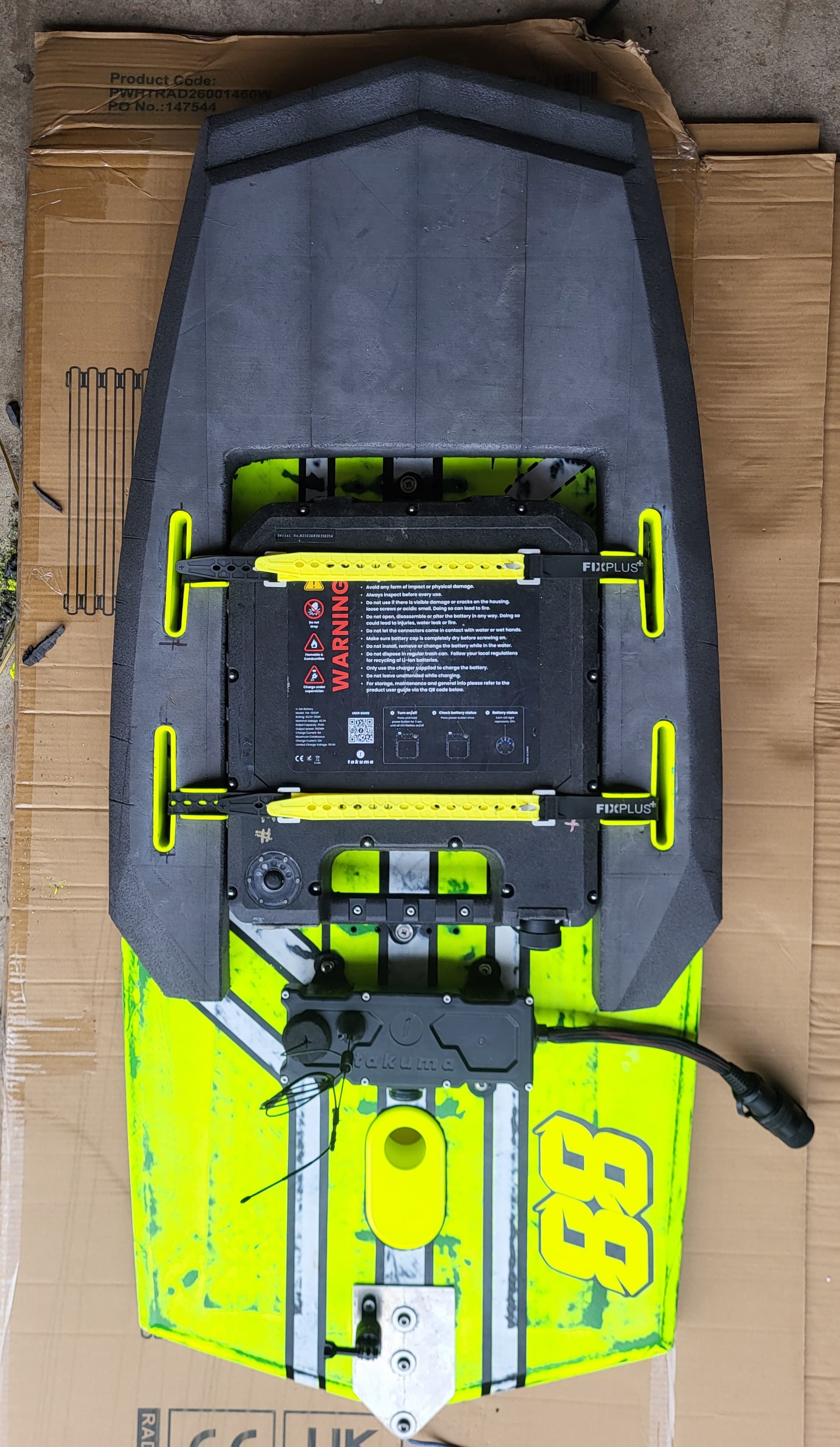

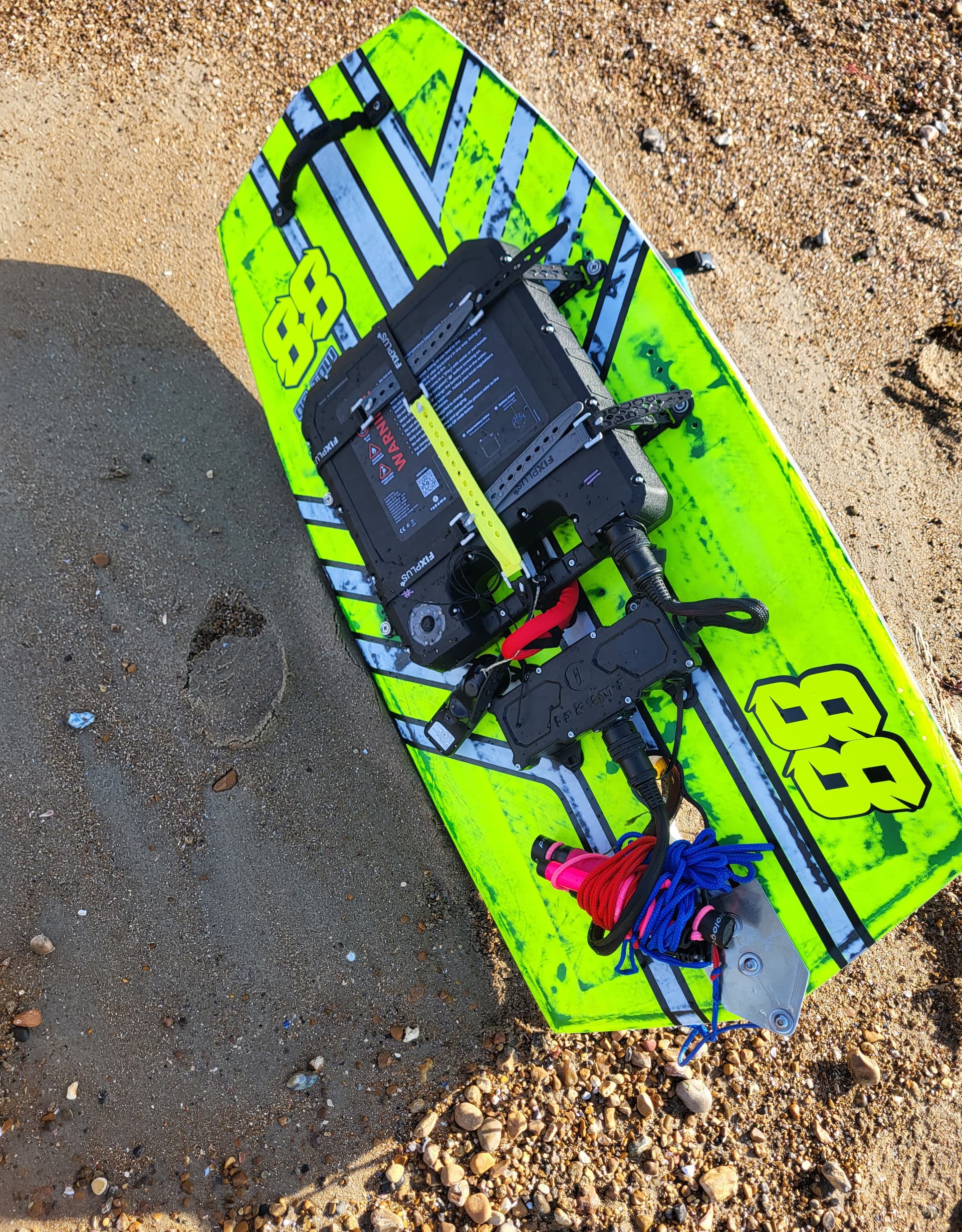

I have now got my tow boogie working. It is excellent, I had it in overhead waves with Silk 850 and 32 litre prone board and it was perfect. I’m amazed at the value of this for riding waves. I will write up at some stage, but for reference.
  • 12S4P, Aliexpress 6384 motor, Sequre 12200 ESC, Flipsky vx3 pro
  • 45" Boogie, decathlon surfboard fin, foam, PVC pipes, trim tab
  • Camdenboss, passive external ESC cooling plate.
  • Cut axis mast, 3d print mount, propeller king 2 blade
On full voltage there is lots of power for takeoff, but requires good technique, at low voltage the technique needs to be perfect and very difficult. I will probably upgrade to 3 blade propeller, double motors, follow mode and a number of improvements. For a beginner you can run the setup I have and ride a big board and foil with no issues.

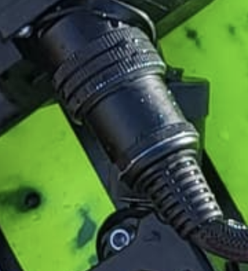

Btw, would it be possible to now the name of the cable gland/connector you have used in the built:
Screenshot 2025-05-19 at 08.20.32
@volna … this is part of the Takuma ESC that in using which i dont think you can buy unfortunately. However, check out @hangloose as he has alot of excellent solutions for this and puts them on his printables account. Look at the LMT6 connector he designed: that is similar and has beend uses by quite a few builds on here. When i upgrade this to a dual.motor setup i will use those i reckon.
