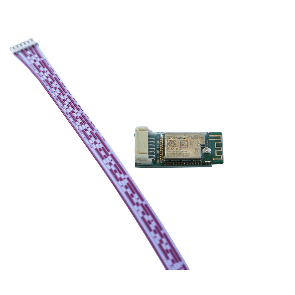

Most convenient but not cheapest solution would be a metr pro dongle plus your mobile near it (in the board or on you). If it is just for logging (no fancy app and sharing data online), a chinese bt module connected to the mobile vesc app would be the cheapest. You need to enable logging in the app and carry the phone with you.
BT module: US $21.00 51% Off | Flipsky Wireless Bluetooth Module 2.4G for VESCandVESC Electric Skateboard Based upon the nrf51_vesc project Flipsky
https://a.aliexpress.com/_mONjYnO
(You mitght need to change the connector)
