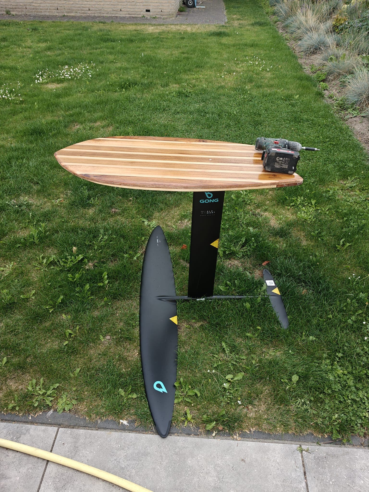

I’m looking to create a add on assist to help me get into pumping. I’ve started pumping on my gong trail v3 1900cm2 and a custom teak board 2 months ago. I might switch to a better learning foil in spring to learn faster. It’s probably too big with the assist anyway.

Board is heavy but only the deck is teak, it’s about 3,5 kg 95cm. I’m 87kg.
