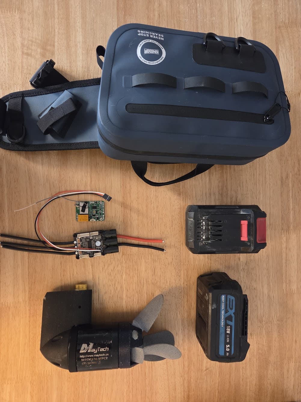

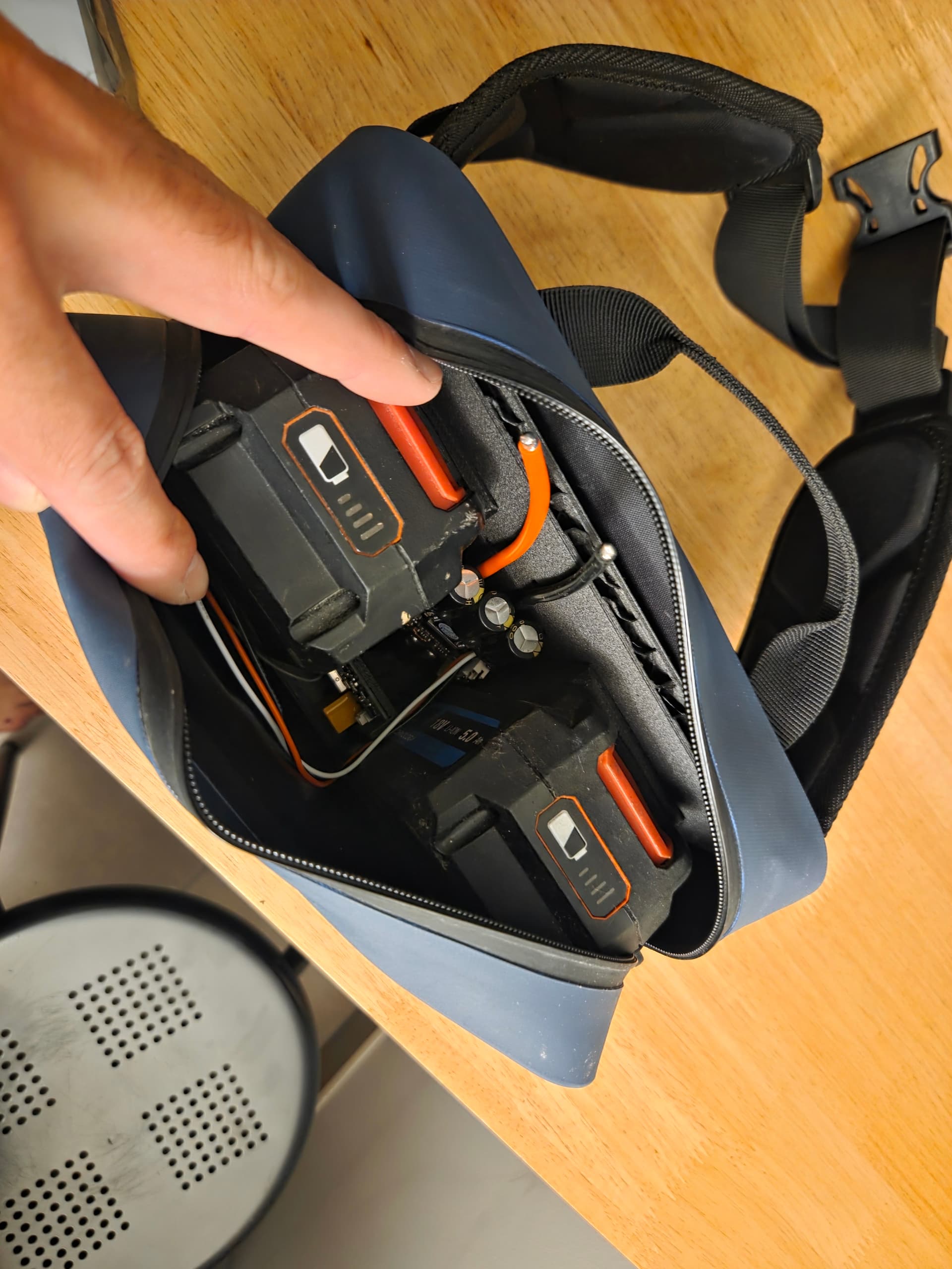

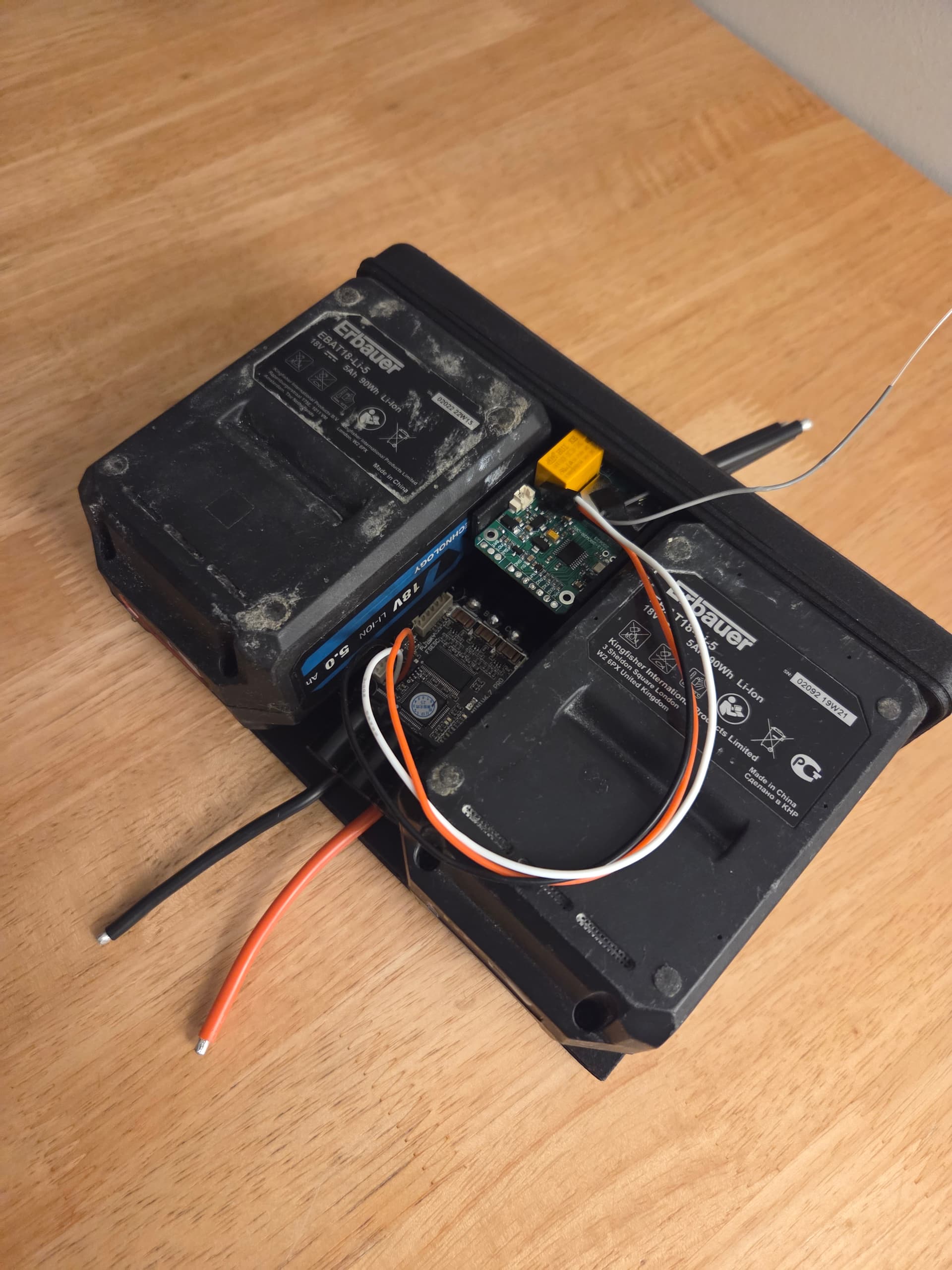

The simple/backup plan for flying to morocco holiday this winter, 5S2P Batteries I already have and adapters in a waterproof waist bag I already have.
I will make a fake battery adapter to plug a cable extension from the bag to the existing assist system. Main issue is to route the power cable in a way that it will not be chewed by the prop easily.

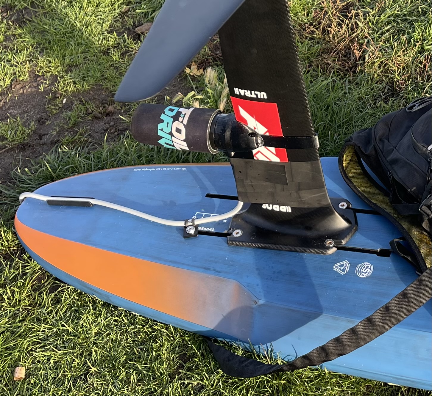

This is how I secure the cable to the board using a cable holder secured to the rear of the track. I saw a picture of this idea on the duotone and boost version.

This is pretty simple, but I dont know how well I can expect the bag seal to hold under crash or wipeout situations. One of the ideas is to be able to use a silicon tupperware lid as extra safety, going over the whole assembly inside the bag.

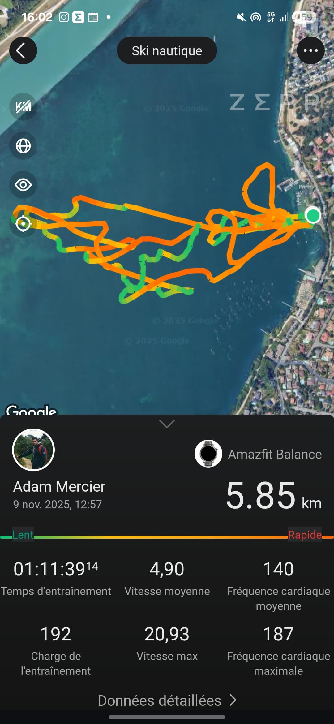

High tide sunrise session
