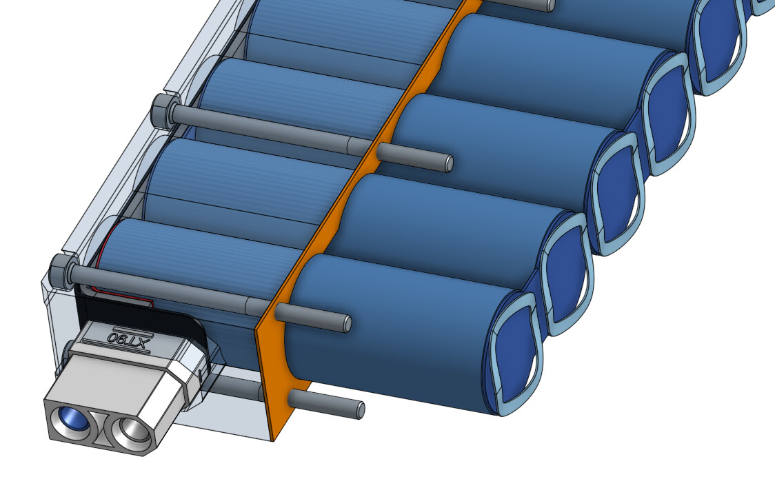

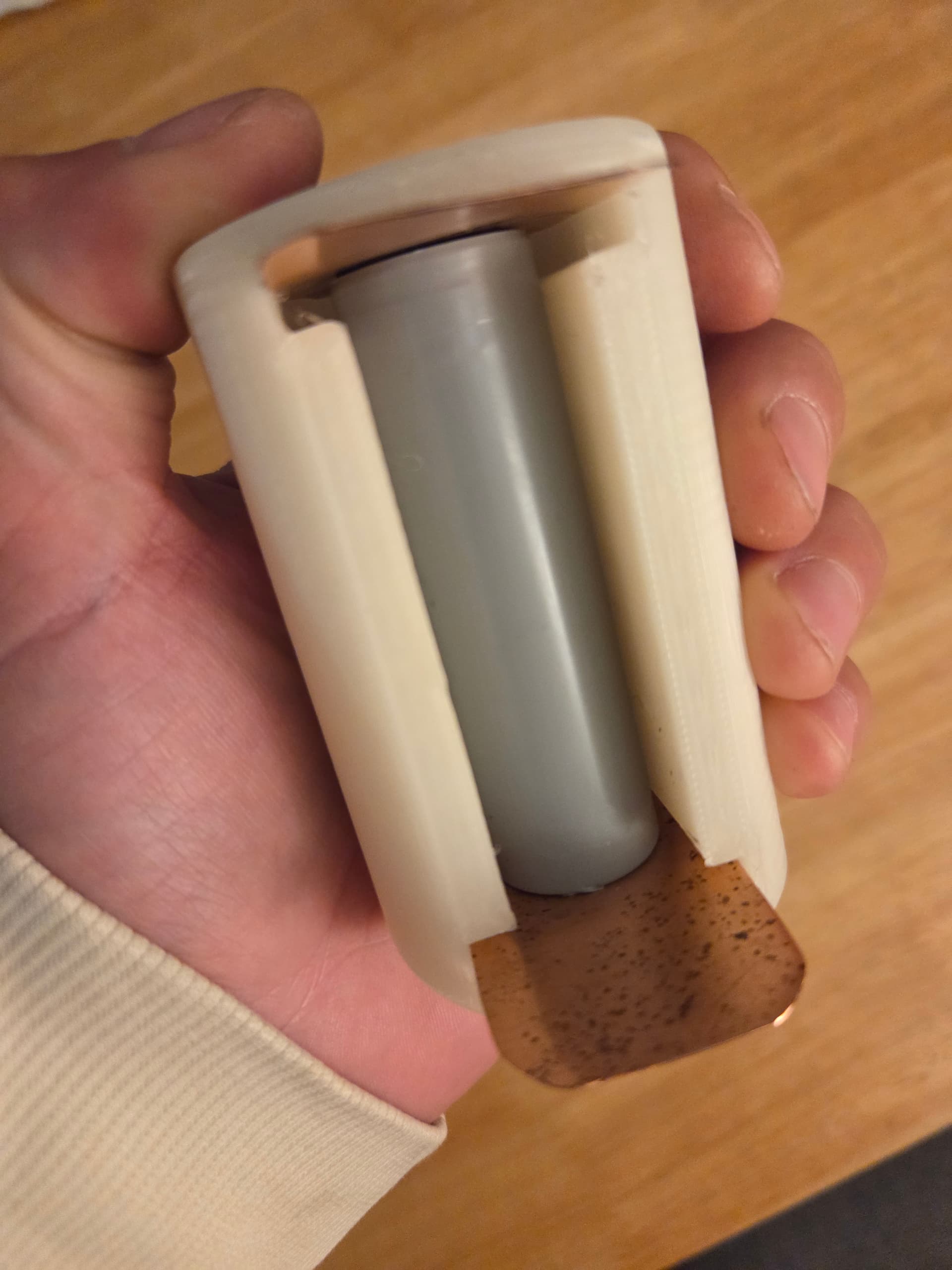

but dissassembling to recharge each session will be painful. Maybe balance wires to contact springs can be slotted into a channel in the poly layer?

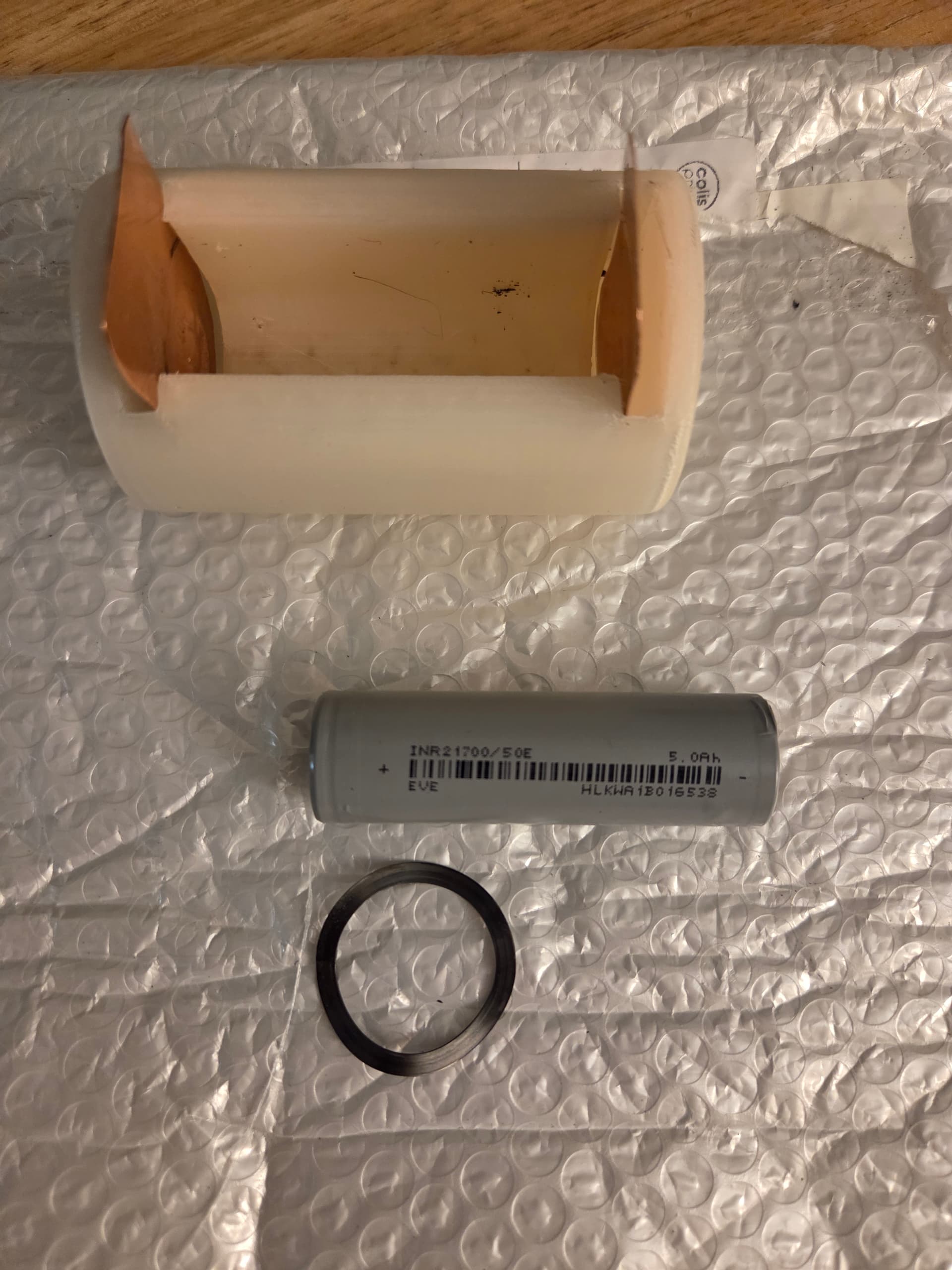

Assembled :
Free resting :

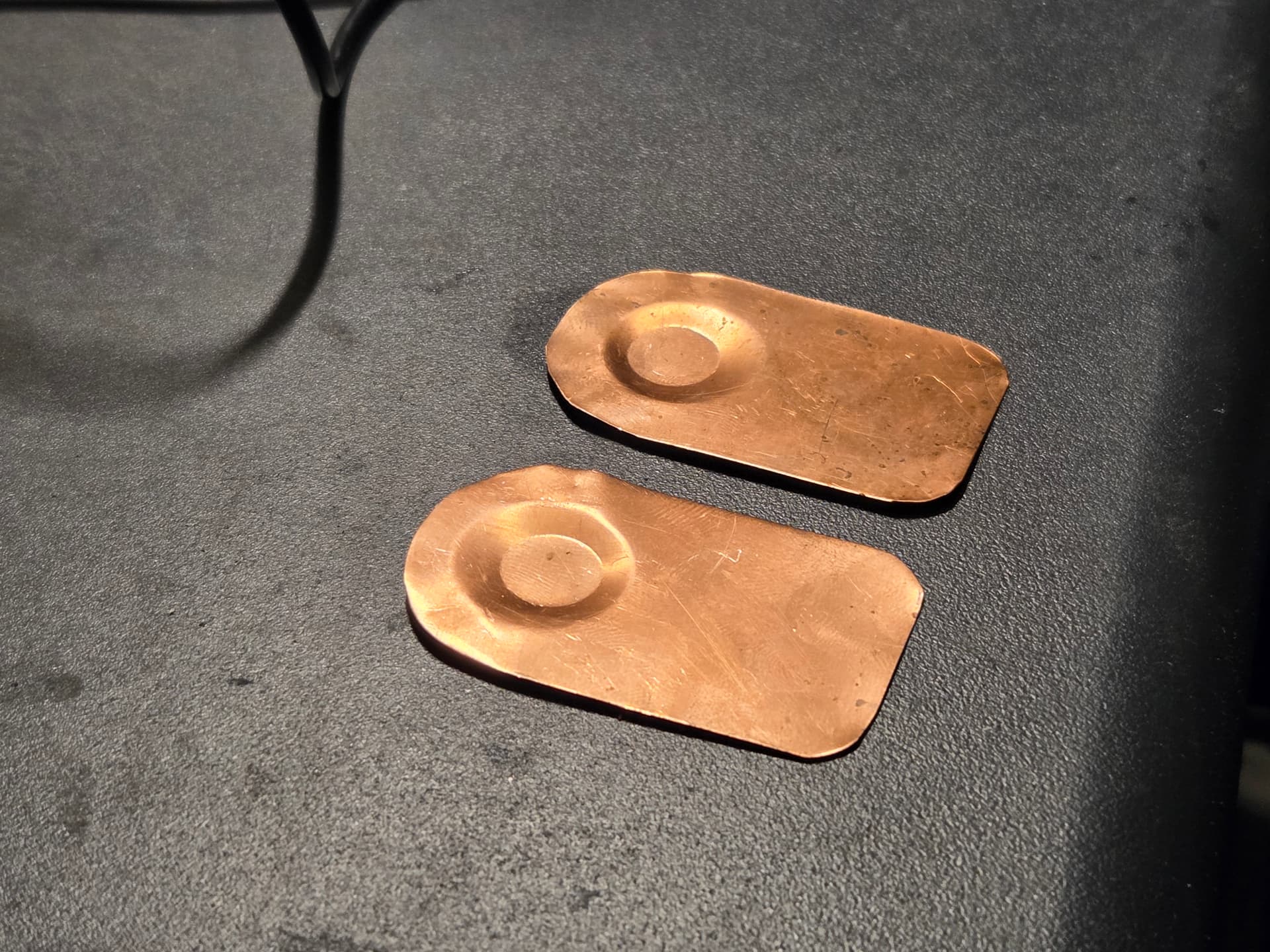

Current plan is wave washers, only on the side where the connections are simple serial bars, and dimples in the copper strip on each cell positive terminals;
With available space, the washer gets compressed by 1.25mm
Ordered the washers, paper insulators and calculated the pressure contact, seems workable.
I have already some copper sheet 0.5mm in stock, and will be easy to create a 1S test rig. Then I have micro ohm meter and 20A cell discharge tester to check how it goes.
Epic side quest unlocked

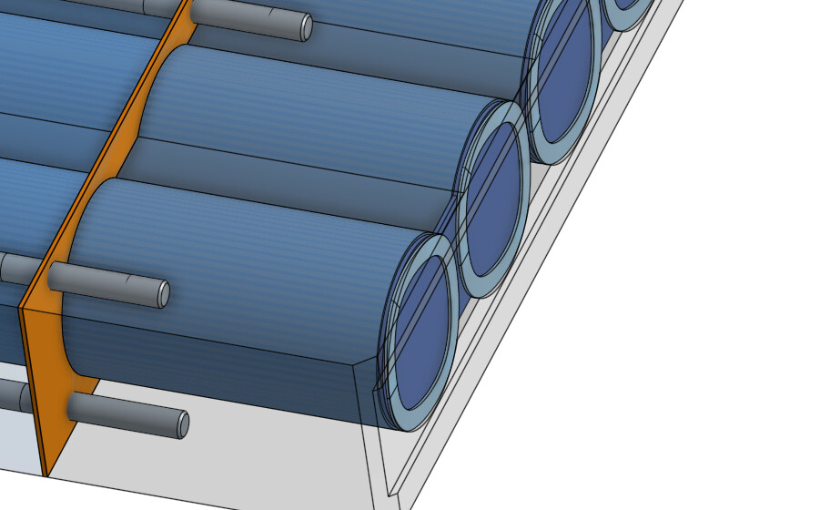

In this configuration you could push the batteries into the enclosure and apply a clamping force at the end to get good pressure on the contacts. Slightly different size but …

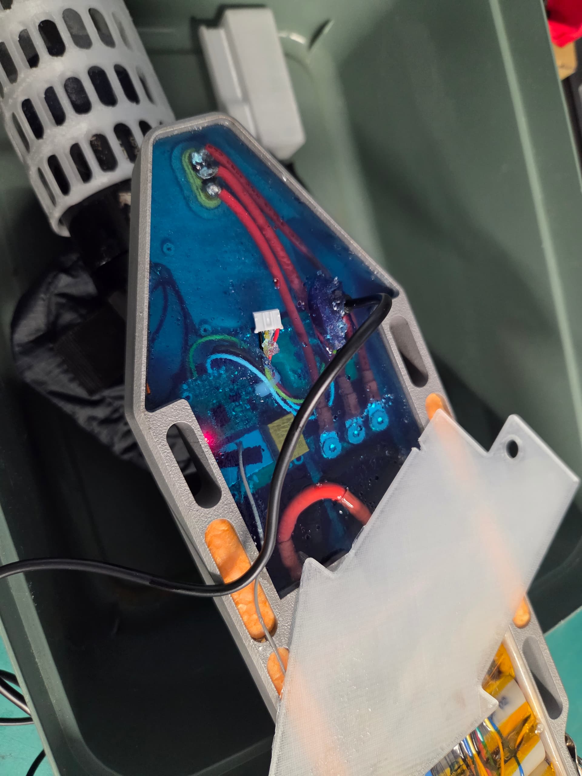

Parameter change in open heart surgery trought magic gel, 165A motor and 250A abs peak

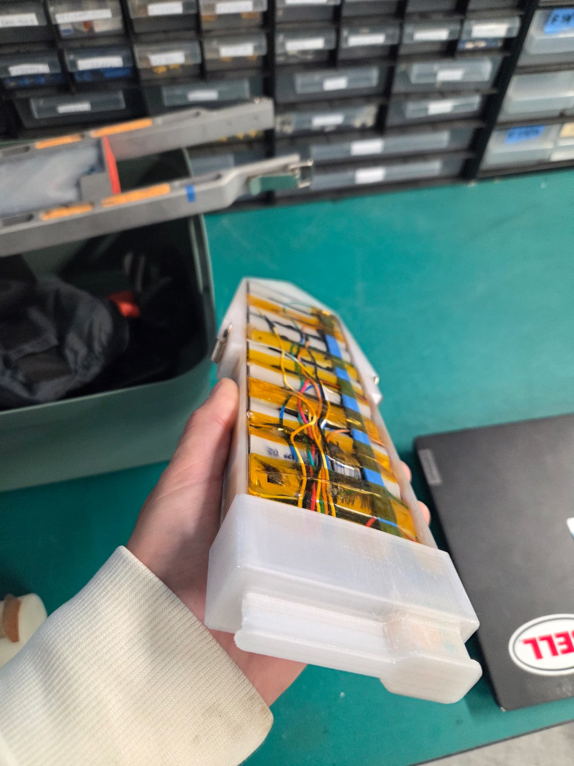

Battery cover for transport

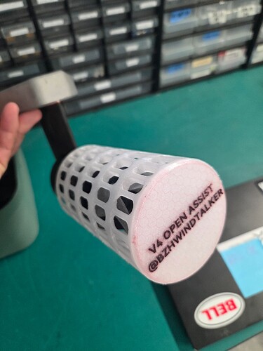

Prop cover for transport
