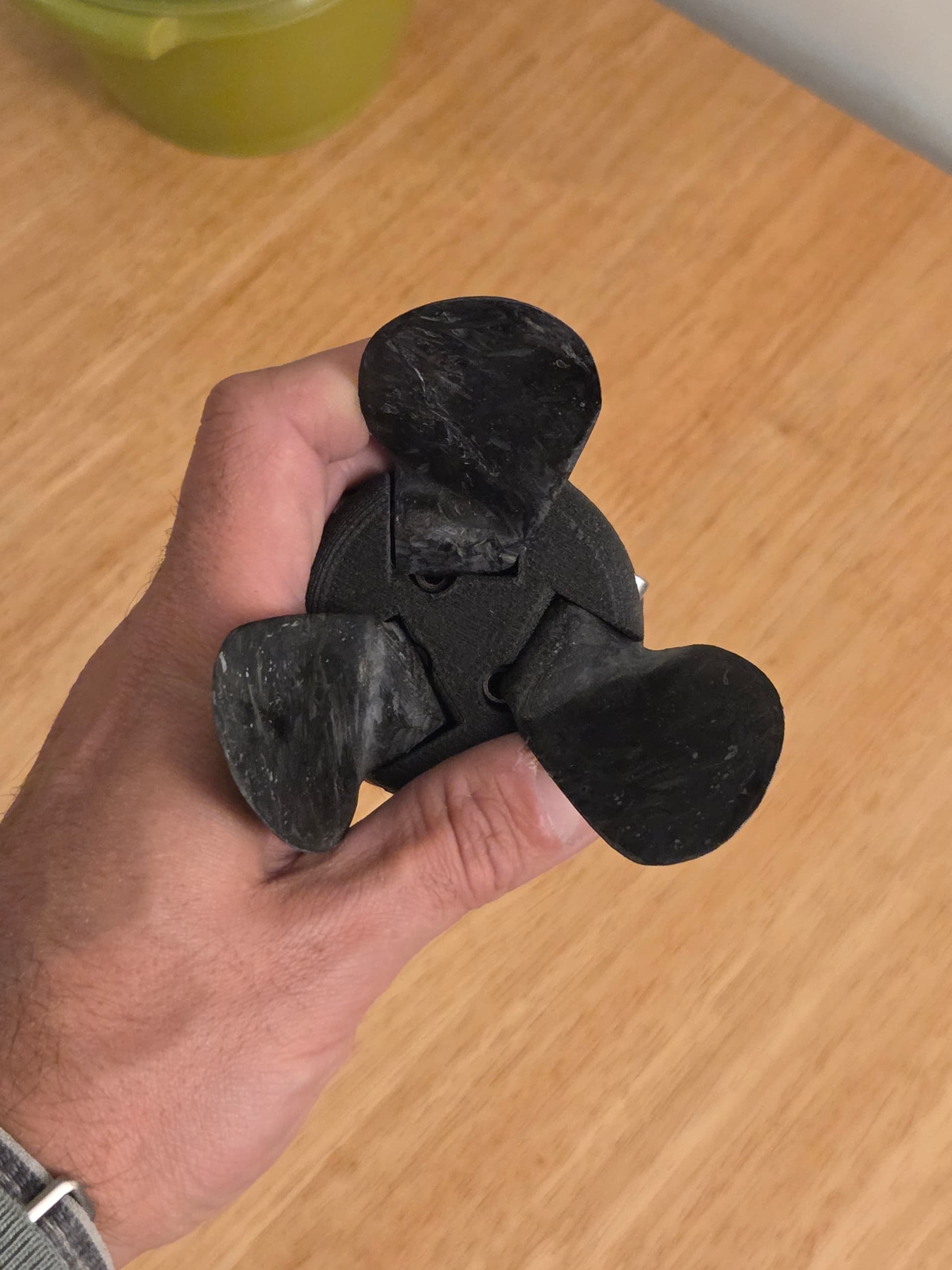

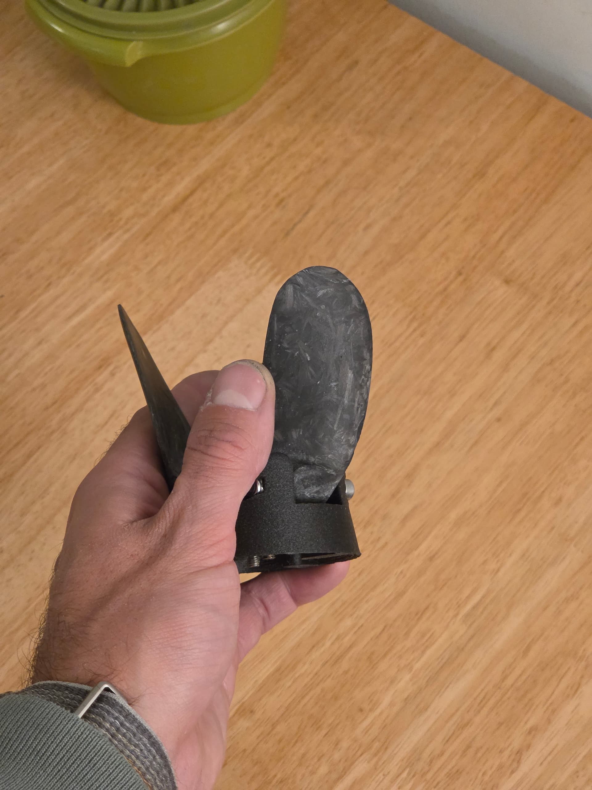

Forged blades here we go again :
Weight after initial sanding 9.6, 10.1, 10.4 gr
Some surface imperfections, and the fiber did not fully form around the screw hole, making a weak point in the part at the worst place.
I think that is more a problem of process than mold. I should have taken even more care into pushing the fibers around the 4mm rod during fiber loading.
Leave the rod out and 3D print a drill jig. That way you will get a perfect section to drill.

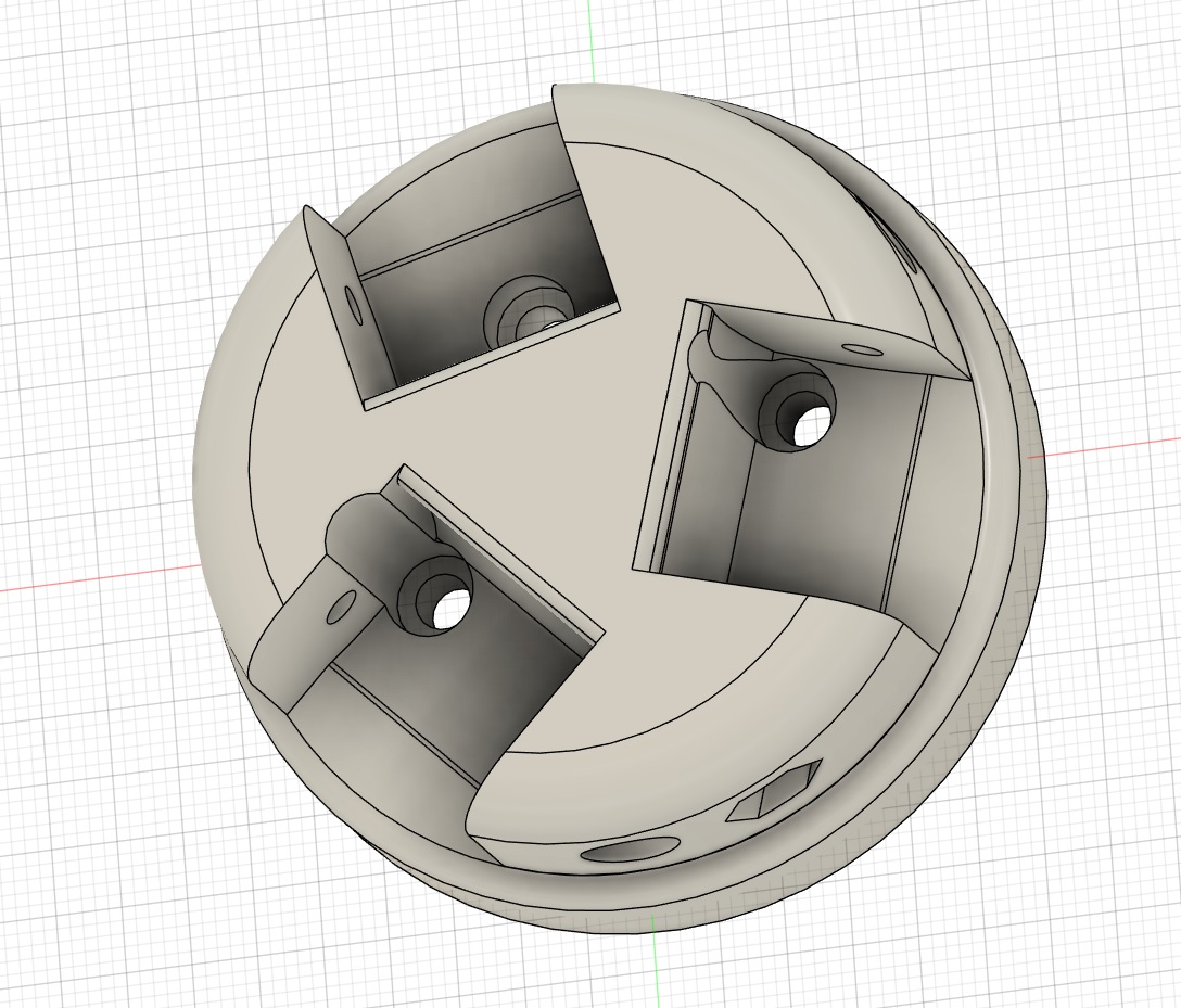

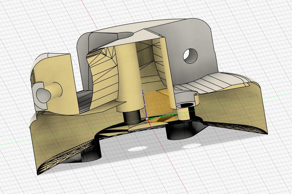

If this hub is the same as the one in the photo, I downloaded it too and found it to be quite odd, with lots of artifacts within the model. So I completely rebuilt it. It’s not perfect, but it works. The PPA-CF blades also work on 12S.
I made it! I’m not a professional though. I uploaded a v2, where I basically removed the negative step to the blades.
Yours looks way cleaner :slight_smile:

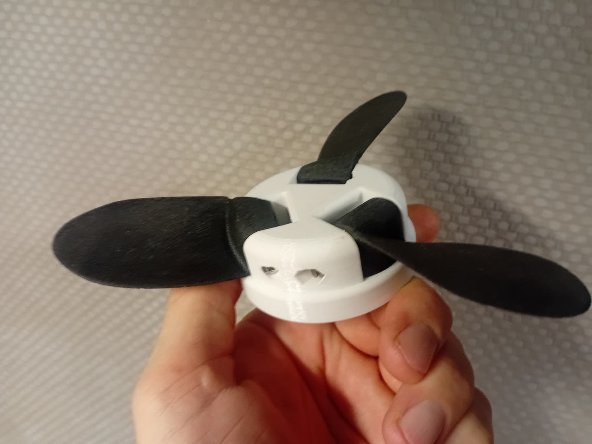

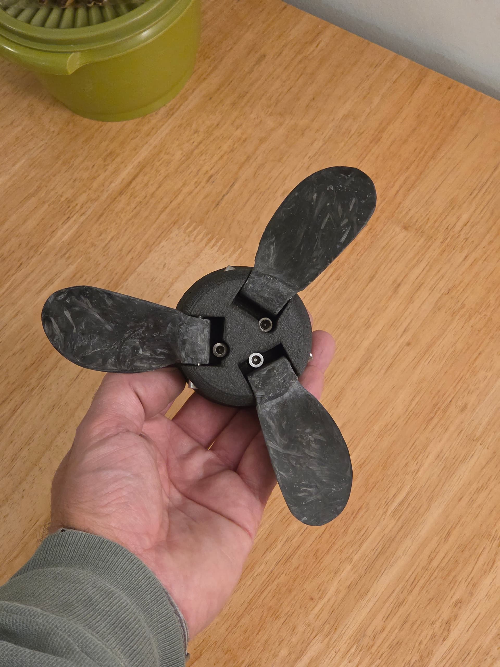

I printed V2 and will test assemble with the blades
The blade root was a little wide, had to sand them down on each side. The blades do to fully fold, is it also the case on your tests?
I haven’t had the time to do it yet. I also have this problem with my Alu blades, when I tighten the screws too much. The ones for the blades and the ones that connect the hub to the motor

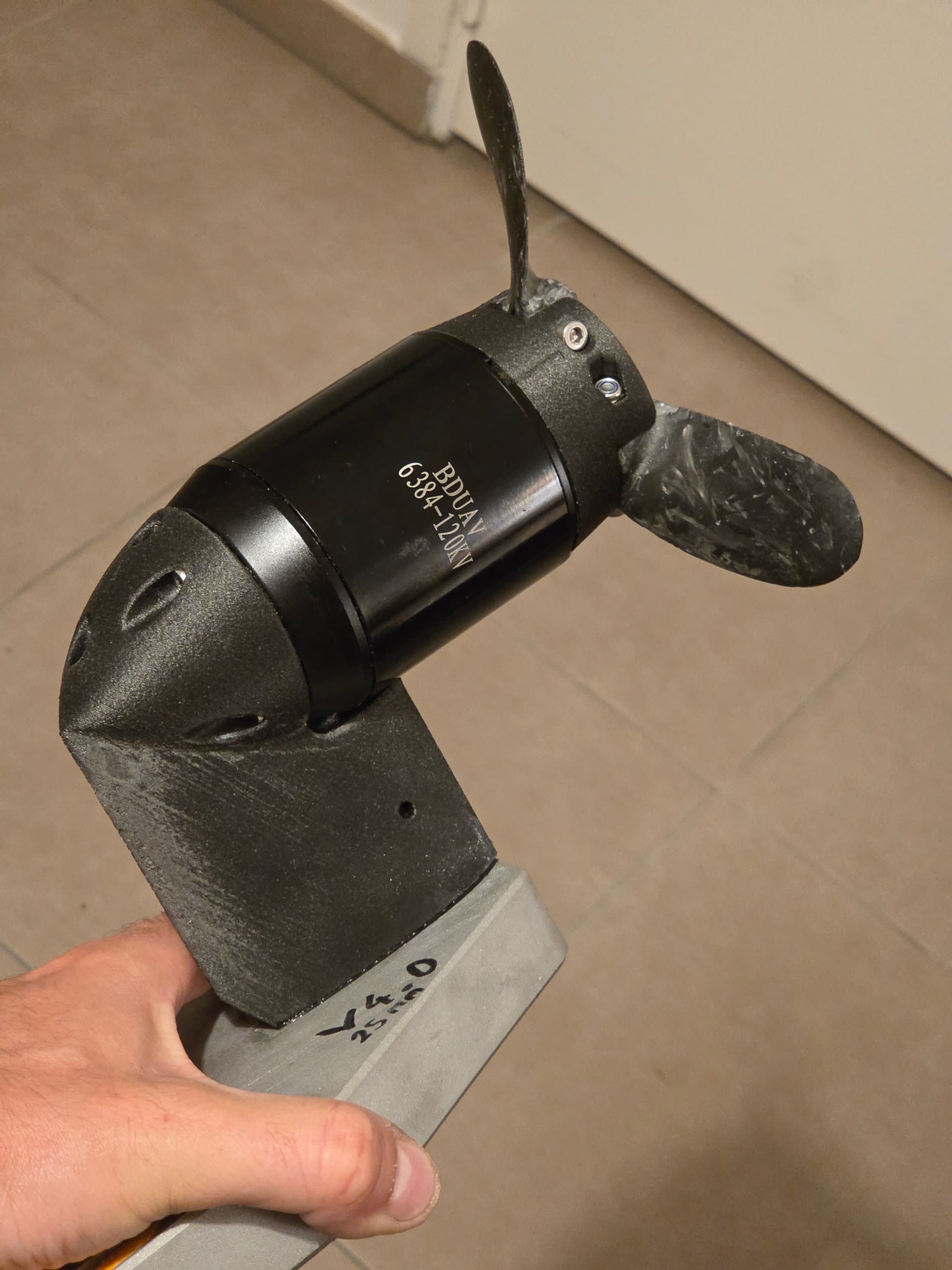

Will test that during tomorrow lunch break, fresh 6384 120kv and cf fd style prop.
It is 90 gr more than the 6374 maytech setup
Code red on the small lake
I tested the cf prop and setup with 6384, it is all good and super smooth, as far as noise, vibration and power. I had set a 3100rpm limit in the vesc.

Noticed some cracks in the Ppa-cf hub, will order a sls pa12 version to be safe.
6384 is super smooth and powerful.

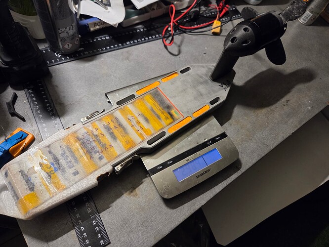

The simple/backup plan for flying to morocco holiday this winter, 5S2P Batteries I already have and adapters in a waterproof waist bag I already have.
I will make a fake battery adapter to plug a cable extension from the bag to the existing assist system. Main issue is to route the power cable in a way that it will not be chewed by the prop easily.
This is how I secure the cable to the board using a cable holder secured to the rear of the track. I saw a picture of this idea on the duotone and boost version.
