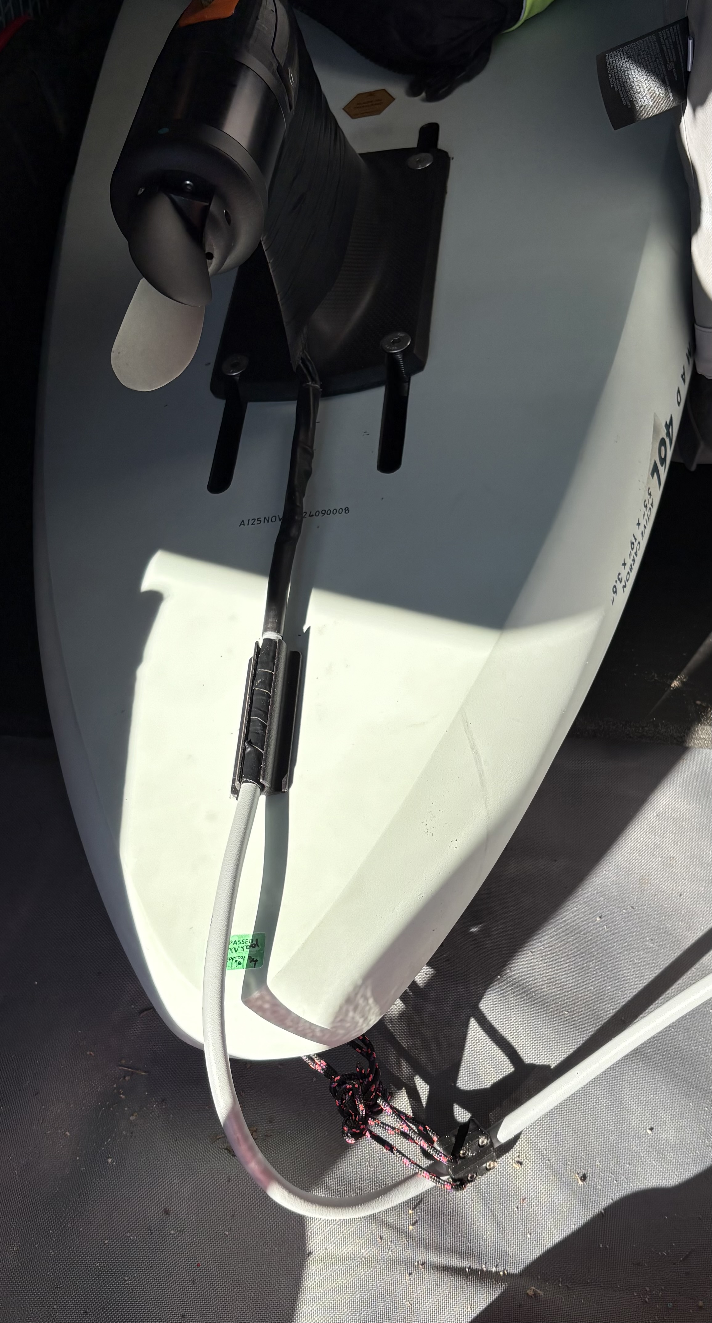

I’ve been running straight cable with my backpack very successfully. It’s the Ollflex PUR sheath 3G2.5, same as foil drive use.
I use a regular straight 6mm leash and run both inside 50mm tubular polyester webbing. The leash is about 100mm shorter than the cable. I also have a pull apart connector mid cable for worst case scenarios!
I recently had to shorten the leash because it had stretched a bit but apart from that it’s been faultless.
I’m running 12S2P XCross 120 and Flipsky 6374. Pretty serious strain relief on both ends of the cable to ensure the connector gives first. Had plenty of cases of the connector being pulled apart and I can re connect on the water with no issue at all. Generous dielectric great on the 5.5mm bullets and silicone grease on the cover. I’m loving it, using 46L board and it’s great to get the weight off it. Very high motor mount so just chugging along with board just skimming to get back out etc.

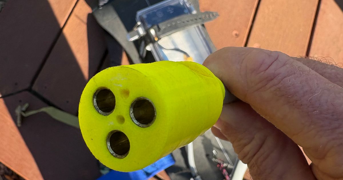

Thanks for sharing so if I understood you correctly the cable is super well secured on the both ends (e.g board/foil track and on the belt/back pack area).
And in the middle of the cable it has bullet connectors with dielectric grease applied to them that would pull apart first in case the leash would snap?
Correct, I designed a pull apart plug and printed it in Tpu. Then flooded the plug with epoxy to secure everything. Inspired by Hangloose plug and socket.
Started with petg by the alignment was super critical, the give in the tpu made all the difference. I printed a little clamp for the cable where it leaves the board.

would you mind sharing the stl for the plug?

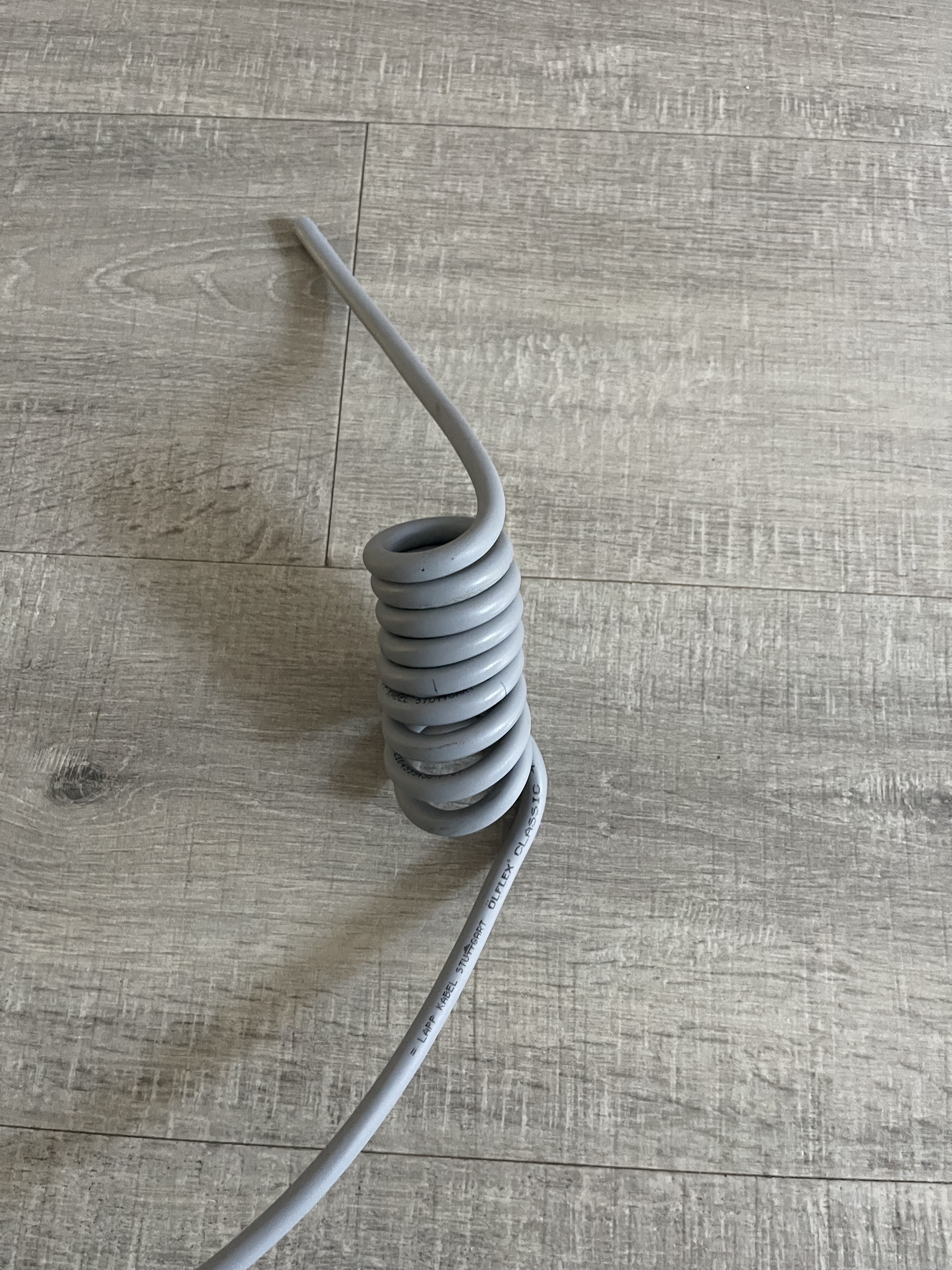

How does it behave after some time, does the cable still hold its shape after some usage?
Asking cause it looks like you have coiled it up yourself :blush:
