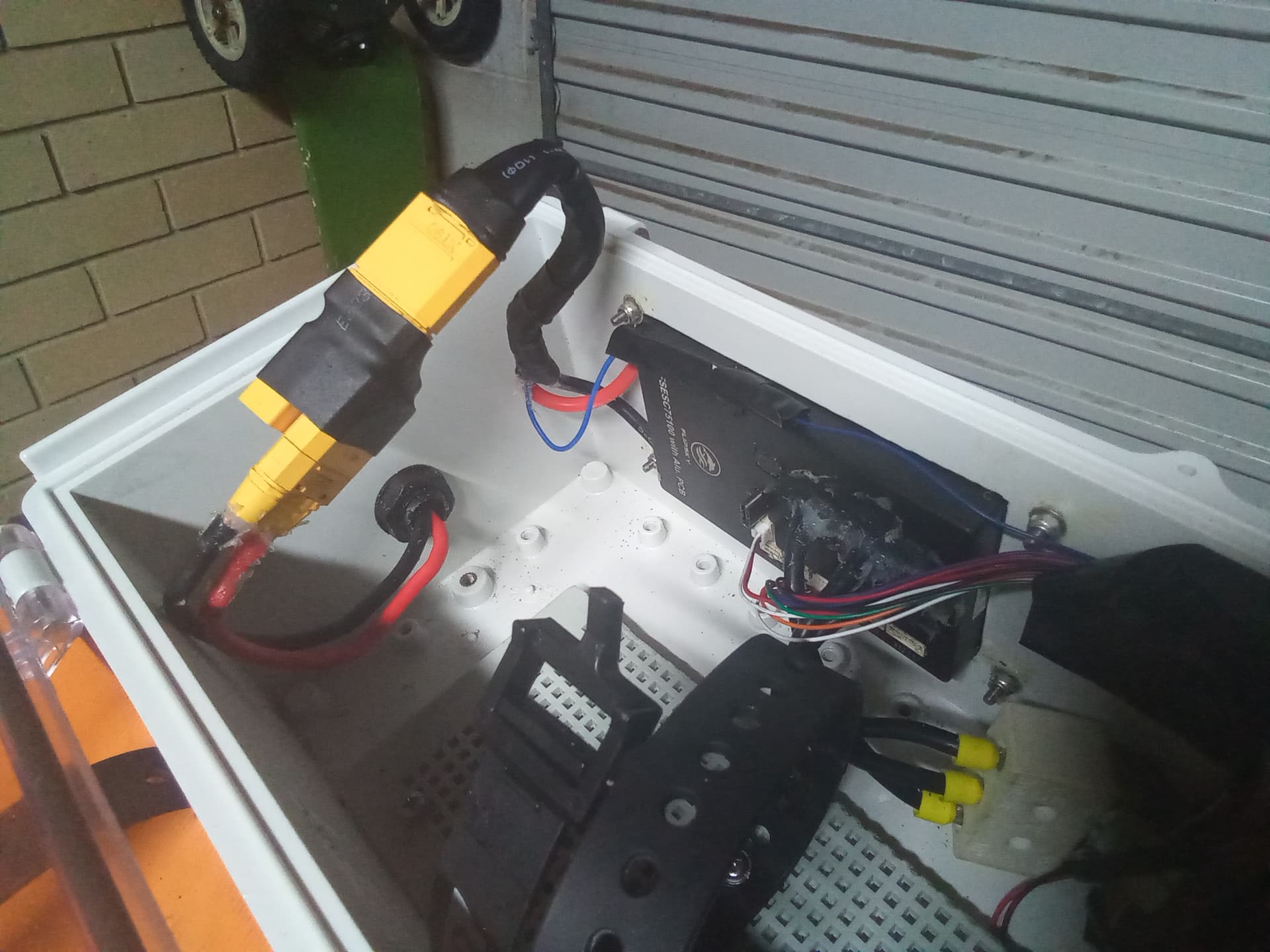

Can you please share a photo of inside your box.

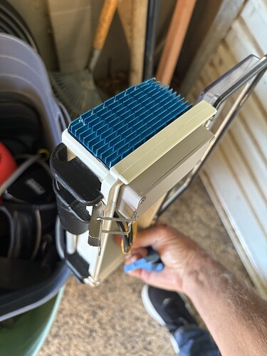

Yes I go to a bit of trouble to heatsink …

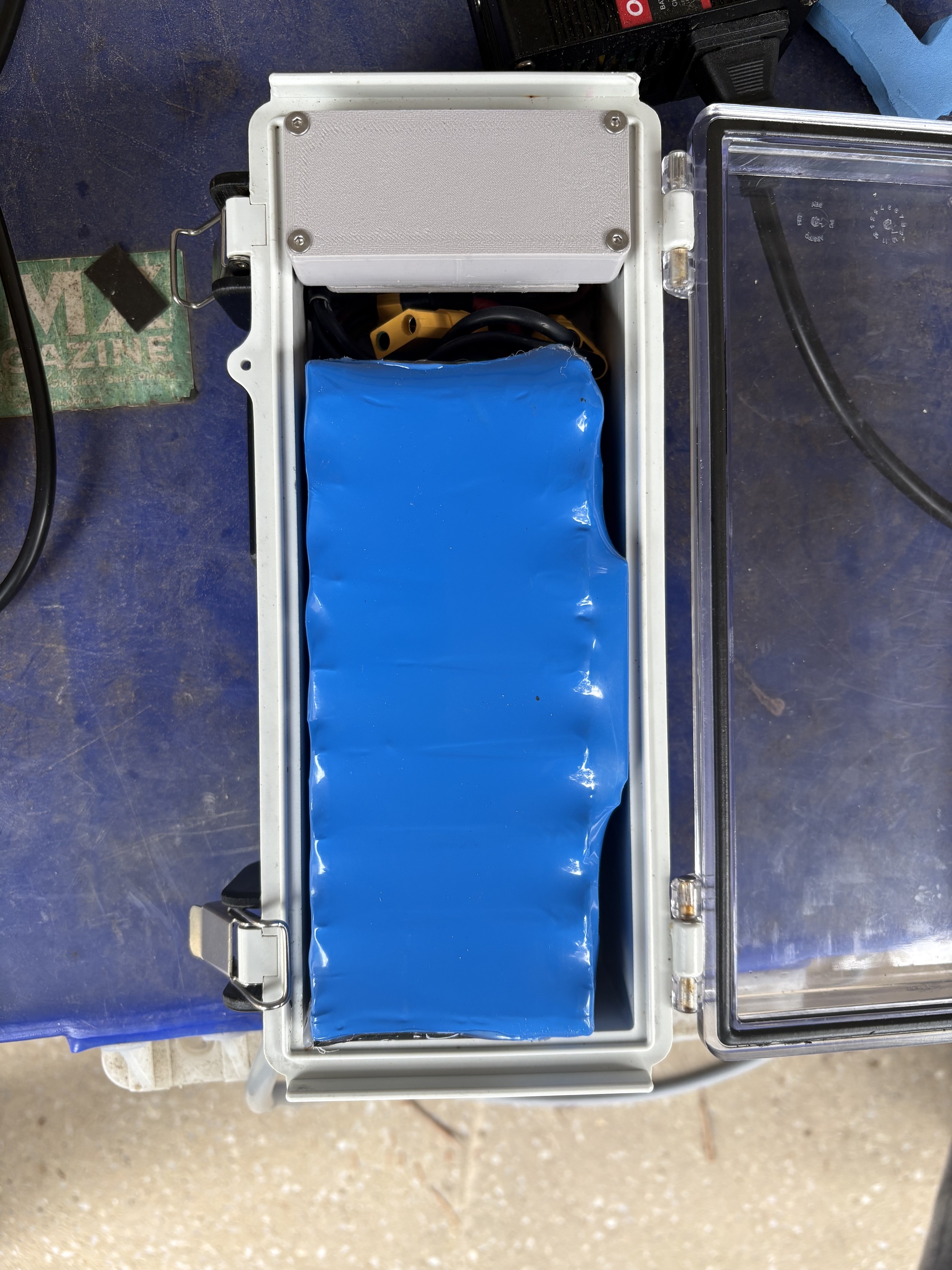

The box is. Camdenboss CHDX8-321C fits XCross and 12S2P - battery in 8x3 block layout.

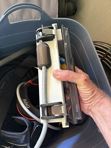

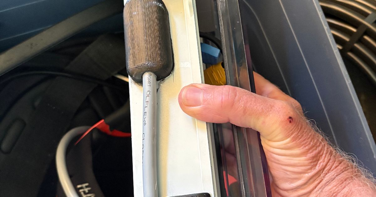

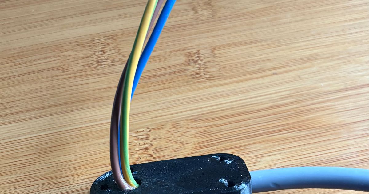

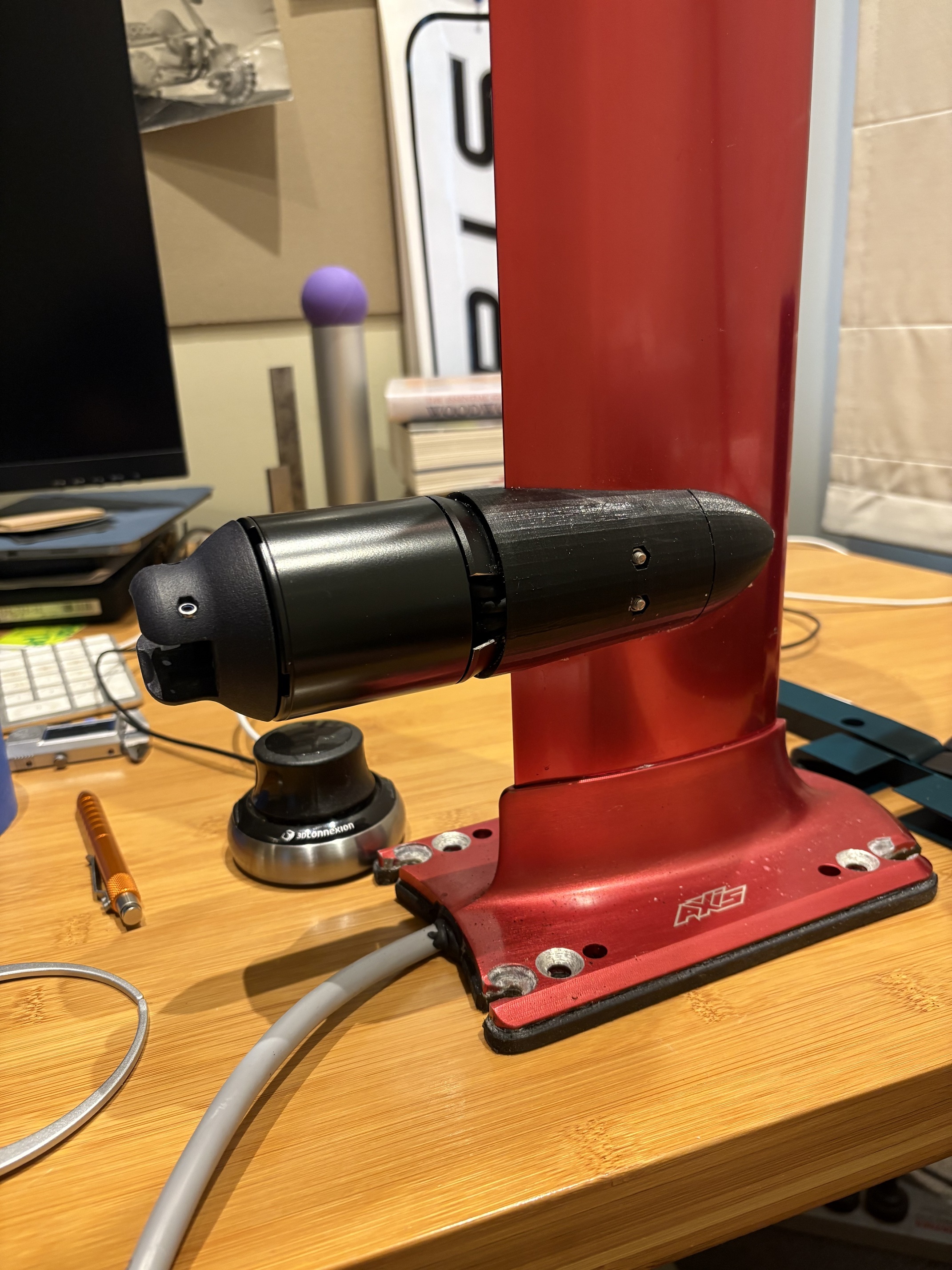

I designed a cable entry ‘thingy’ that eliminates the cable gland. Cable sheath is stripped and inserted then the petg printed piece is epoxy filled. It has 5 M3 heatserts that hold it to the box. Super low profile inside the box. Cable has a little extra strain relief by being threaded through the guards for the stainless steel over centre clamps that close the box
Outwardly simple but a lot of attention to detail (need to get a life :joy:) This has done literally hundreds of sessions and been faultless.

What did you use to attach the heatsink ? Not sure if thermal paste is strong enough for this application.
Any thoughts not using a BEC (powering RX directly from balancing wires)?
I use Kafuter thermally conductive silicone between esc and heatsink

To bond the heatsink to the outside of the box I use
https://www.fixtech.com/en-US/products/fix15-multipurpose-adhesive-sealant
Making sure to roughen both surfaces and clean thoroughly then ‘butter’ the adhesive to both faces before clamping together.

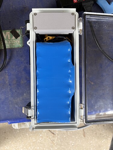

What battery layout have you used to fit into the box? I will start making these while I wait for the box to arrive.
I want to use 2 x 6S in series… as I already have 2 6S balancing chargers (and these are only $30 each).
Layout is 8 x 3 in a square block. I doubt you will fit two individual packs in the box. It’s a tight fit
I have put 2*6s2p in that box.
But it is a pain to setup every time you take the batteries out.
If you want to use it on a backpack, why not get the bigger box? There is really no downside to it in that situation and far easier to work with.
CHDX8-225C 220mmx170mnx110mm
For some reason that model is also really cheap here, at 20,40 EUR

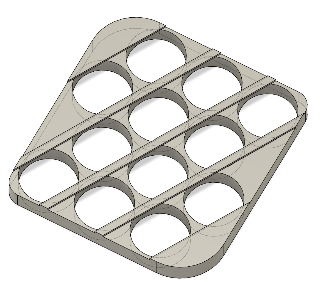

If you really want to do it, this is the layout I used.
Size is 82mmx86mm

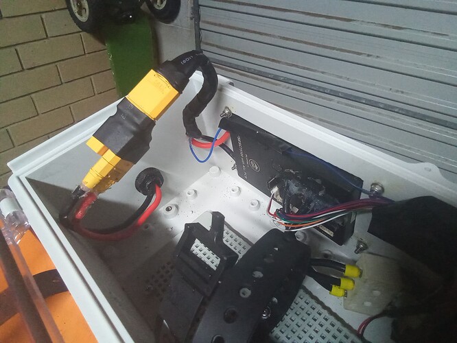

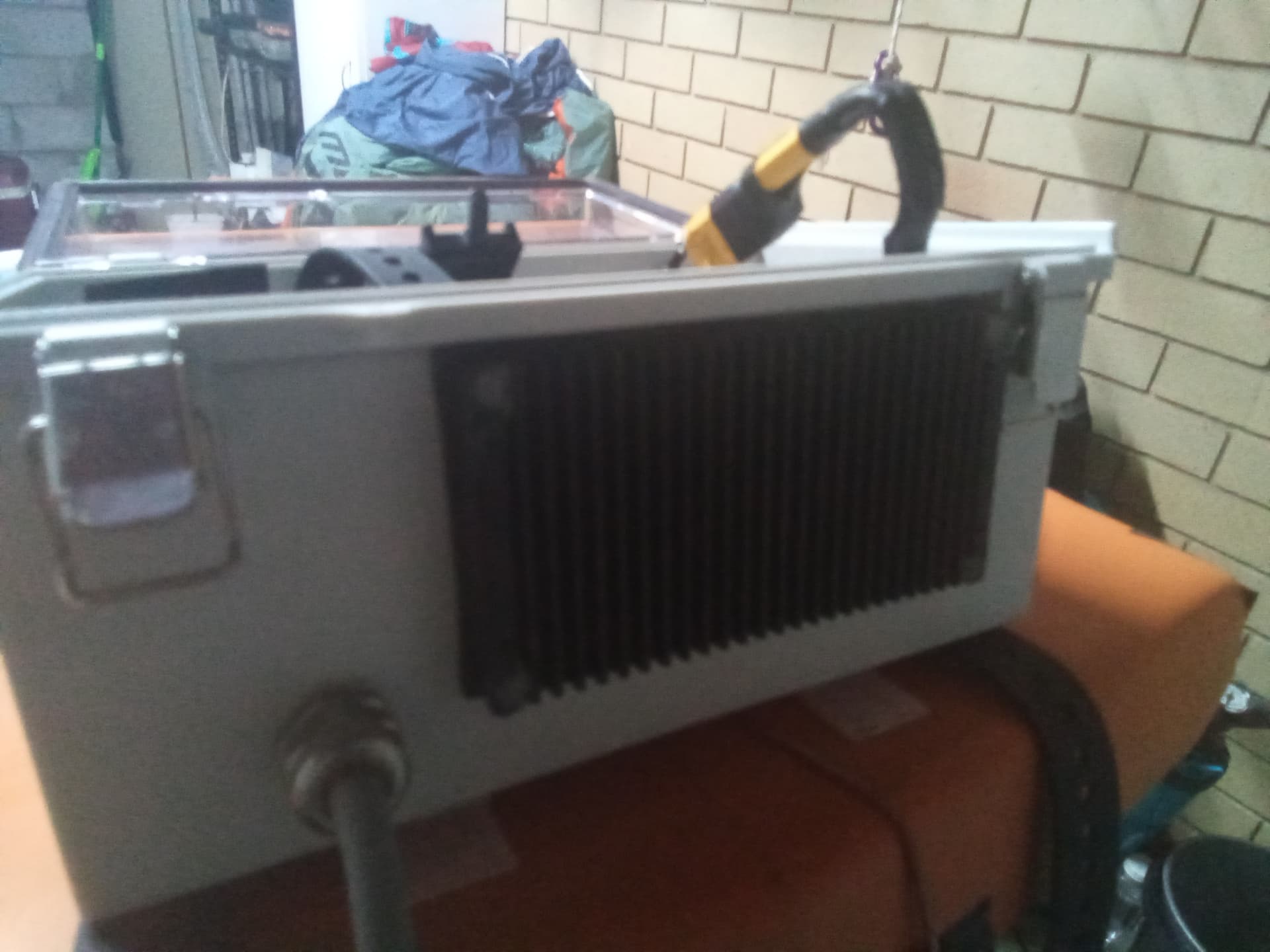

If we are on the subject of boxes and heatsinks, a bit of helpful information for anyone interested.
There are three brands that have good quality seals, Camdenboss, Bud Industries and Polycase. I had a size I wanted, then checked all three brands and went with a Bud Industries.
I used a Flipsky 75100 because it has a flat heatsink and I could just cut a hole and stick it to a heatsink attached on the outside. I used a 75200 heatsink which I bolted on with a gasket around the edge.
I used a thermal conductive adhesive sheet to attach the ESC to the heatsink. The 3M model of thermal adhesive was a nightmare and not put on evenly, but it works well. The model of conductive squares I used previously were easy but I couldn’t find them.
The thermal silicone sounds much better, and I’ll use that if there is a next time.

This Axis internal cable worked really well
That looks impressiv. Do you have the stl. for the “thingy” and for the grey cableholders on the ouitside of the box? Would be nice…
Here you go
Did you cut off the little lumps/upstand things in the bottom of the box? If so - how?
Yep, cut them off with cut off wheel in Dremel then sanded them with flat sanding disc on Dremel. The ones in the corners then have a hole going right through which needs to be filled with epoxy. I slightly countersink both side of the through holes to give the epoxy a better footprint.
From memory I also used a small round carbide burr in the Dremel to clean up the corner ones before sanding.
@thuffam
No, I didn’t cut the lumpy parts, I glued a plate to the bottom to attach the locking tape.
If you trim them, you have a hole. It has to be filled properly or air will get out and water sucked in when the box goes under water and cools, through the same holes.
I didn’t want the trouble of filling the holes, and like to do the simplest build possible.
Thanks, and good point but i will do what @JonathanC did as it gives me a bit more room and more options with battery configuration (even more so as I want to use 2 x 6Sa2P)
You meant the inside.
I butchered a few with an angle grinder for more space.
Dremel is better if you have one.
