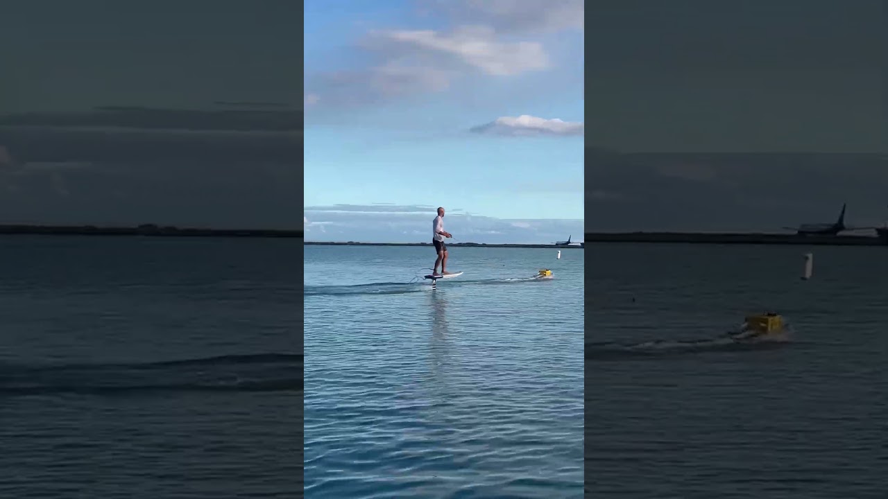

Just a couple of shots of the tow boogie in action. I am slowly becoming the laziest foiler ever not having to pump or paddle back out to catch a wave. I still prefer winging, but this thing is awesome for those no wind days.
2.0

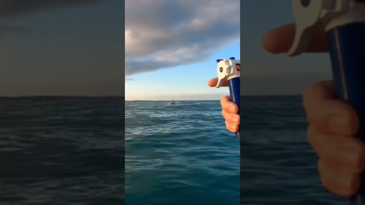

Love the remote shake, i do it without thinking now!
What do you weigh?
I have no reason why I shake it… haha.
I’m 190-195lbs. I think I could ride a 2x4 with this thing. I’m gonna try my kite foil board next. It pulled me out so easy.
My flipsky remote is potted, but would fill with water around the antenna, shaking it got rid of the water and the reception was so much better.
The BREmote is waterproof and shaking it doesn’t do anything. I seriously have no idea why I do it. :joy::joy:
