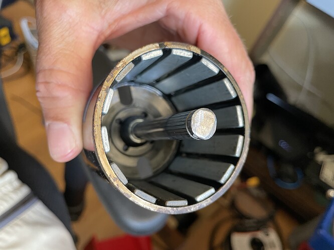

Took apart tow boogie 1 to update the mounts from the plywood, etc… so I decided to check the motors out after a few months of salt water use only using corrosion x. Minimal corrosion on a few parts that wiped off easily.
What’s your maintenance routine? Do you remove the rotor and rinse with fresh water? How often do you spray the motor with Corrosion X?
I rinse it with fresh water after every ride. I don’t remove anything I just spray water where the wires go into the motor. I spray corrosion x in every 3-5 times out.
