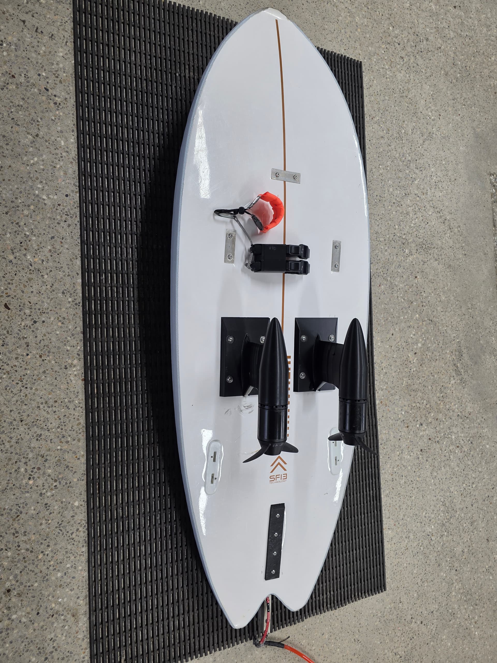

I’m going to do a 5’8 ‘homage’ ! Could you please let me know where the motors are on that board, how far from tip or tail to centre of the motor pod. Thanks
Edit: I thought I was replying to DM.
Yes, sorry for the late response, been a super busy time. I will get the measurements tonight and send them to you.
About 24-25 inches from the tail to the center of the motor pod. I like to put them close together as well. It seems to be much more stable. About 7 1/2” from center to center apart.

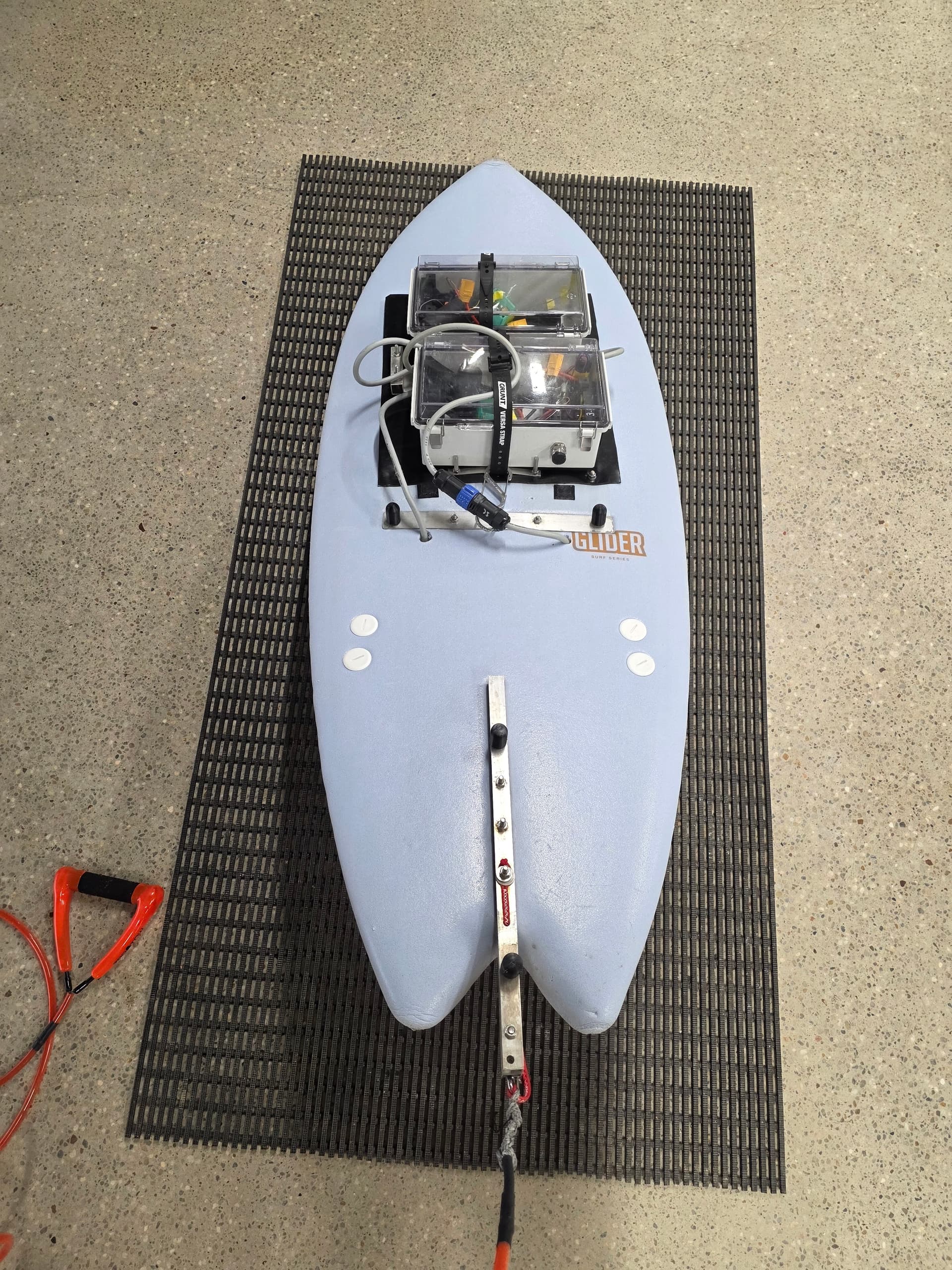

Just an update for those reading this later, the pool noodle made a huge difference for keeping the nose up during starts with my low rocker nose, and also in choppier conditions. Here is a pic of my setup. Huge credit to @Jesserosco & @Etiennebzh for sharing knowledge and designs, and @ludwig_bre for the bremote, battery calculation tools and videos, and steering ability! https://youtu.be/Ucmq9VKIzOk

I’ve only mocked this up for a few water tests but have found the pool noodles (double stacked :wink: ) a must have for this short 42" board. Have also added a lower tow point like yours and two trim tabs (one each side) while trying to solve an issue I had…
The only big issue I was having was the boogie was bouncing side to side when it got to about 20kph (“chine walking” was the closest boating term I could find that roughly matched what I was seeing") but I found this was possibly caused by my motors pointing up too much - the boogie isn’t as flat as I thought it would be when planing. I shimmed them 5 degrees negative from the position in the photo and it works much better. I’ll probably try another 2.5-5 degrees to see if it’s even better.

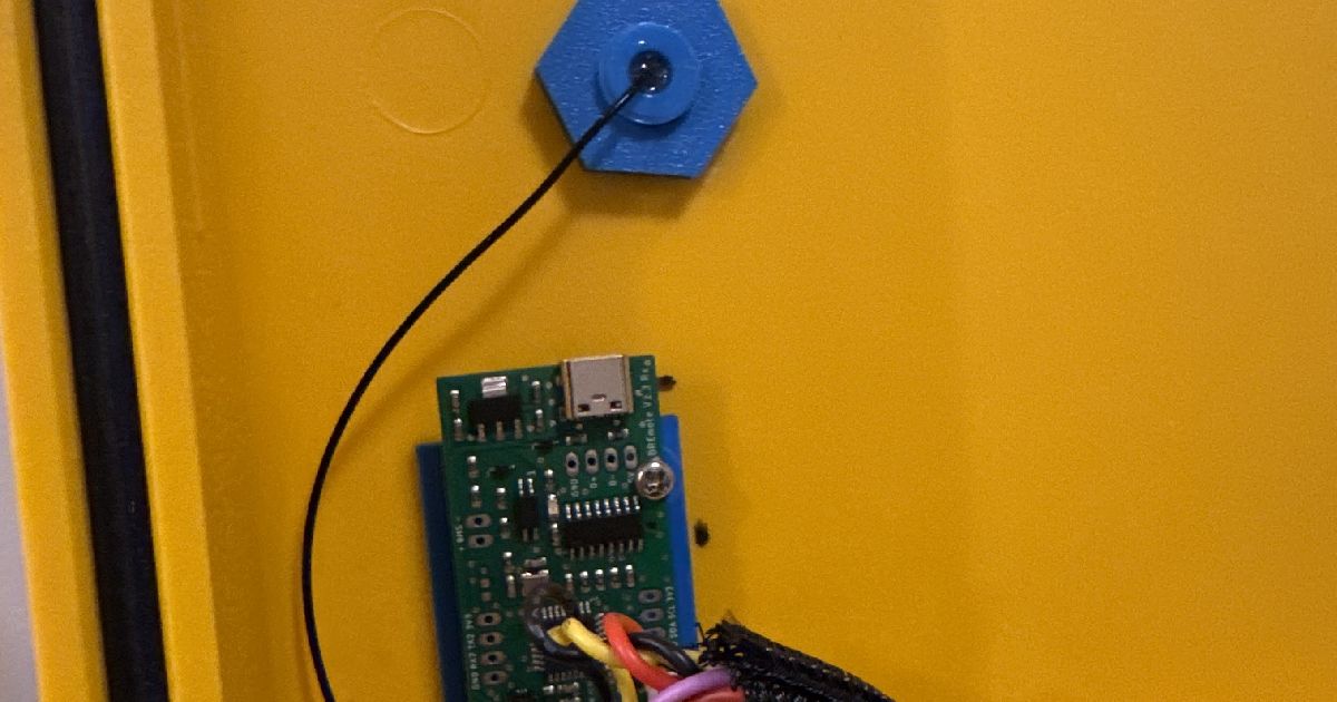

Are you willing to share the STL for this? My ‘simple’ o-ring based install didn’t go so great as my thread was way too short and the box is a lot thicker than I thought!
Yes. I will try and get it added to my printables tonight.
here is the antenna gland.

great build Jesserosco, I’ll be building a similar set but im trying my 5’8" x 22" midlength wing board. I’ve have been reading heaps I see your motor position is 25" from tail to centre of pod but can you measure to back of motor since ill be building my own mast system from carbon.

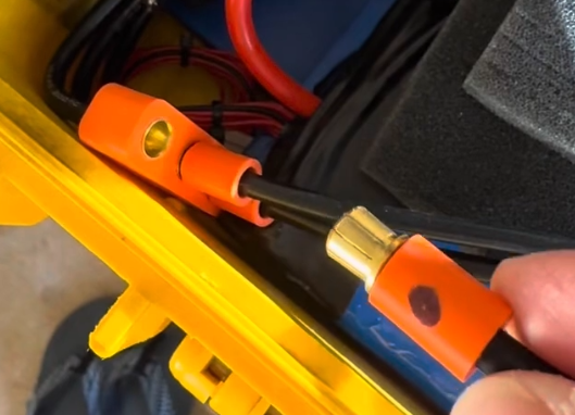

Hi Jesse, could you please upload your stl of the 8mm bullet plug spacer bank?

Homage to @Jesserosco sweet build. Made my own mods but it has worked really well from the start - the overall design of the OG build was spot on. I have had quite a bit of experience with building waist mounted assists. I’m using Saite 6384 motors, Maytech remotes, 16S3P in each box … and modified the motor pods to make them a little more slippery through the water - and single tighening M5 bolt through the motor shaft hole (I can remove replace Pods and motors easily). I have seperate box/vesc/battery for each motor. Happy to share motor pods/puck files - please DM me. Had 30 or so sessions in the surf and I get about 15km of towing according to the Garmin. Big thanks to all of you for the knowledge shared.
