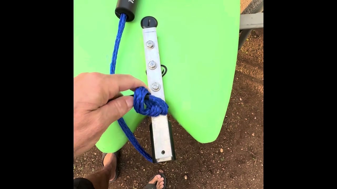

Made a smaller board setup. Motors much closer together and it actually worked really well. It was choppy this morning, so one of my bigger boards would have done much better, but this is a nice smaller setup. Made a new motor pod that is much better. Still tweaking it to optimize.

About 7 1/2 inches apart.
Small single motor tow boogies don’t work well. Dual motors with counter rotating props should be possible to make a lot smaller.
The small boards work great, but of all my boards the CBC Sushi 5’ 8” is by far the best for all conditions.
This is good feedback to know. Nose rocker seems quite critical and the Sushi has a good amount. I’m using a 4’6 inch soft top (similar if not identical to @Etiennebzh Wave Power Softy 4’6) with very little rocker, and on first testing this weekend, had to give it a really good burst on startup to get the nose up, otherwise it would just bog. I might try the pool noodle bow like @Strongarm used on his original Boogie, and also keep an eye out for something with more nose rocker.

@Jesserosco Looks like you might have bent the nose up on your Sushi board in these images, was that intentional or did you hit a wall at speed by mistake? :sweat_smile:
I totally agree with having more rocker. I wonder if I could heat the nose up and bend it.
It was like that. Used board
I never tried but in reshaping your nose, maybe cut some thin v slot relief lines across width of the nose where adhesive can be applied to help keep new rocker shape after it cools
I’ve made a lot of changes to my boogies and will post some updates when I can get some pictures together, but basically I found the 4mm bullet connectors with 12 awg wire inside my box for the motor wires were getting way too toasty for my comfort. The heat deformed some PC and ASA spacers I made for the connection point and also melted some of the foam inside my box. I am swapping all my connections for 8mm and using 10awg for the motors. I’ve already swapped one over and it is a lot less heat. I made some new motor pods that require modifying the front of the Ali 6384, but are much easier to run the wires and the pod is much stronger. I changed the thru box connectors and do not use threads anymore to secure them like the ones I modified using @hangloose. I use a little dielectric grease to seal the connection and have had great success.
I have also found putting the motors as close together as possible is a great improvement. It still steers great, but is so much more stabile in the roll axis, especially during turns.
