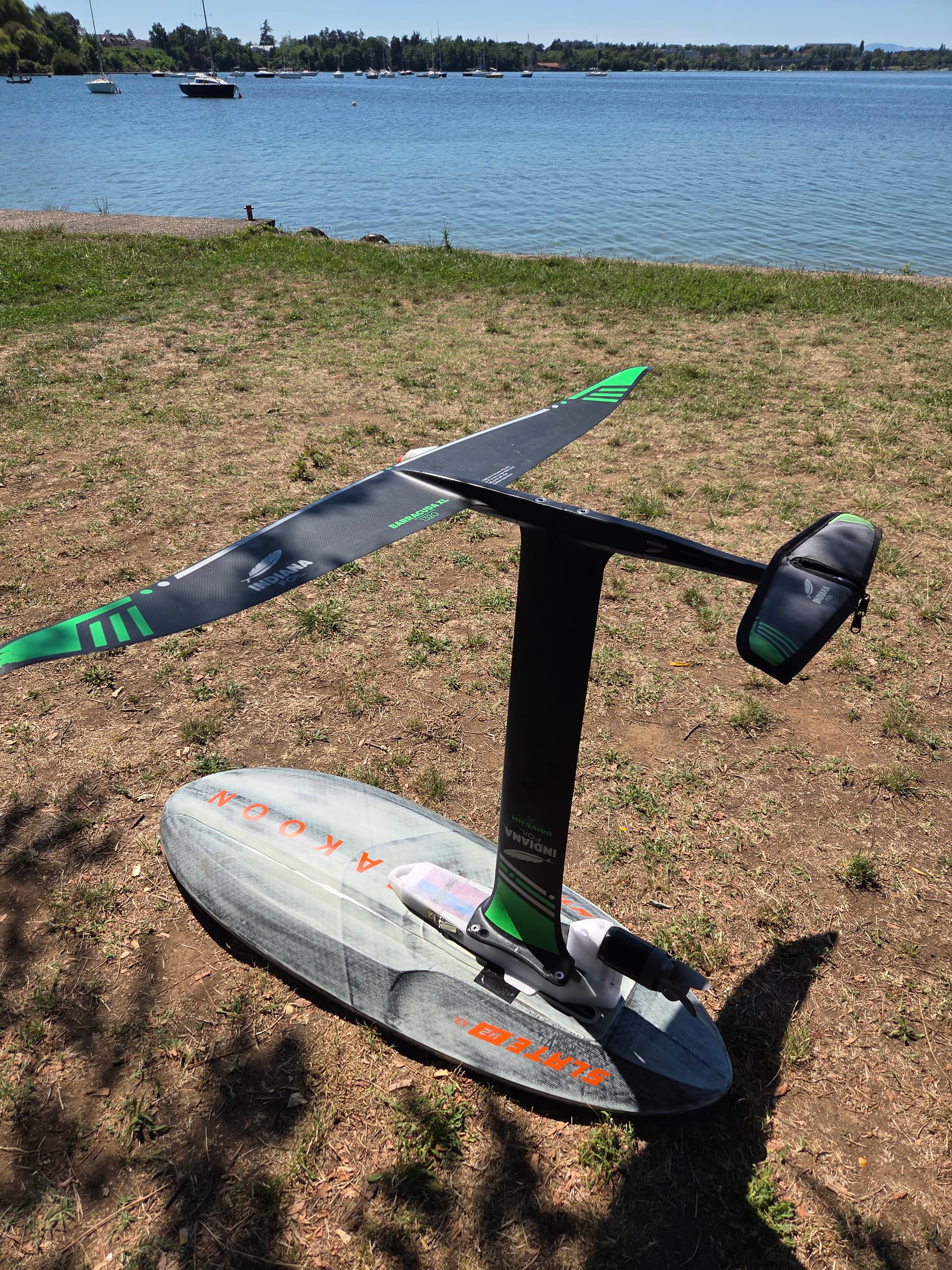

I start with 24lt and 1050 barracuda L, 12s2p 18650 35E. 66kg, it requires good technique and not too choppy/some waves. With barracuda xl is is quite easy and does not use as much power.
2p 50S with a tuned and efficient system would definitely work as an assist if you are not 120kgs
I have been running 10S2P P42 Molicel and also 12S2P P45 Molicel packs for foil assist. Both with AliExpress 6384 and XCross esc.
Can easily get up on 5’5 x 19 46L board on flat water between waves with either pack using foils down to 750cm. I’m 66kg.
Considerably longer run time on P45 12S packs but for pump foiling the P42’s are fine.
