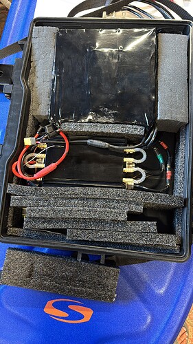

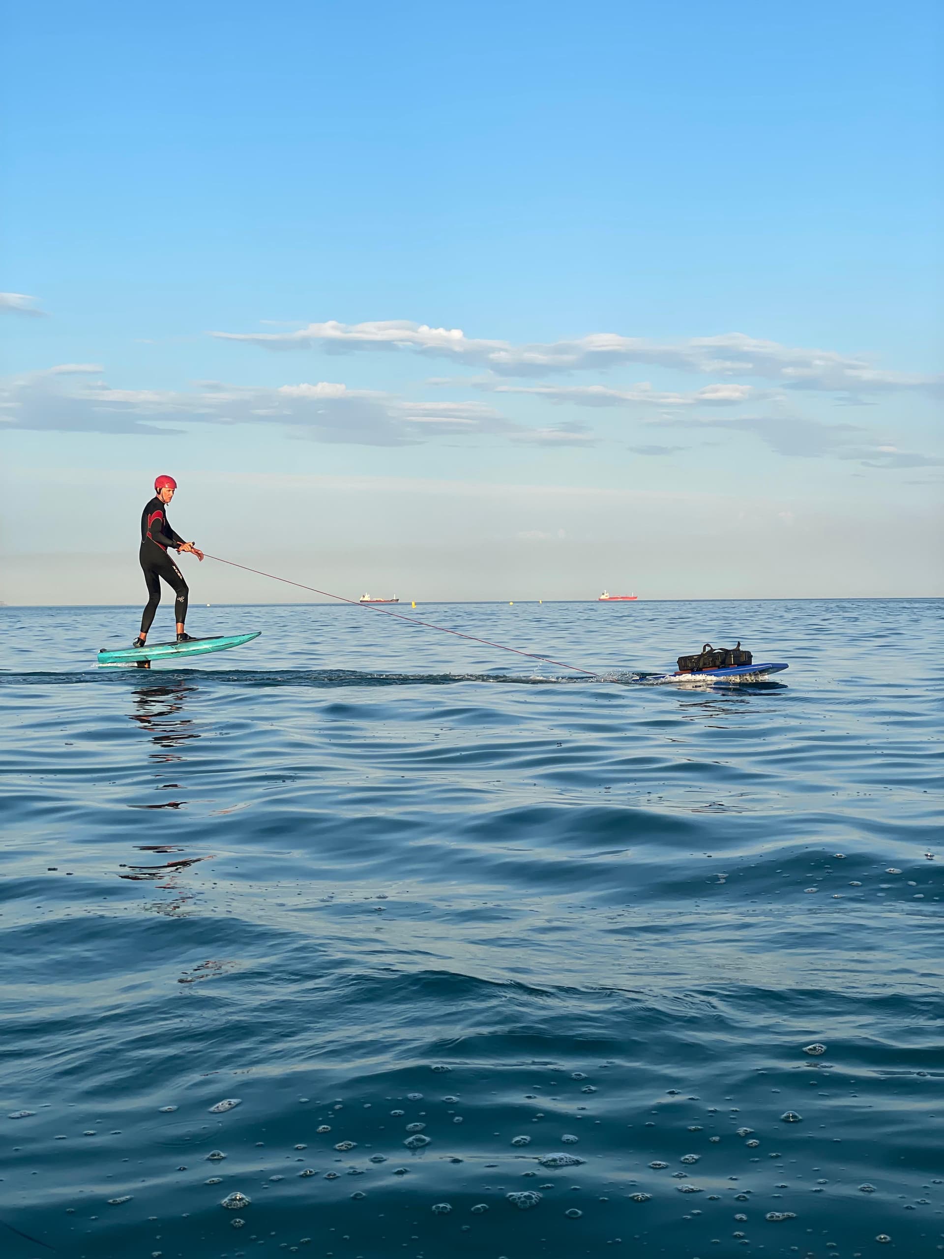

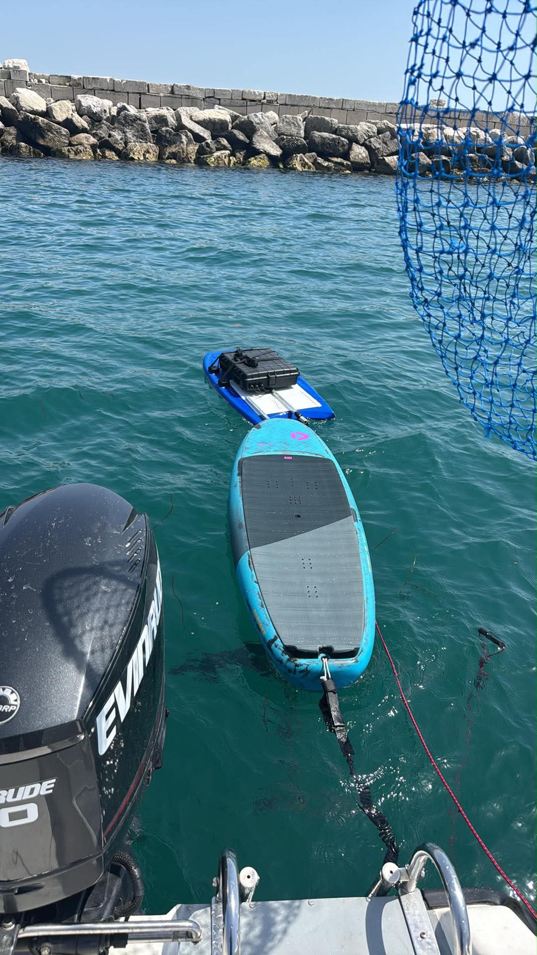

Finally have got a boogie built and done a couple of tests. First one was alone (possibly not the brightest idea) and another with a few other guys. It has its drawbacks buck it bloody works!
Base is a boogie board and and old maytech kit.
The board is just enough to keep it above water, some chop can get it nose diving…
The maytech esc is huge and is a little clunky on startup, we did a pretty long session with 4 of us and it was hot at the end. I’ll add some water tubes into it and this should make it not melt. Goal now is to make all the mounting a little better. Possibly look at a better hull. In fact, what am I saying, probably a complete redesign.
The battery is 12s 12p using salvaged cells from a Kaly electric skateboard, I think a more modern cell would be a lot better.
