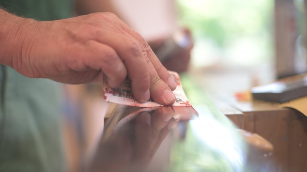

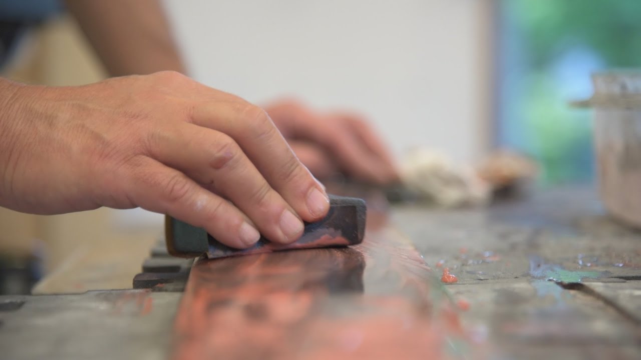

Glazing compound. I haven’t tried it yet, but I did buy some.
Here’s the start where he shows the glazing and applying it.
And the product: Sorry! Something went wrong!
But important to note that this is red in color and is for tiny imperfections, not serious scratches. While you could fill them with this, it’s red. So you might want to use epoxy for more serious stuff.
But this is cool and has good info on the fact that only the first third or so needs to be smooth really. The Delta guy wins for good foil info online with very little product opinion added.
