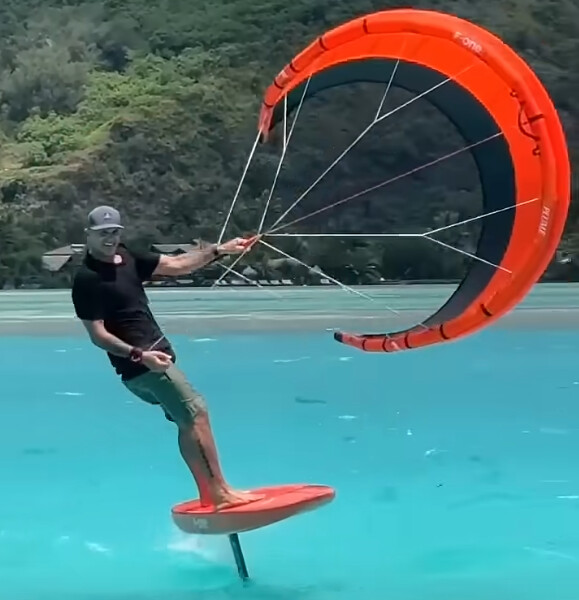

On the 2025 labor day, F-One unveiled an inflatable parawing concept: the K-WING with a first model called the Plume, a concept mixing a small (3-5m2) strutless kitesurfing kite with short (1.3-1.5m) paraskiflex-like bridles (but different see below), available in June 2025:
First test of a Plume prototype, lesser low end but according to the comments, the final product has much better low-end power, improved bridle, and bigger sizes
The k-wing concept is to parawings what foil kites are to leading edge inflatables (LEIs)
