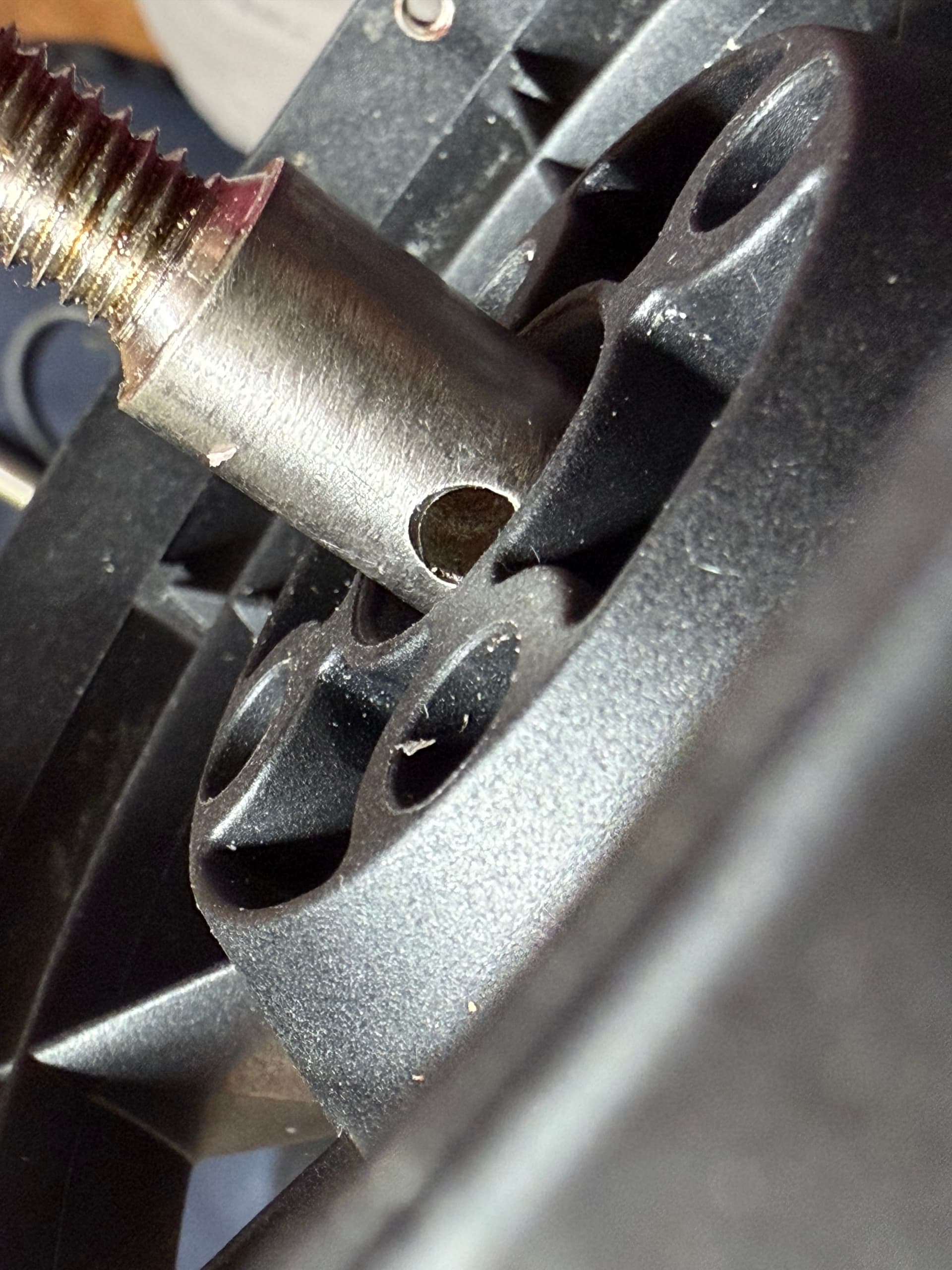

The photo of Gary’s that you reference is the Lift duct pressed up against the “bump” on the 65161 motor. That position partially blocks the pin hole in the shaft of the motor so he is creating something to deal with that - exact details to follow.
If I can alter the centre ring of the duct piece enough so it can reveal the shaft pin hole to the point where I can mount the prop AND alter
the prop through hole so that I can get a locking nut on the end of the shaft the only issue left for me would be the attachment of the duct to the motor.

I abandoned this approach because it doesn’t appear to be enough room to get a wrench or socket in place secure a nut if you expose the shaft through the enlarged hole

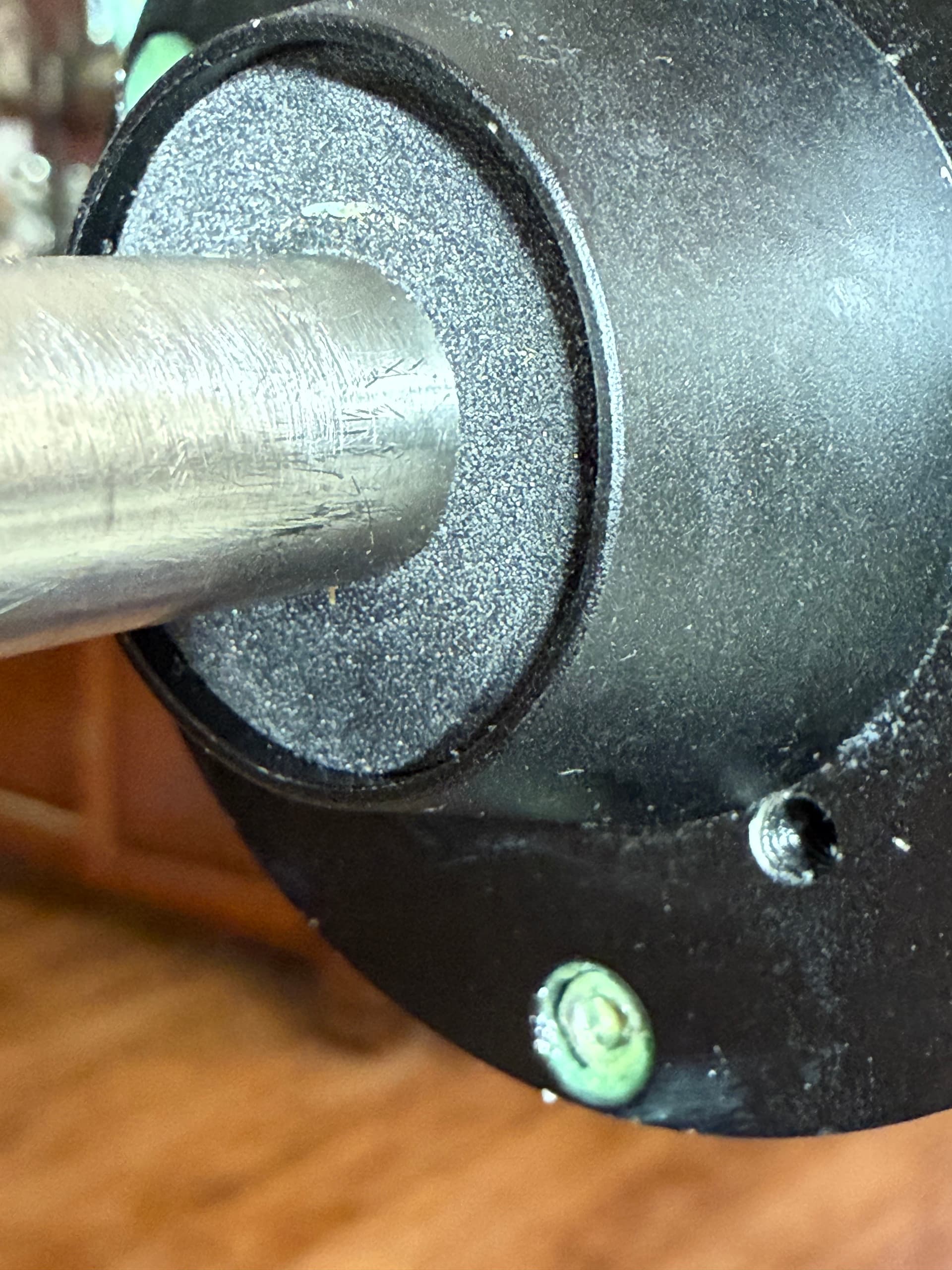

Is it generally OK to shave off some of the motor lip that extends past the circlip onnFlipsky 65161? I need about 2mm. The circlip grove will be maintained but I am not sure how much of that lip is needed structurally.
Cutting this down should allow the Jet housing to push further back toward the motor so I can install the prop pin lock.
