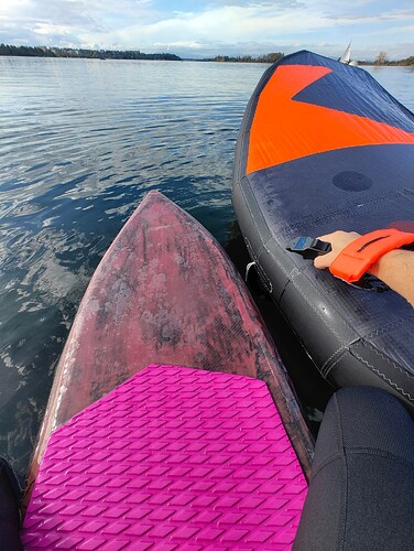

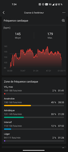

I had another pump only session with the 1401, checking every bolts and added some thick plastic foil between the mast and the fuse. It was much better :grin:
I still have issue with breaching on the 75 cm mast, but this is mostly rider issue.
The physical challenge is real :saluting_face: but it’s really motivaiting me to get in better shape.
