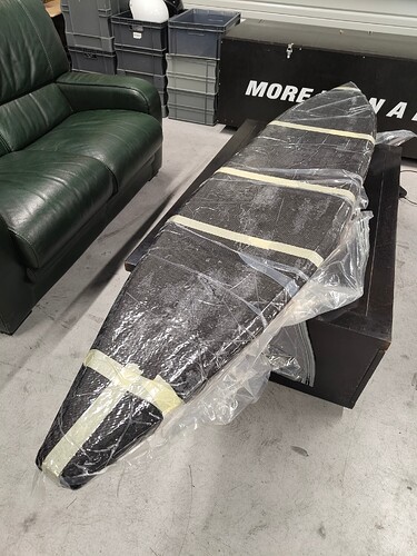

The DW board should be between 4.5 and 5.5 kgs, it was at 3.1kg with Hull layup before filler coat, missing top layup and pad.
Should be on water sunday :love_you_gesture:
Deck coat has way less wrinkles than Hull, despite some issues with vacuum during transport :dizzy_face:
1 layer carbon all the way + 1 renforcement layer on Feet area + 1 layer GF 125 all the way.
4.3 kg so far, so 4.7~5kg with filler coat and pad I Guess.
Still undecided about putting another layer of glass or carbon leftover patches on foil box :person_shrugging:

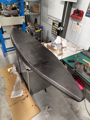

Top filler coat done. Hot coat tonight and water tomorow afternoon :checkered_flag::checkered_flag::checkered_flag:
You are fast. I Like it :wink:
Worked 2400-0200 to make it happen with work and family schedule lol. Then top coat during kid nap. And varnish when kid asleep tonight :clock8::clock8::clock8::stuck_out_tongue_winking_eye:
How are you getting the time in for the coats to cure? Mine always take an age at the end in between hot coats and sanding and checking for pin holes etc.
Quite hot a work when we have the oven on (120kw), then at home I have this closet with heat pipes that goes UP to 30° or so, basically an autoclave :joy:
Ready for test this afternoon. Cabon feels much stiffer than my pump board with amazon epoxy (at box opening)
I prepared the hole in the pad for gore vent on deck in the middle of board.
Surface finish is far from perfect, but as some other said, the board is meant to ride in the air most of the time :wink: I will rework the hull later if I feel it is dragging too much water at takeoff.
Maybe I work fast because my standards are low :joy:
Fail fast philosophy :love_you_gesture:
Finished weight is 4.830gr
