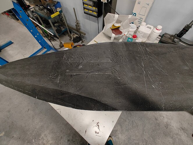

It is a lot of work, Hope it will be strong enouth. Cf 200gr gf 125. Cf IS overlapping over foil box.
Deck I will add another gf patch for Feet area.
Short on CF :sweat_smile:
Went quite ok, few dry spots on the edges, nothing dramatic. Quitte light so far!
