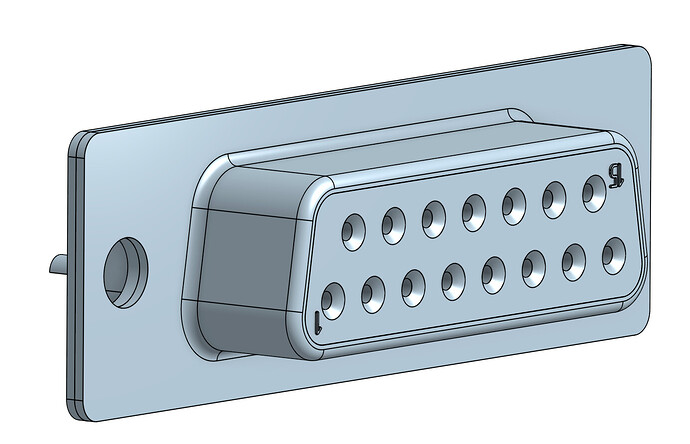

The magnetic connector declared as 2A, but even with 1A on all 14 pins it will dissipate 7W, which is very high.
GX20 female is an option - only 15.2mm diameter.
But I need even less diameter, so probably will return to db-15.
I checked again the pogo connector pins resistance and now i get normal mohms resistance. So seems like maybe it has normal resistance, but it is unreliable.

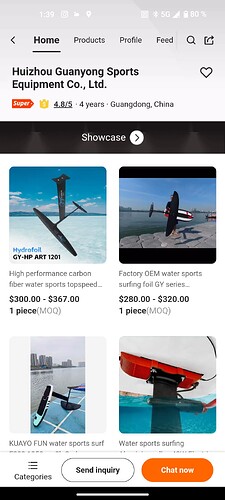

I’m really interested to hear your feedback. I was saving money to buy an axis pump foil (with 1310 wing) and saw this manufacturer in your post. I saw some videos on YouTube from a brand reselling the same foils (I guess they just put their logo on it, the brand is Roamfoil) and it looks really performing well. I will order one if you are giving some good feedback, for a fraction of the price of Axis I can even get another smaller wing to use with my winch at high speed.
Getting out with a high performing foil is nice but it makes me cringe that they even used the axis names (png1300 etc), crossing the boundary between inspiration and theft.
This is probably enough that you could have them confiscated if customs knew what they were looking for.
Will write a report later when out of China
There is a factory in China that sells Axis replicas, but if you get along well they can sell you the original Axis wings and masts for the price of the replica. I bought an HM mast for $500, completely original paint job, compatible with the original Axis fuselage.

Im really very interested in knowing what the quality of this wing is like. Is this a rebranded Axis 1201 (i.e. do they make foils for Axis?) Or is it a good/ bad copy…theyre not expensive and thats great but if it doesnt perform like a 1201 then spending the money isnt worth it. The quality looks good for sure.

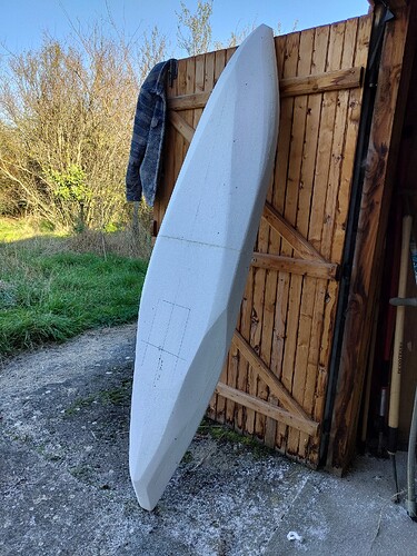

Started the winter DW board build, now around 3 hours in.
7’2 by 19" approx 90lt
Should glide well, Hope to find the right weight/strength ratio. It’s 15 kg/M3 foam, I plan to use 14x10mm wood stringers on the foil box and deck. Regarding the assist integration, I will prepare a hole to pass antenna from bottom to top to avoid carbon signal blokage.
