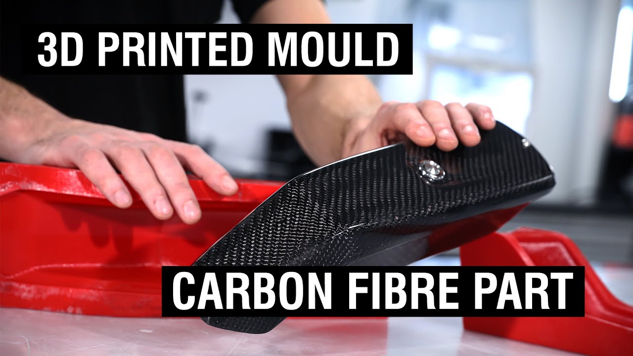

This company has some great videos on this stuff.
yes, that was the inspiration, very high quality videos and extra infos on their website for each video
