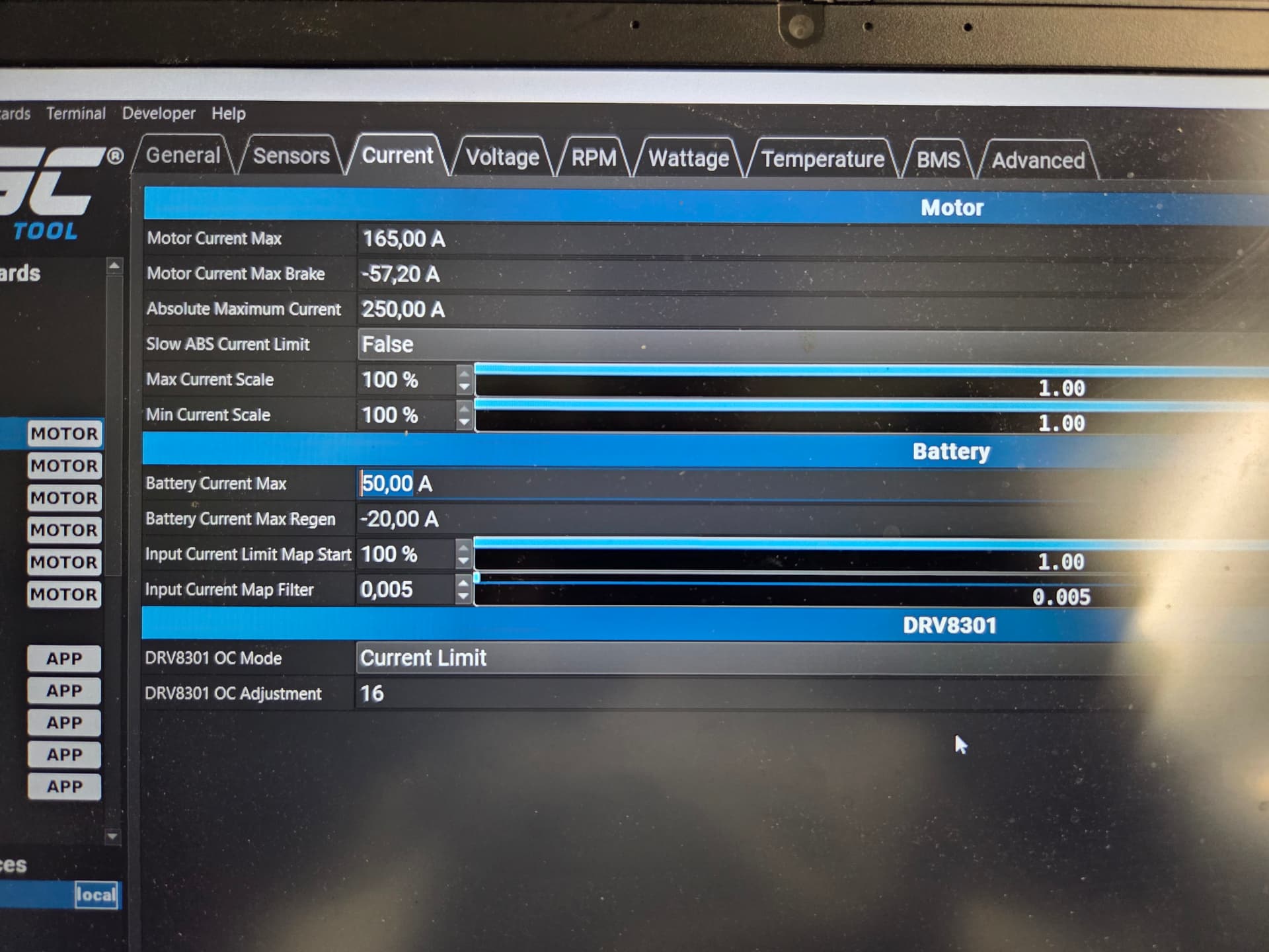

You wont ever hit the motor max unless your battery current is 80A
Well my v3 system with 12s2p 35E and 40A battery / 125A phase, 6384 120kv and same prop works very nicely.
Also on 1p 21700, >50A is optimistic
So if more phase amps does not fix it, I will change the motor to 6384 120kv
Test in a few hours

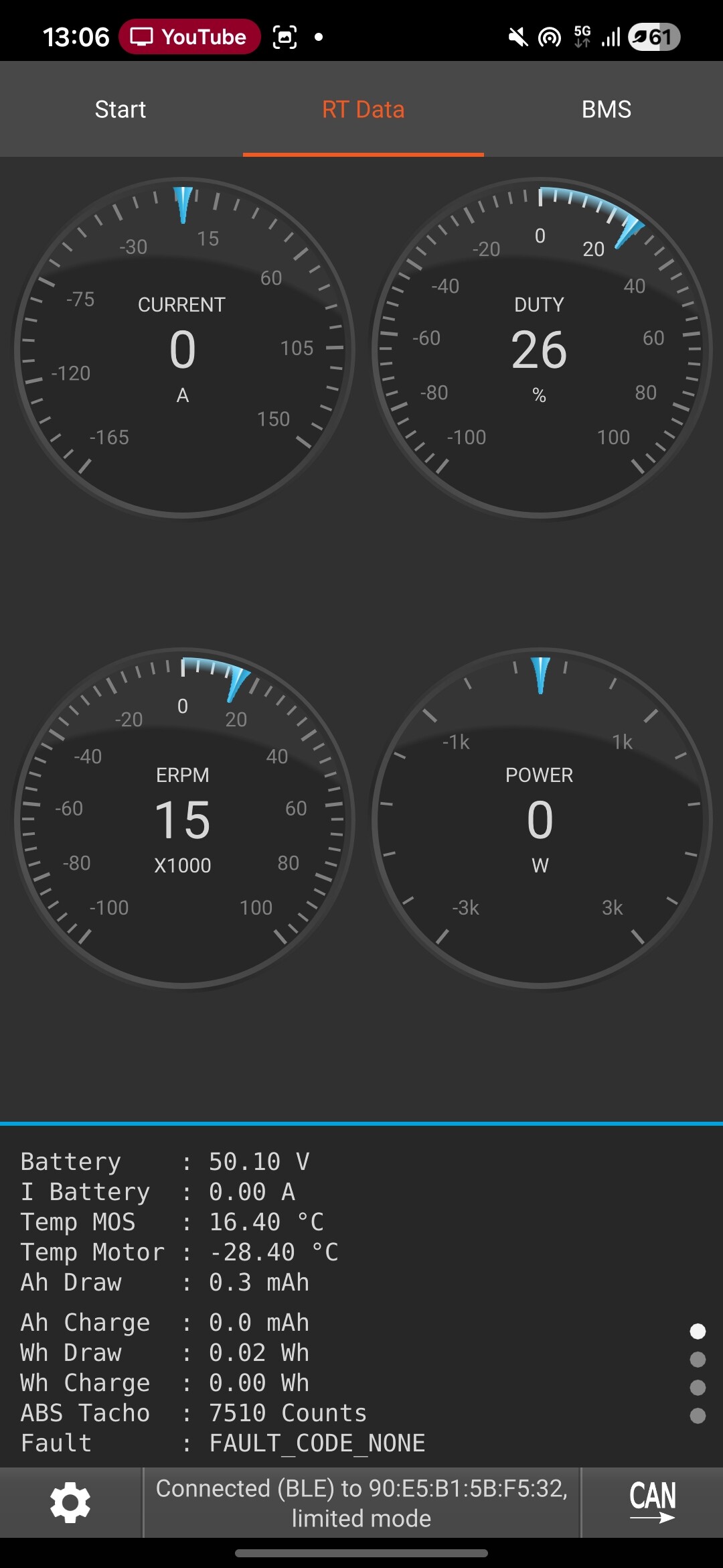

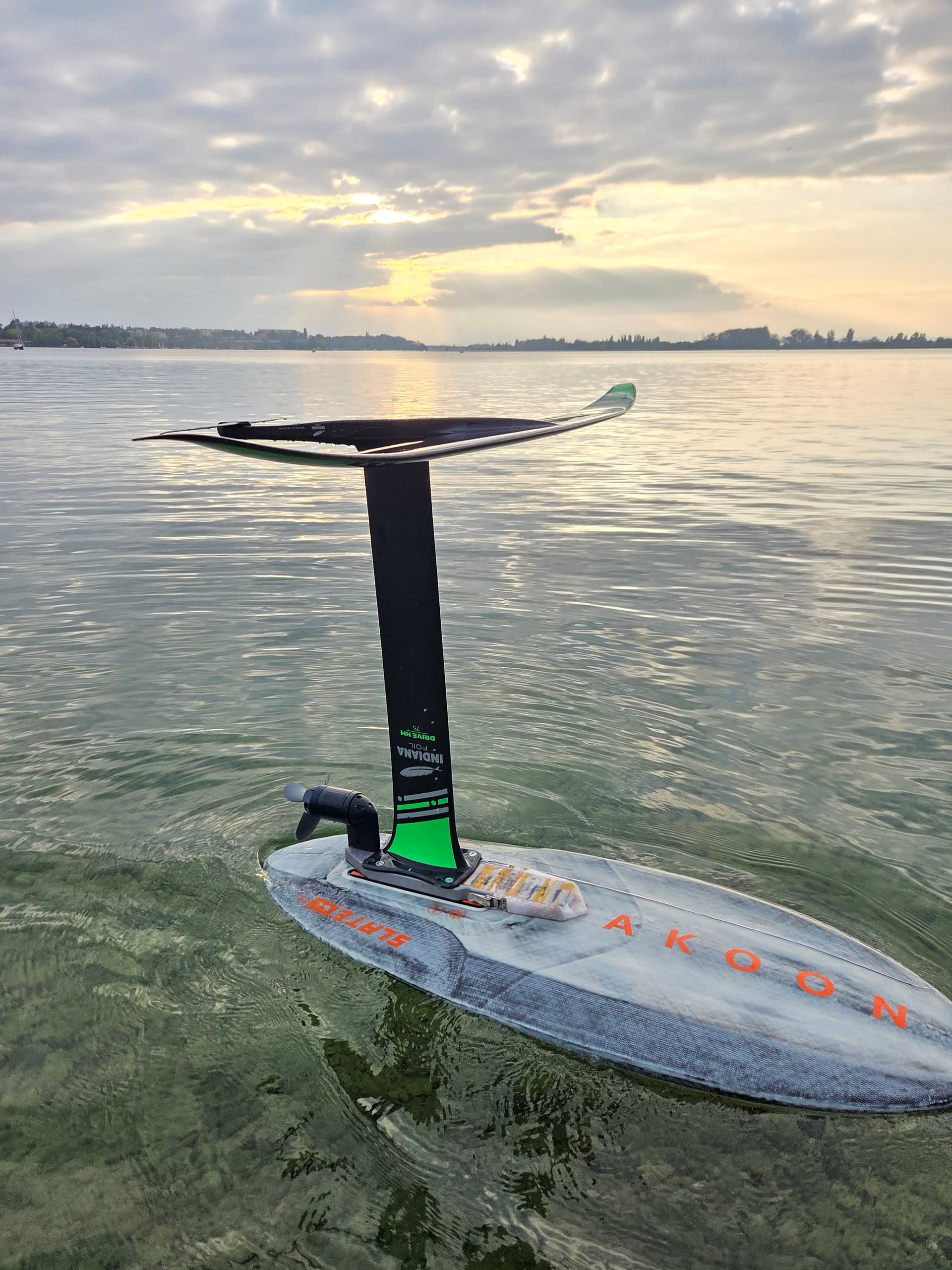

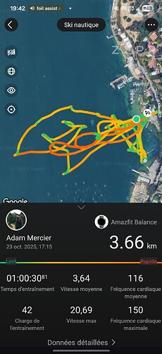

Went much better but still some cutouts under full power.

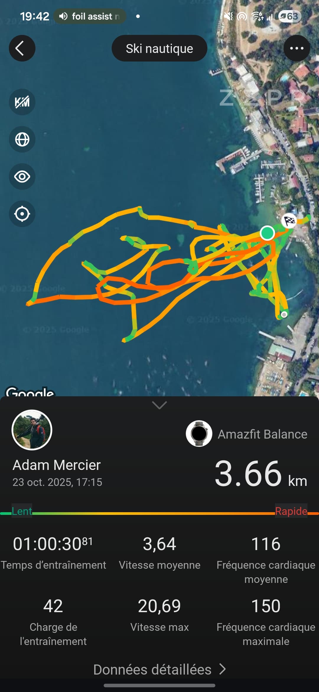

Got 27 start + 2 failed attempts, much better than anticipated.
That is with zero motoring, just start then pump 15->90 seconds
Conditions were ideal with flat water and no wind.
super Impressive design work! 8.8kg all up is mega!

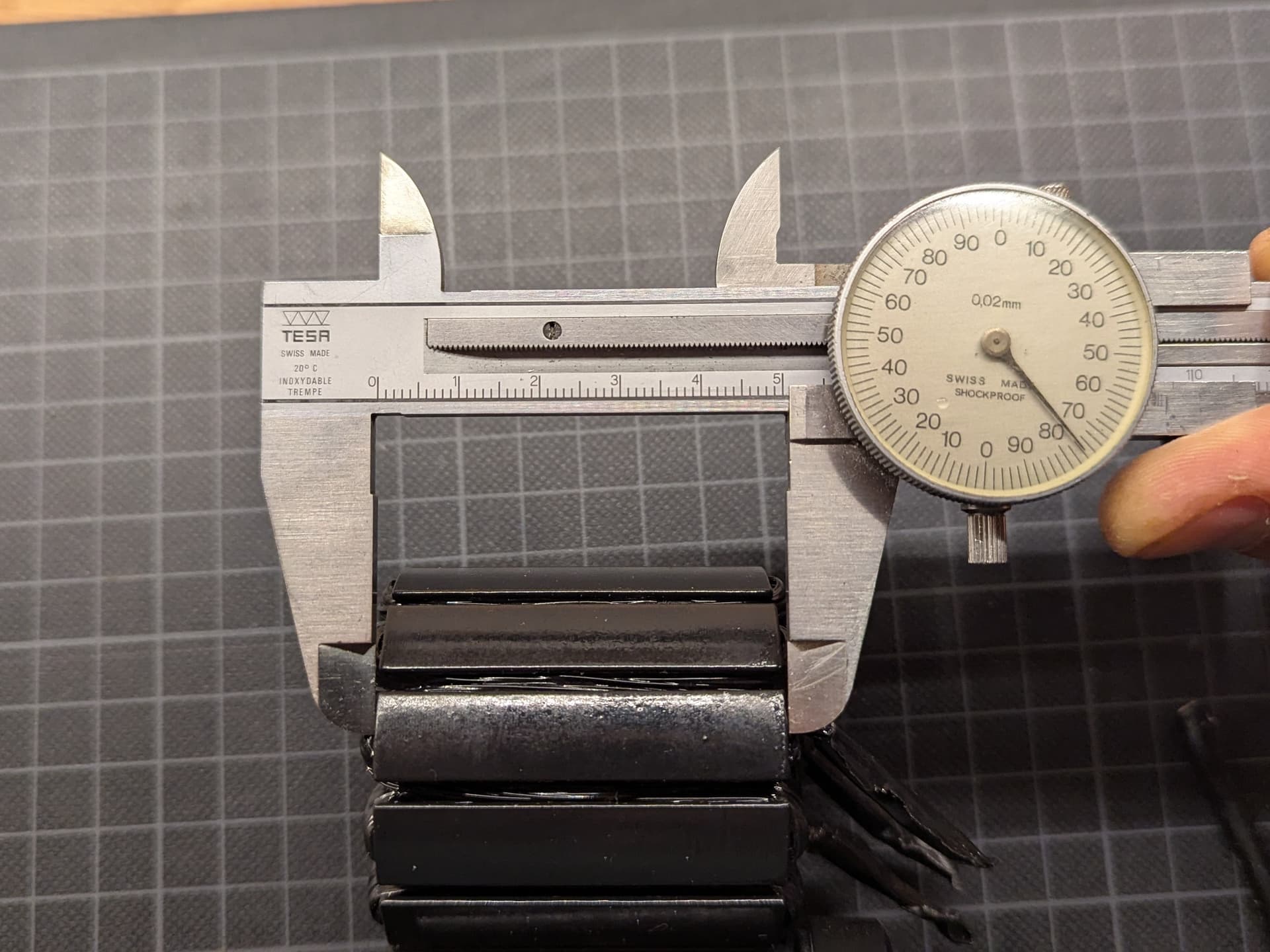

@Jezza I don’t agree on that. Did you measure yourself?

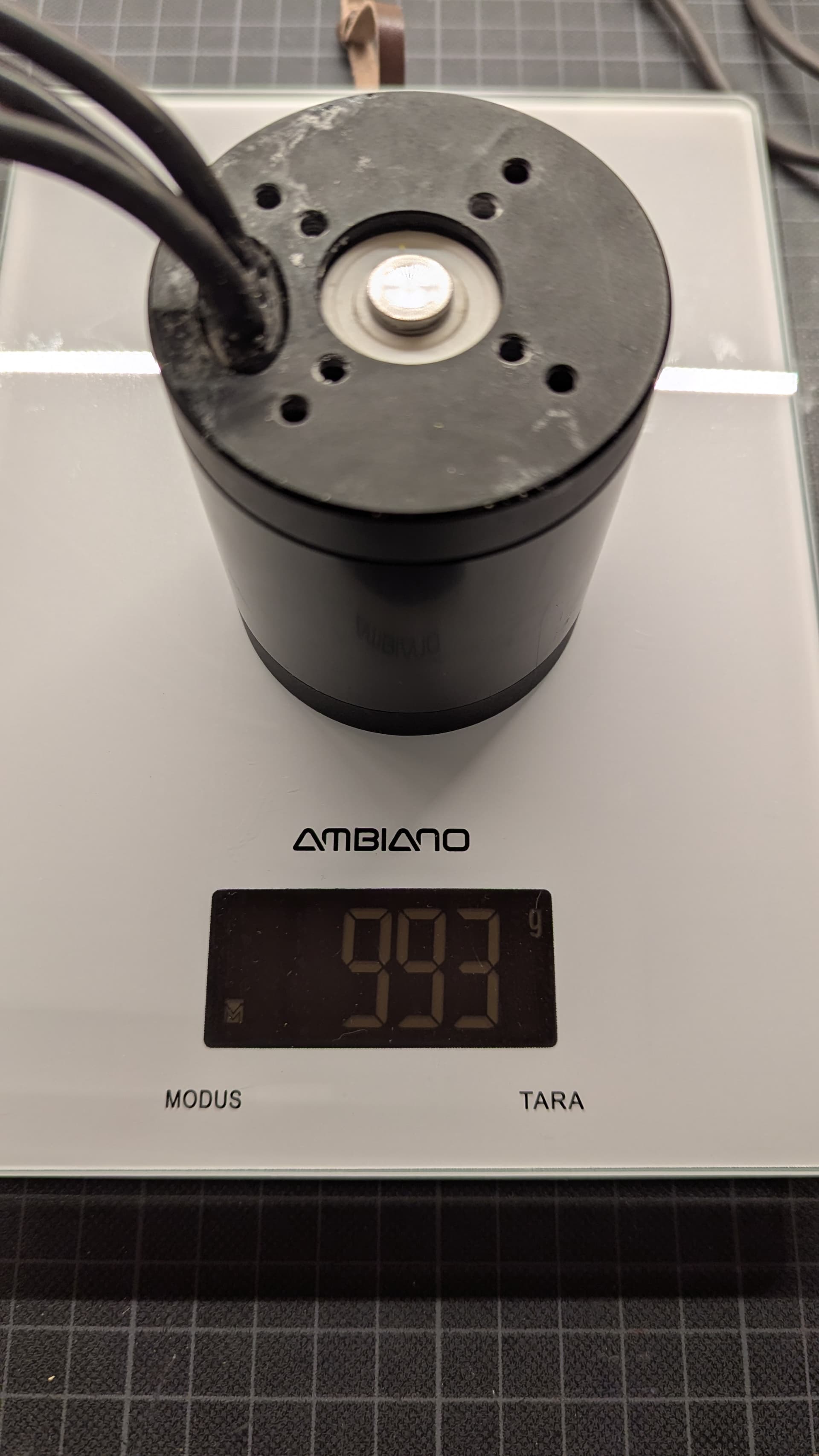

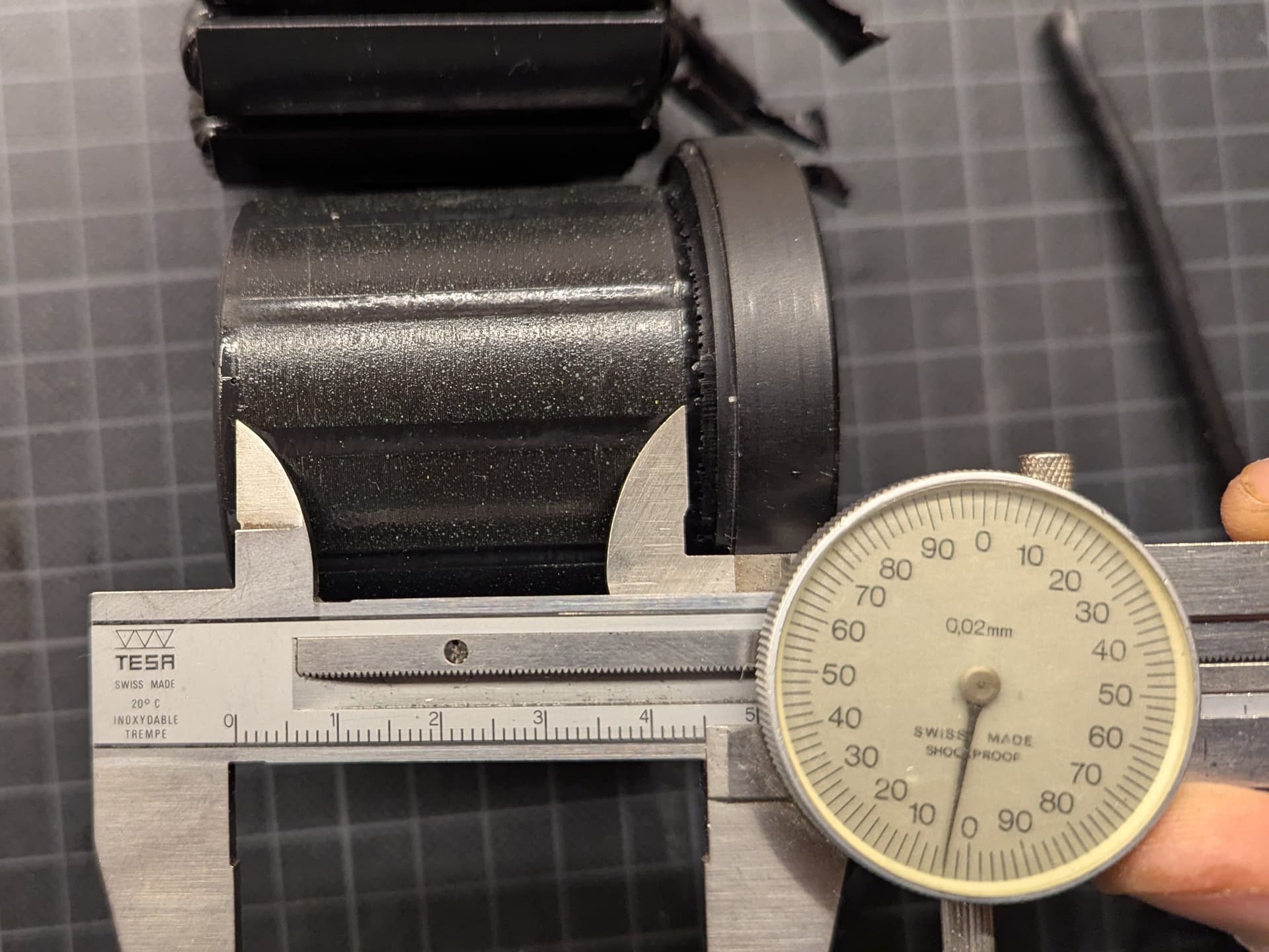

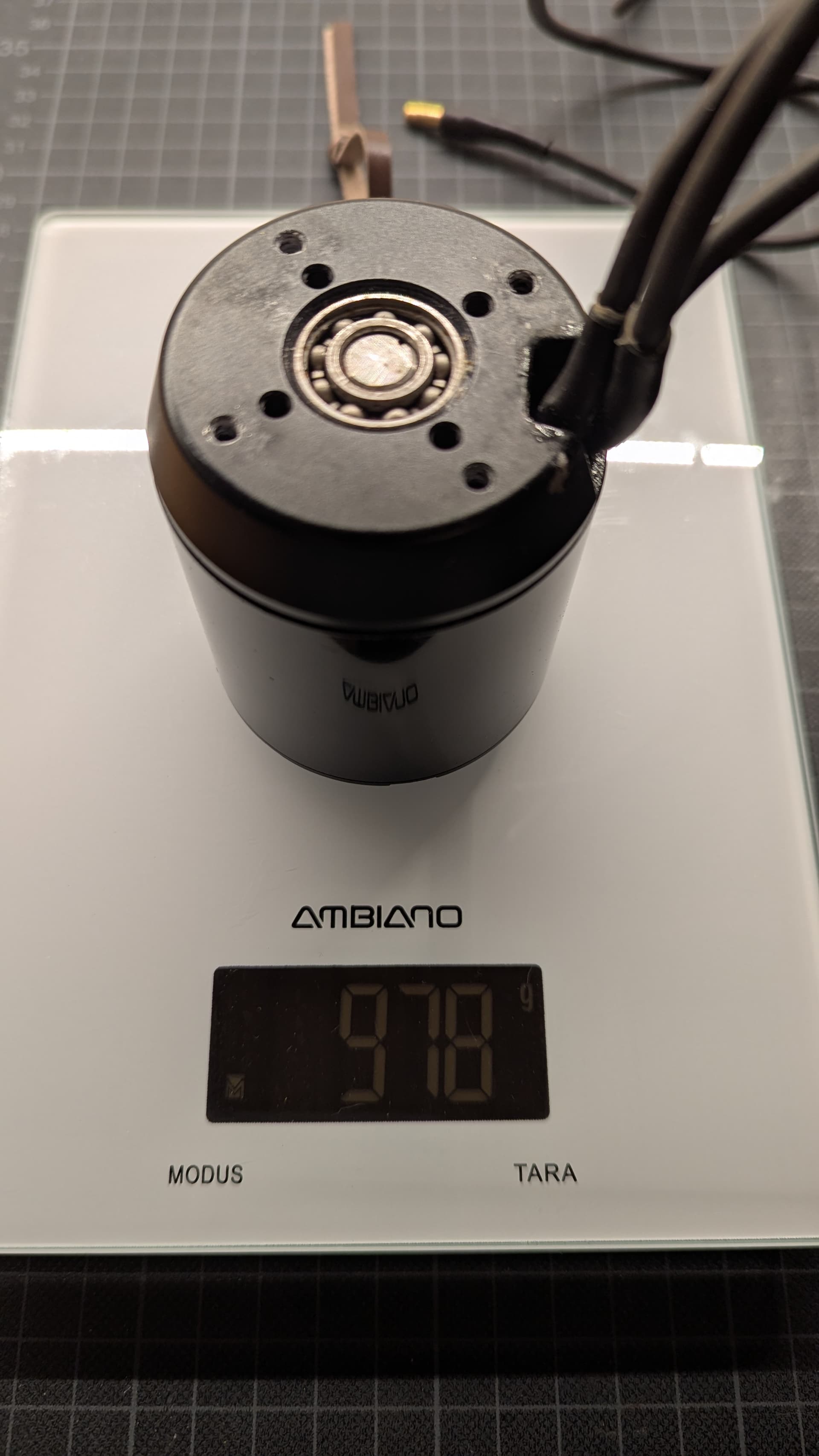

I checked my Flipsky Waterproof 6374 and Generic 6384 today.

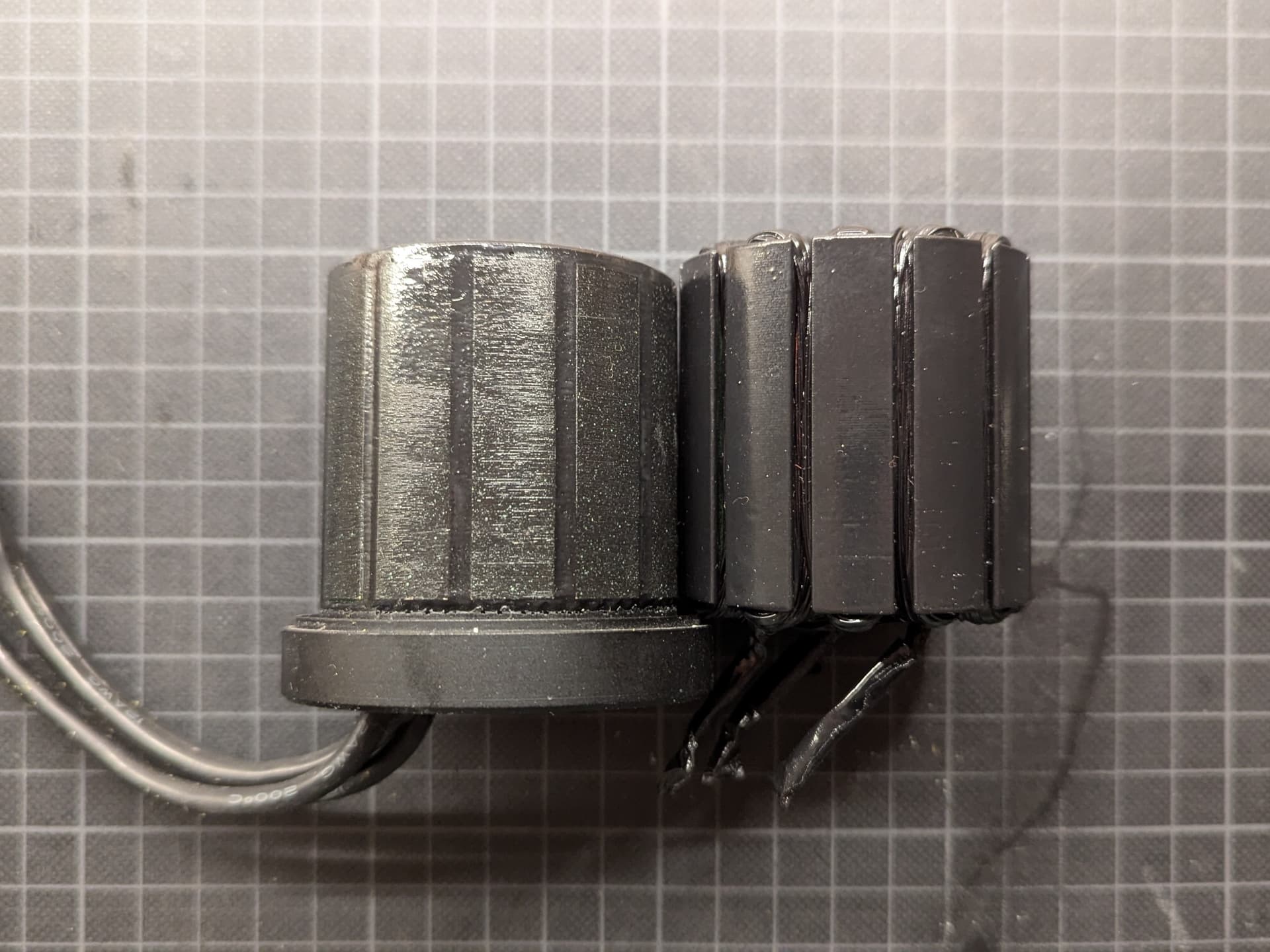

  1. Generic 6384 is actually only 81mm long making the Flipsky 6374 only 7 mm shorter.
  2. Stator stack length is 51mm for the generic *84 and only 45mm for Flipsky *74. Same length goes for each motors magnets.
  3. Weight - my DIY waterproofed *84 is even lighter than Flipsky *74
So I will go back to the cheap generic motor. Maybe even without waterproofing as the 2k Epoxy coat did not stick as good as I hoped. Only downside is the anoying laser marking which gives the ideal start for rust on the rotors.
We are mostly talking about the maytech 6374 here I think, That is much shorter than other 6374, I had made measurements.
edit, here is the post, the maytech 6374 is actually only 40mm stator!
You can also use normal epoxy, that is what I used for my Saite 63100. For the bell I added thickener and glass balloons to fill the gaps between the magnets. I use it for an efoil upto 4500W, It does not overheat. It is 5Y old, mainly used in fresh water, recoated and changed bearings twice.
Nice calliper, I have one of those too, bought in 1986, still very accurate and no batteries to change.

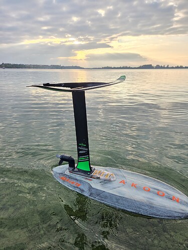

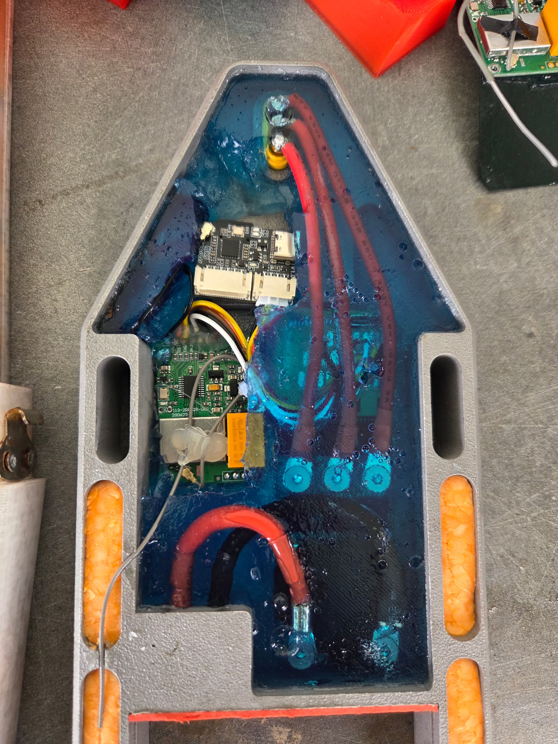

Setup is working, few notable issues :
  • 6374 maytech has to go, I give up. Now waiting for the 6384 and preparing a carbon prop based on fd type blade and mold made by a fellow DIYer.
  • some water gets into the xt90, I don’t know where it is coming Tru. Balance pogo seems dry. Temporary fix is silicon grease.
  • still waiting on the spare maytech rx and vesc express to get full system features (telemetry and BT)

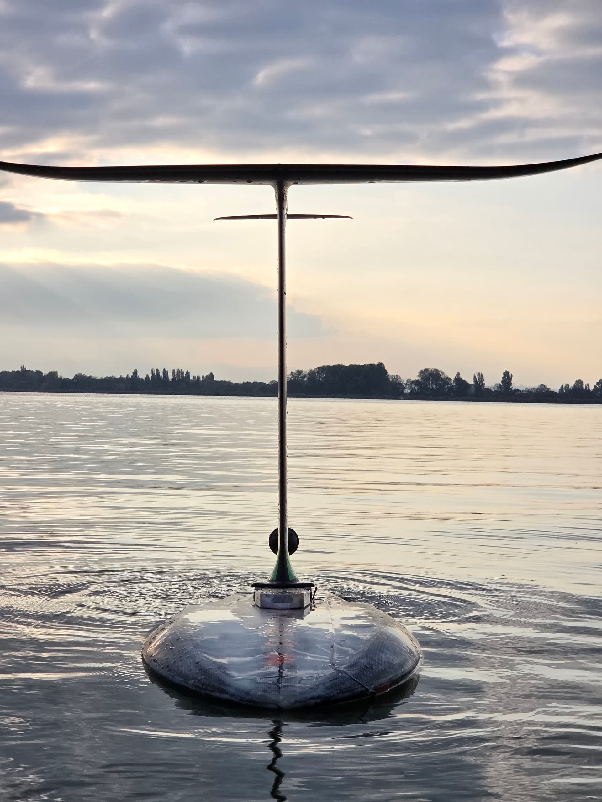

Should be my 4th battery on the v4 system, here with the 1050 foil after wind had died while trying to get the new pansh 4m parawing out

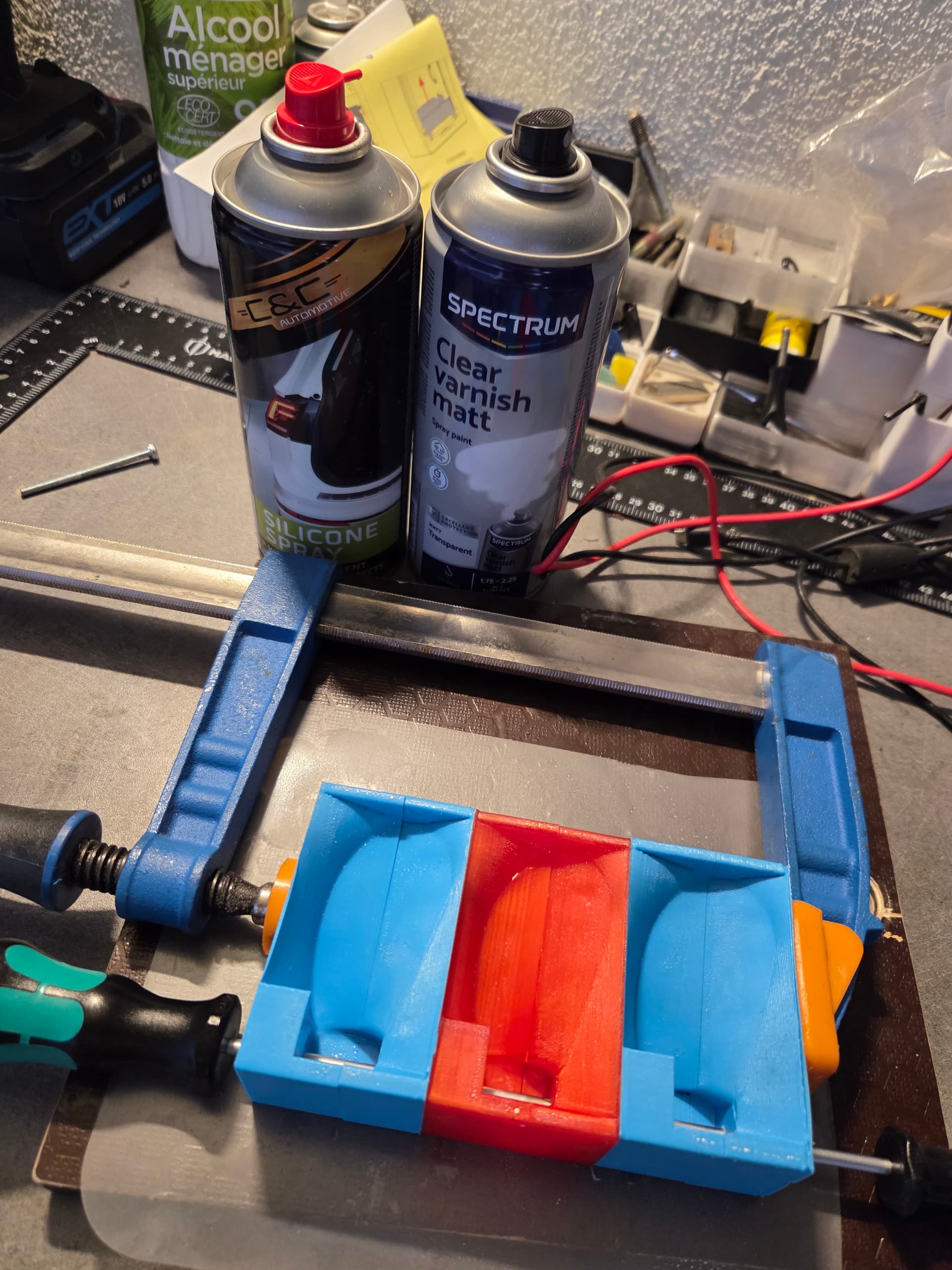

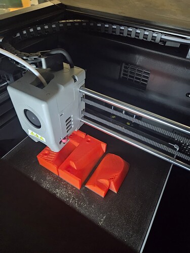

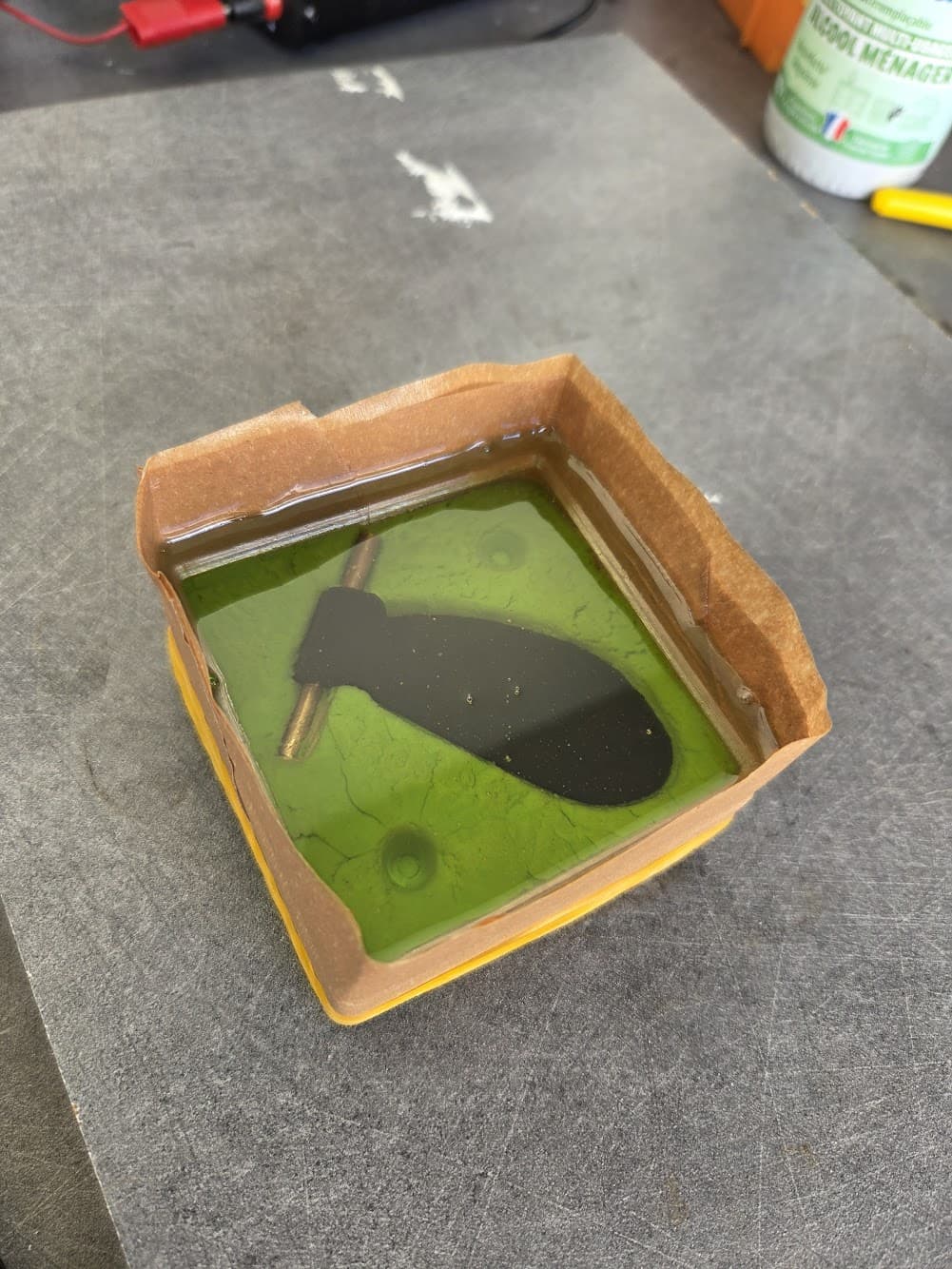

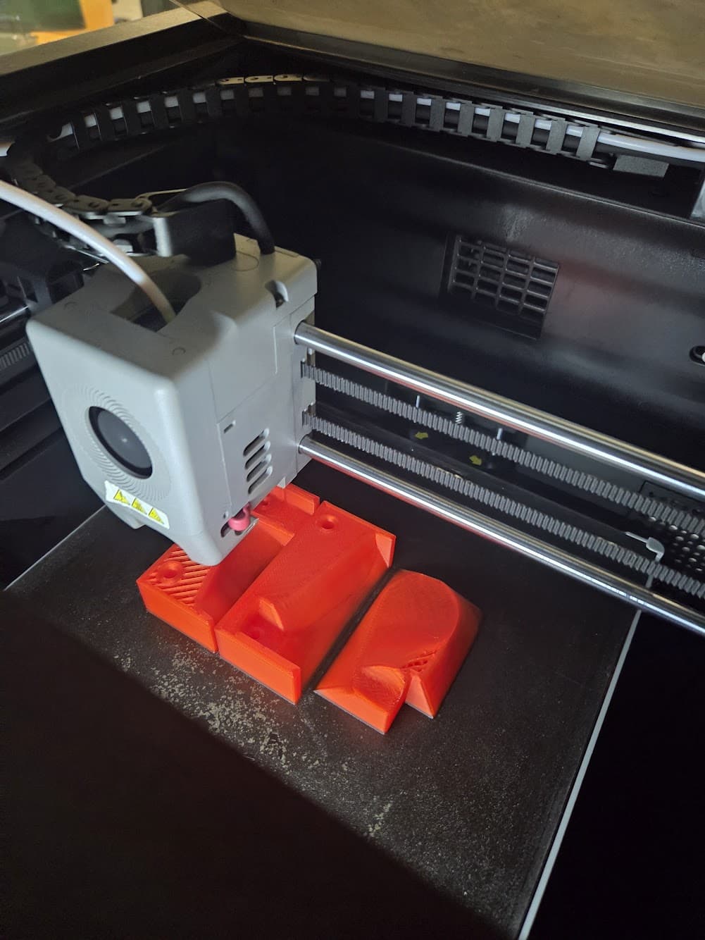

I did not have motivation to go forged blades again since then, but a fellow DIYer shared the STL for a replica FD blade, and I also found a hub for FD blades by another user. Based on a fd style blade, my friend designed a 3 piece mold that I will try soon.
I had made two blades based on FD scan as a test in a resin mold I made, but they were not compressed and precise enough to go much further.

Which XT90 are you using?
Xt90S, I had too much sparking on waterproof xt90.
I had some grease in the connector during potting and I think I may have a channel of grease instead of epoxy to the top of battery.
That or my sealing concept is not working as I would like, maybe the alu part has too much granularity on the surface.

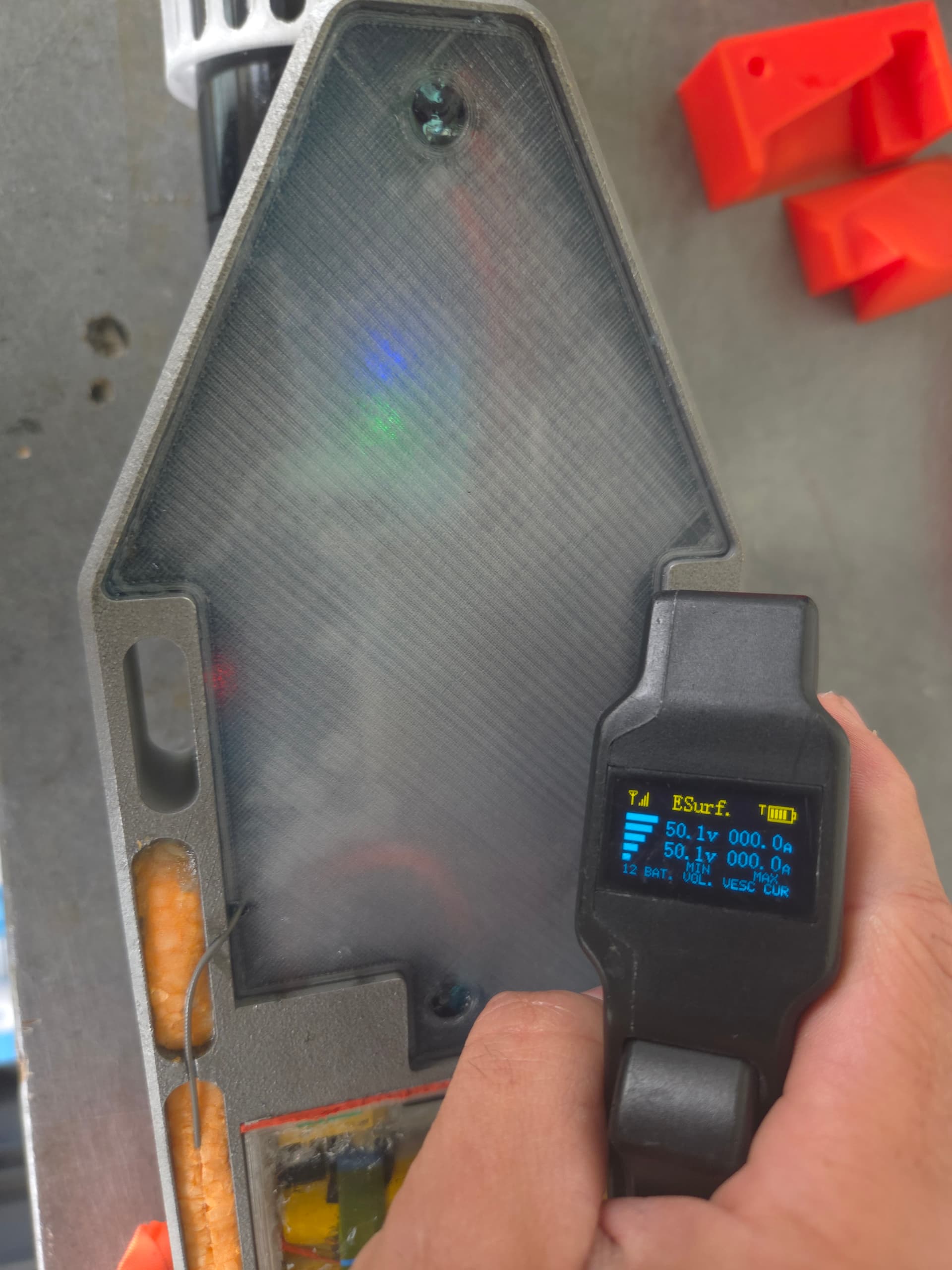

Also received the new vesc express and maytech rx today, after a bit of open heart surgery the system is back to fully featured state.
I like that status led are visible thru the gel and cover, but ideally those would also be visible with the foil mounted for quick troubleshoot in situ.

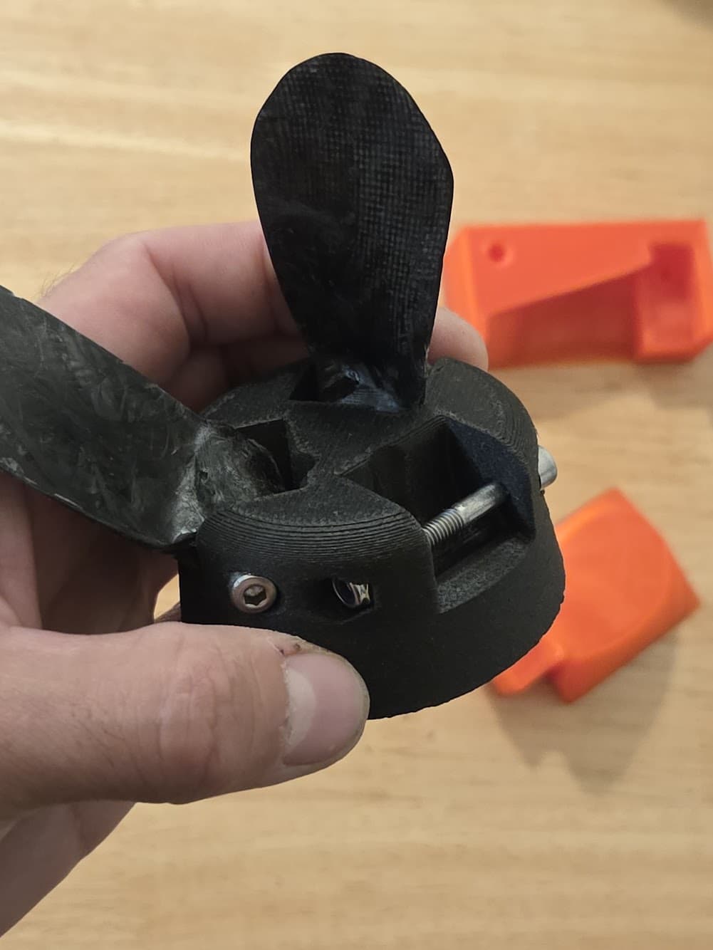

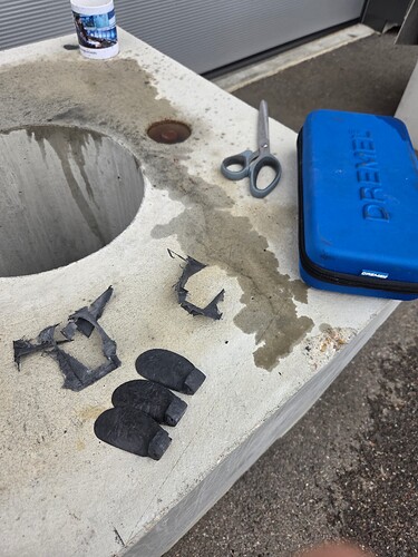

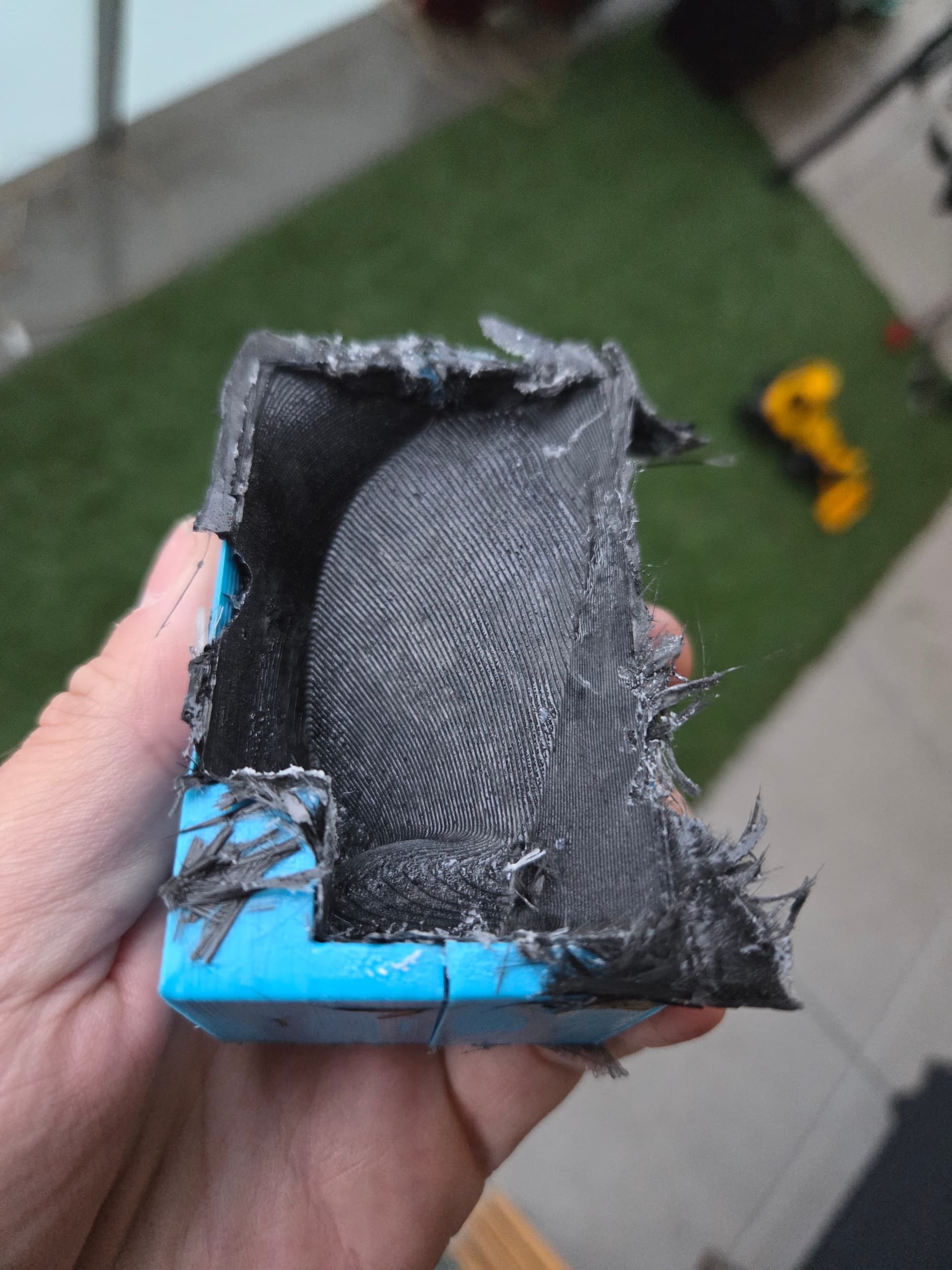

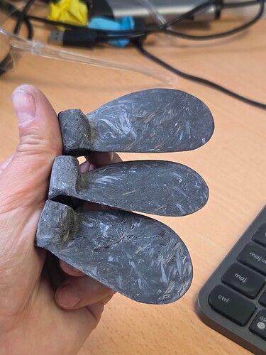

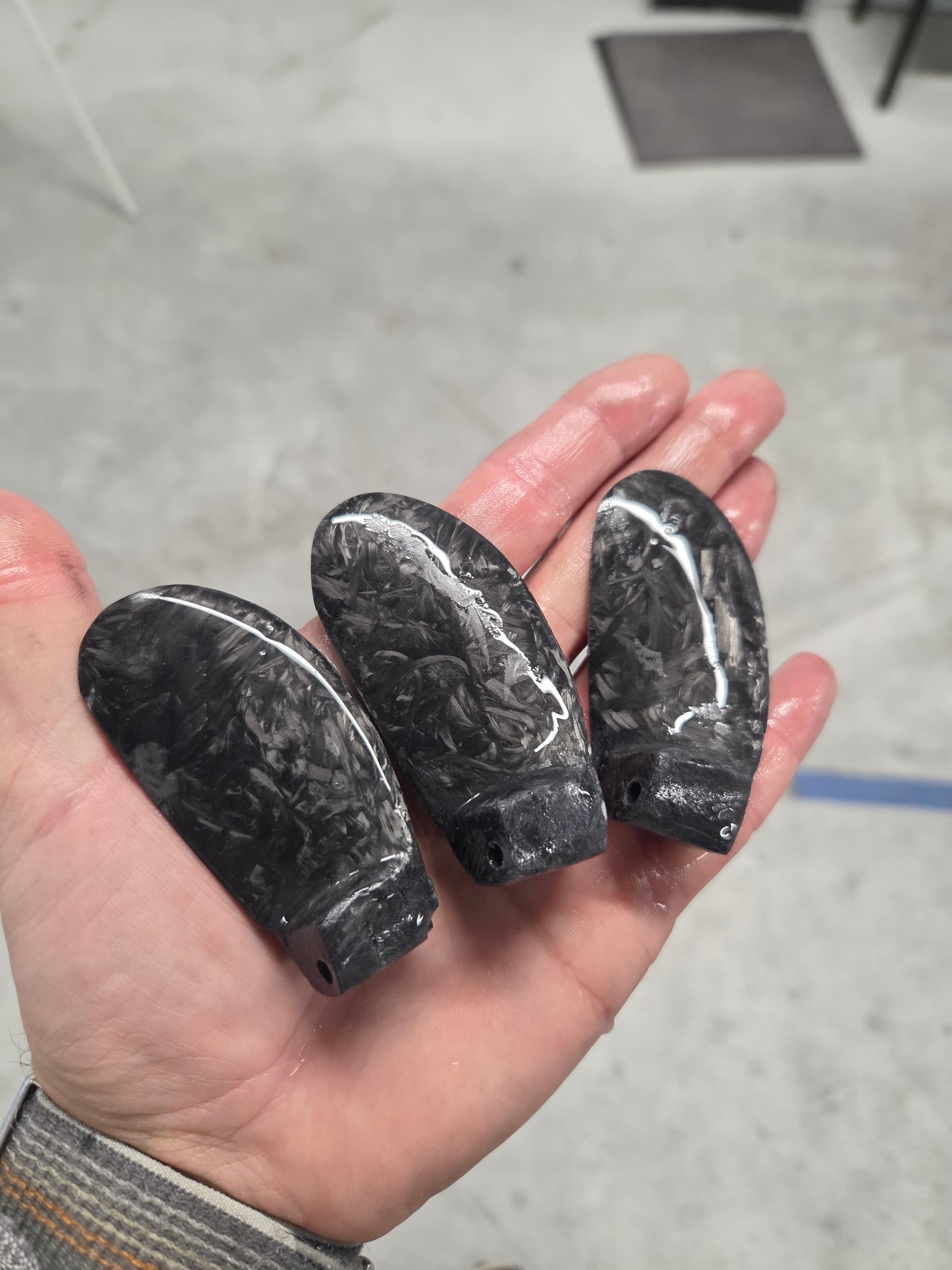

Forged blades here we go again :
Weight after initial sanding 9.6, 10.1, 10.4 gr
Some surface imperfections, and the fiber did not fully form around the screw hole, making a weak point in the part at the worst place.
I think that is more a problem of process than mold. I should have taken even more care into pushing the fibers around the 4mm rod during fiber loading.
Leave the rod out and 3D print a drill jig. That way you will get a perfect section to drill.
