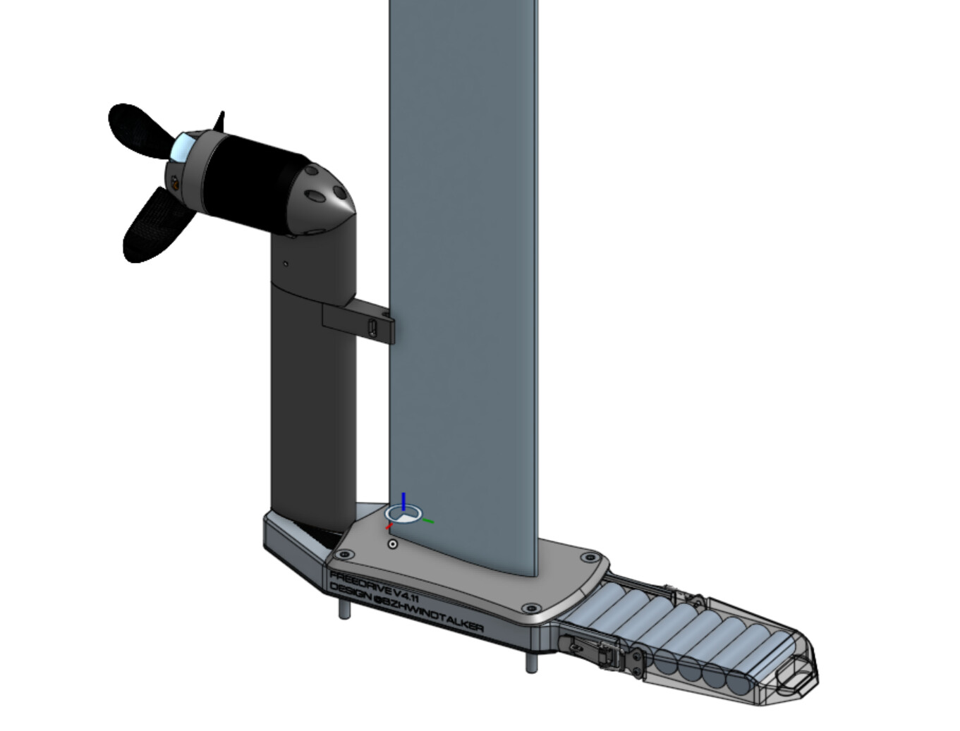

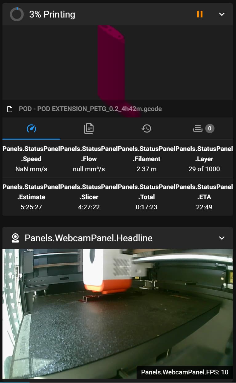

Printing that for my wife to try efoiling again, 200mm extension with brace to mast, will use a flex-starp nano to hold it.
With my printer and spool changer living outside, at least I know PETG is fully dry by now in france :upside_down_face:
Are you sure it will hold up? That is a pretty big lever on the connection at the housing, even with the attachment on the mast.

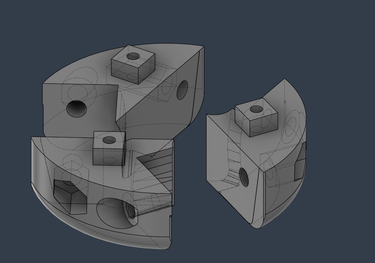

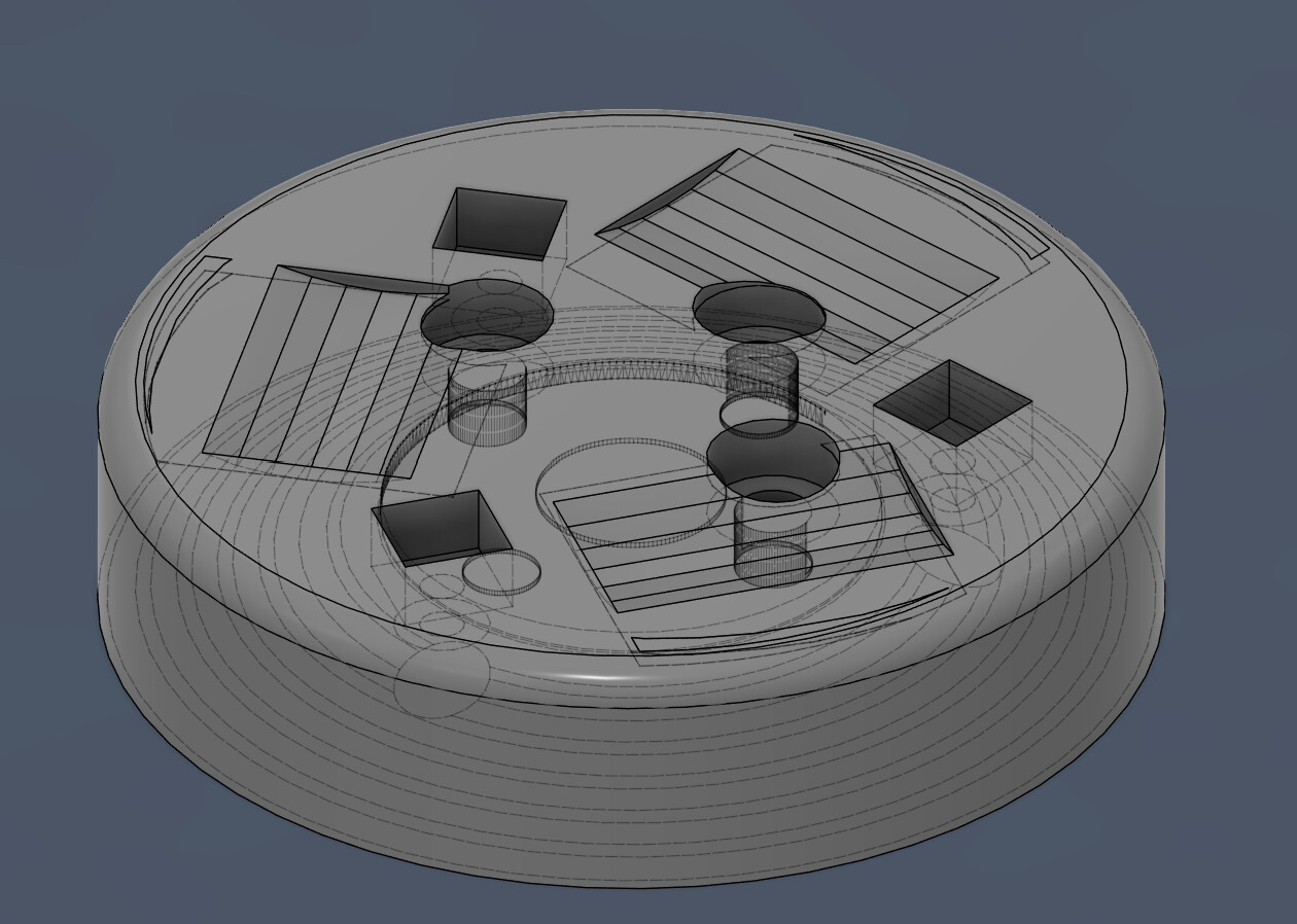

Is that your own hub design?
I wanted to fix this a long time ago.
Design it so the 3 parts that are now separated print separate in correct layer direction, extend them a bit so they intersect with the base and glue them in. Alternatively also put a small screw through the base into that part.
That should eliminate all issues with hubs like that.
I just do not have a good quality base to start off.
Hub from @foilstate, printed in ppa-cf, 5 sessions. Very lucky that it failed in shallow water.
Will get pa12 version to be safe
lol :joy:
Maybe just make 2 or 3 holes through the hub and glue some screws in as a quick fix until you receive pa12 hubs. This should be enough to withstand sheering forces regardless the print orientation.
Not my hub, but prints in PPA seems to have high Z axis strenght variation depending on the orienation and filament humidity/print conditions.
Last week I was parawinging with my modified bar and one of the PPA-GF bar ends just broke in two mid session, first part in petg-cf also broke.
so probably now I will spend more in PA12 prints and less in exotic filaments!! :money_mouth_face:
27 euros shipped for two hubs and two bases at prototi :thinking: :saluting_face:
how is PA12 with salt water im wondering if it will start absorbing water ?
I think this is the way to do it. So you can print the individual parts in the right orientation.
Did not get to finish it though and the base model is not great (I probably did some prior mods, that broke the geometry).
Would be nice to do this off a good base.
For materials, CF/GF are good for looks and temp resistance, but weaker in layer adhesion.
Another option to try would be to print this in solid TPU.
Looks good, if you replace the M3 hex nuts with heat inserts you get a bit more material around the weak spot.

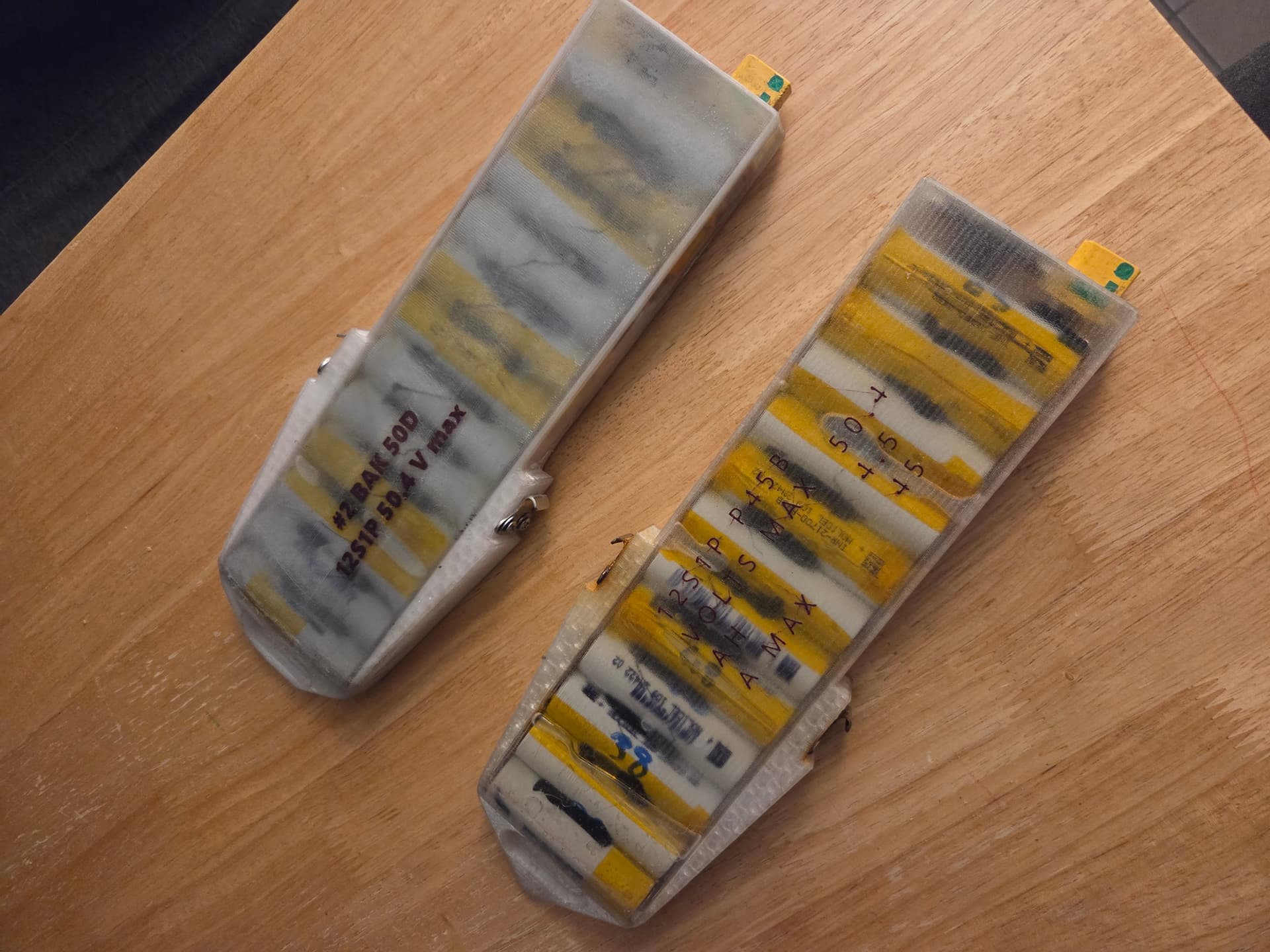

Wired a second 12s1p battery (bak50D) but did a holy mess :joy::joy::grimacing:
The carnage started with a leaky resin potting, (forgot about leaking tru xt90 holes) and swelling battery tray, making the insertion in the assist really hard.
Then I figured out the xt90 was backed out by 1-2mm and the contact is not on the right area of the xt90s.
I compensated by opening the gel to move the assist side connector forward by 2mm.
Happy about my fix, I went forward and plugged in the balance board, to find out that I wired the balance upside down (reversed magnet poles) and burn the balance board :sob:
Well thats a few productive evenings :rofl:
The other thing I did was to add 2mm carbon rods in the remaining hub to prevent splitting again. Parts were shipped from prototi but will not arrive until holidays at the sea next weekend.
I will test the alu prop and battery tomorrow to make sure it works :crossed_fingers:

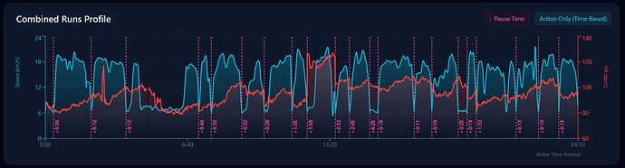

I tested the BAK battery and it works very well, now that I fixed the contact of the assist. I will figure out later how to handle the balance leads, and monitor the cells voltages for the time being. I need to check the data logging now to get more usefull data (battery sag and recovery). Great session chasing some boat waves.

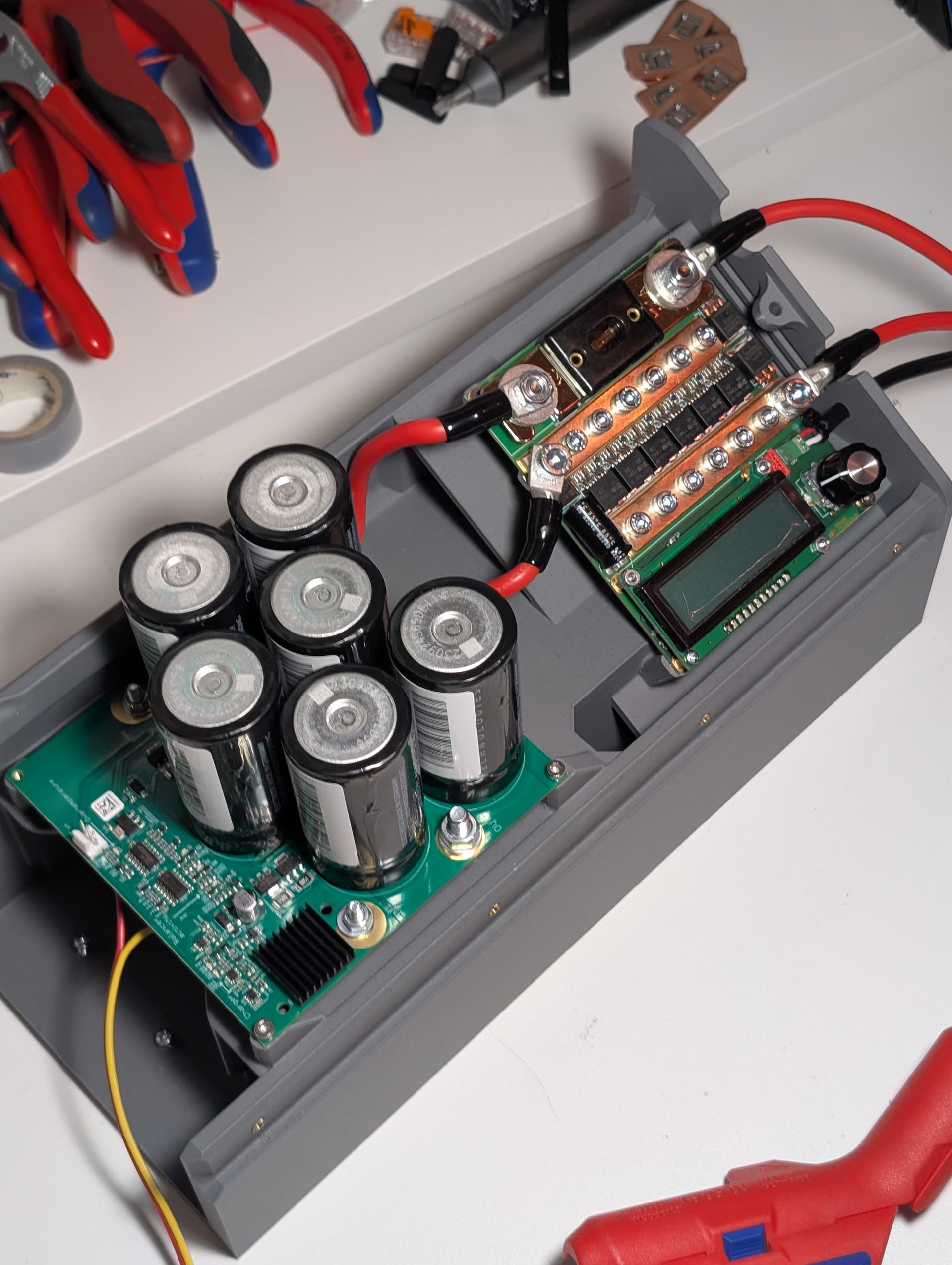

I have everything prepared to start welding my battery. Ive got a kWeld with the kCap PSU solution. As this is my first battery im not sure about how many joules to use for this welding job. Ive got the same copper nickel strip bzhwindtalker used in his builds. Can you give me an estmation of how many joules i would use.
Any tips are welcomed, ill keep you updated how it goes!
For the wellgo ali strips, I use 24 to 25J with Kweld. Best is to do some tests on a spare cell.
