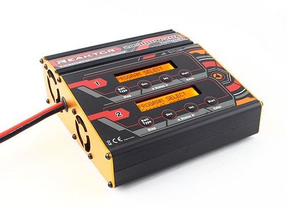

I just got my multistar 20,000 mah turnigys today. I did not order a charger. Is there one that you guys recommend?
Thanks,
George
I have this one with 50 A power supply
https://hobbyking.com/fr_fr/0620duo-600w-charger-300w-x2-version-2.html
Thank you @jeffM, I will order today. I think I fried my esc just connecting the wires like Pacifmeister did. I have to get the fuse/ circuit breaker. Looks like there are plenty of ways to fry an ESC
