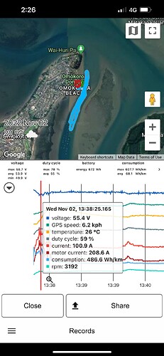

So some interesting stuff. I installed a new FR motor on the board. Old one still going but thought was time to make a board for the missusā¦
Tested it today and wow way more torque. Always struggled to get out of the water with the ma800 and it is now going up straight away. The log shows I also only use 200A motor current to get up on the plane. Thatās a lot less than with the old motor. I also seems to use a lot less current at high speed ect.
First motor was repaired after taking salt water and the magnet are corroded. Would weaker magnet lead to increase current consumption and less torque?
Heaps of seaweed today so couldnāt test max speed. Stay tuned
Basically cooked or corroded (= weaker) magnets will increase the kV so motor will create less torque and use more amps. Then probably corroded magnets also create imbalance in the motor fields as not all magnets will be affected by the same level of corrosion so a bit more is lost in lower efficiency.
