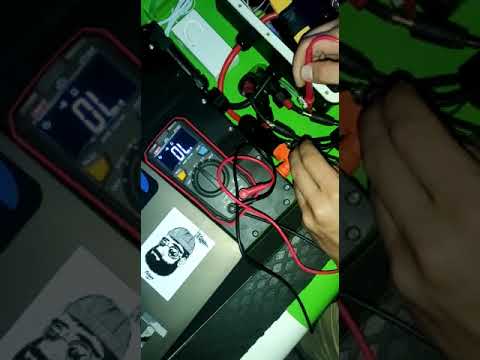

Picture & video below of what is happening:

  • I can measure 6 Ohm 6 Ohm and 12 Ohm between the phases (it seems there is a problem!?)
  • R measured by vesctool is really high
