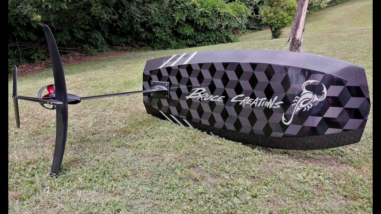

Hello everybody,
in this forum I’ve seen a lot of different interesting buildings.
This time it’s my turn.
Some solutions are more complex than necessary but I have to take advantage of every construction to test new possibilities.
this is the video (part 1) of the building process

I see you filled the mast mount so it hold the weight of the motor
The part I was missing too that do the job :
Hi Alexandre, thanks!
I filled one half of the mast mount just because I needed to connect the water inlet to the channel obtained in the mast (if you look at 4:39 in the video you can better understand what I mean). In this way I didn’t use any tube inside the mast and the section dedicated to the water was the larger possible. Also the mast is a little bit stronger because the empty spaces are reduced to the minimum.
In the opposite side I put the second half of the mast mount. The clamping of the motor is traditional, like FR do.

Yes I saw the water cooling , but FR clamps the motor mount using the plate show in the pic , which you don’t get if you just buy the motor unit, on mine I had to fill it because after crashing the motor moved
Ok, now understand what do you mean.
I don’t have this piece but I don’t think that is an issue because I did an interface between the mast and the clamp.

Hi all, thanks a lot, I’m pleased that you like it. I tried to do my best with no compromise.
I put some more photos about the battery compartment, it will be better shown in the part 2 of the video.
Optic fiber like :sweat_smile:… realized in epoxy to show the status of the ESC.
Glass fiber support to avoid vibrations

Cosmetics are incredible, but how is the esc cooled and why is the battery much smaller than the enclosure, since it needs to sit tight anyway?
