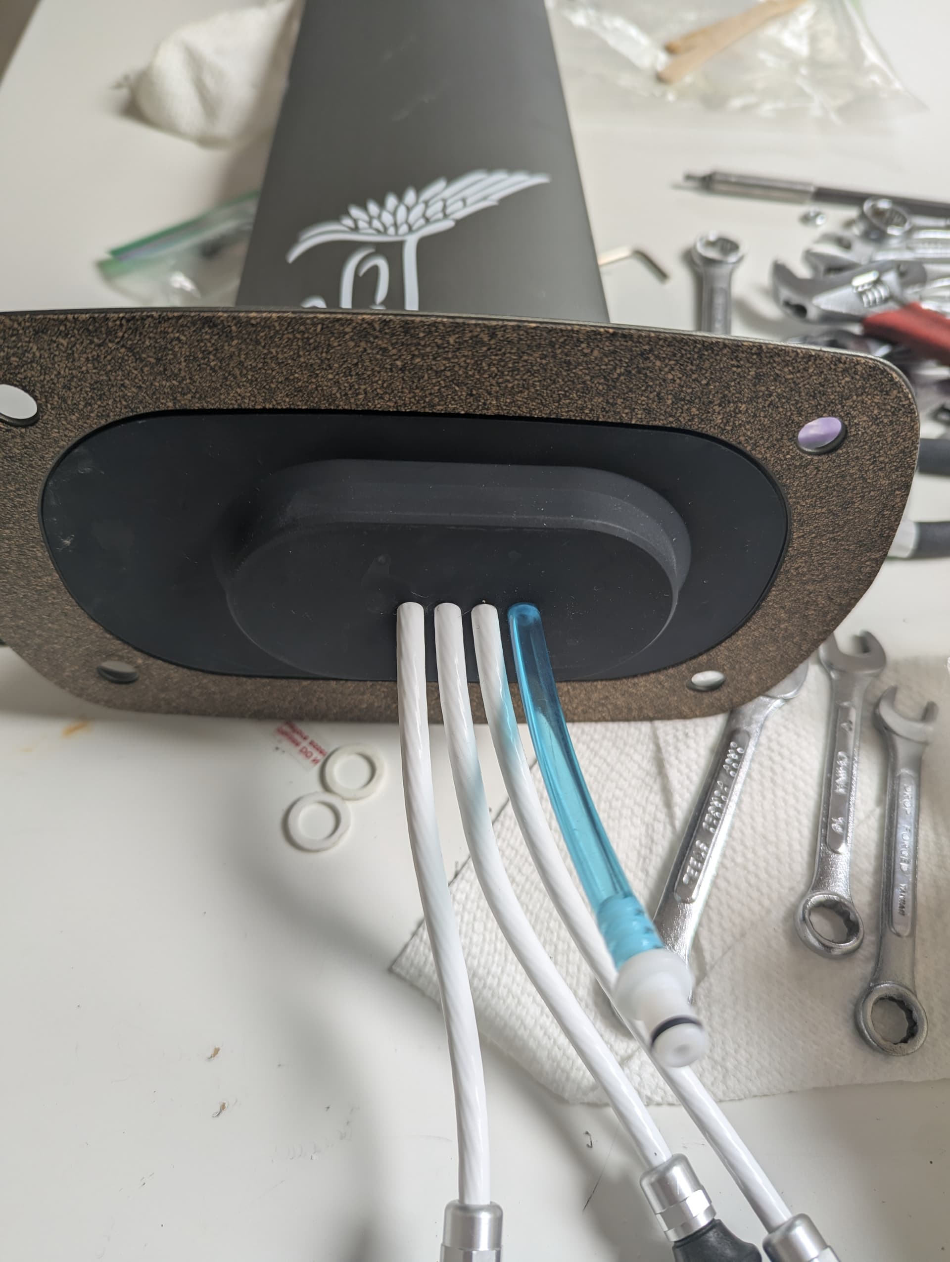

Lift efoil mast has several seals to prevent water from getting inside. Pls see if useful.
