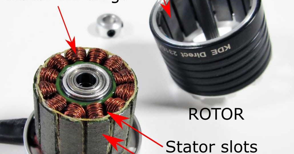

From what I have been reading it should be really noticeable. It seems that even matching the wavefrom of a BLDC with the closest ESC wavefrom signal make a difference in terms of performance. I read trapezoidal signal between a motor X and an ESC Y can be really different. Maybe this is why you have a lot of noise running the 80100 with the Swordfish Foiledagain. Could be interesting to check the waveform of the 80100 with an oscilloscope using a drill and compare it with the signal of the Swordfish. Look at the link below, a 12N14p outrunner tested with a scope produce a sinuzoidal bEMF while it has a concentrated winding. My 83110 is 12N14P, I think the 80100 is too, so better performance could be obtain driving them FOC.
