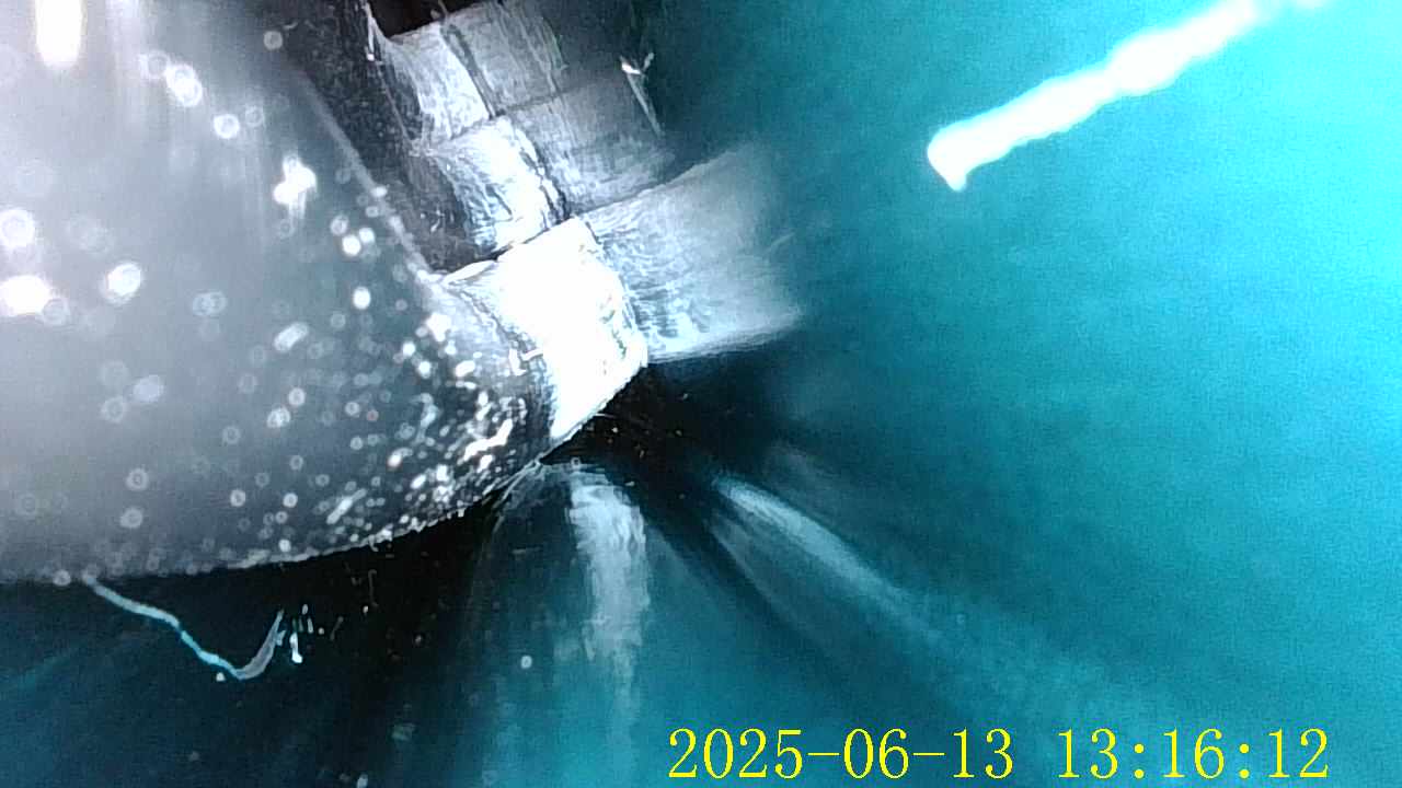

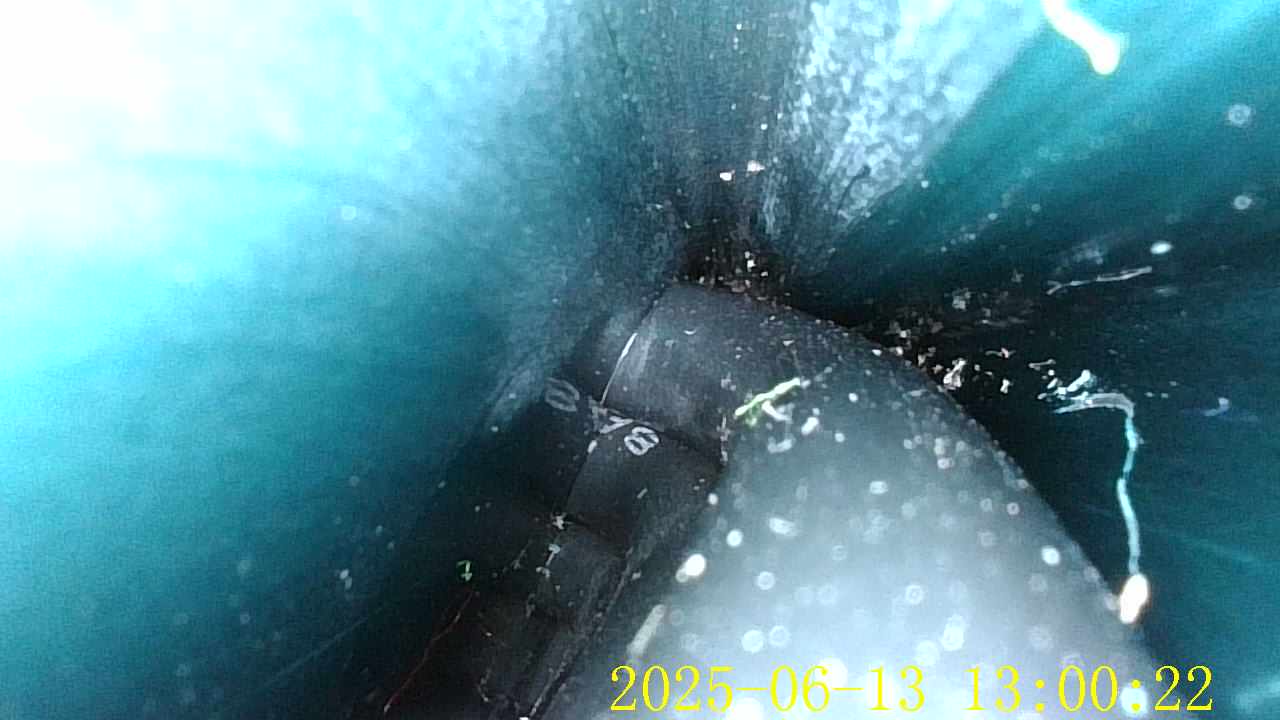

So, I did a test: I poured some water down the mast to see where it leaked out. Looks like my tolerances were just enough to compress the jacket into an oring seal, no leaks. I still went back and cleaned and scuffed the surface and applied the 5200. I send a bore cam down the mast to inspect the before and after, checking for insulation damage too, looks clean.
