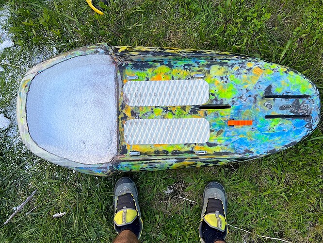

thanks brother. It works fine but I’m going to optimize it a little bit more. personal taste :wink:
it’s a little more work but that will worth. I’m going to remove the bulky floaty nose part that was not so useful.
more efficient battery placement and more space on the nose.
and yes, it’s a mess
setting a good rounded in shape pattern with plastic warp and filled with high density foam
the weight purpose is to keep the foam flat while it dries
I’m going to put some 5mm airex sheet to have a super strong extended base.
Should be ready in the next days.
Keep you posted!
