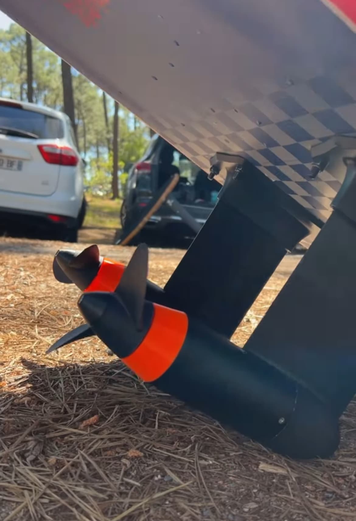

Hello quick update on my inrunner 65121 new setup
I’ll keep the same ESC configuration to 60A and see how it flies
I will madden it this week, in the meanwhile having a blast with my other one :wink:
https://www.instagram.com/p/DIuJwioq95u/
Hi all, quick update using dual 65121 requires 100% ramp up setting on the fly color ESC. The dual 65121 pulls like hell !

can you share what masts and pod your using for these motors?
How do you steer the tow behind you? Does not seem you can see it, do you hear it?
of course, I’ll post them soon.they are custom and I’m using gong mast,cheap and works fine

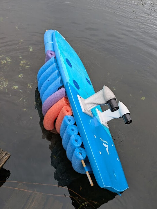

I’m looking forward to follow me mode as well, but I’m already worried it’s more likely to roll over because it will steer itself through steeper waves, which I can avoid when manually steering it. I need a solution to have it self-right itself. I’ve tried this “Roll cage” but maybe I just need more noodles!
Put the noodles on one side so that it gets to the point where the motors will pull it over and always self rights the same way.
