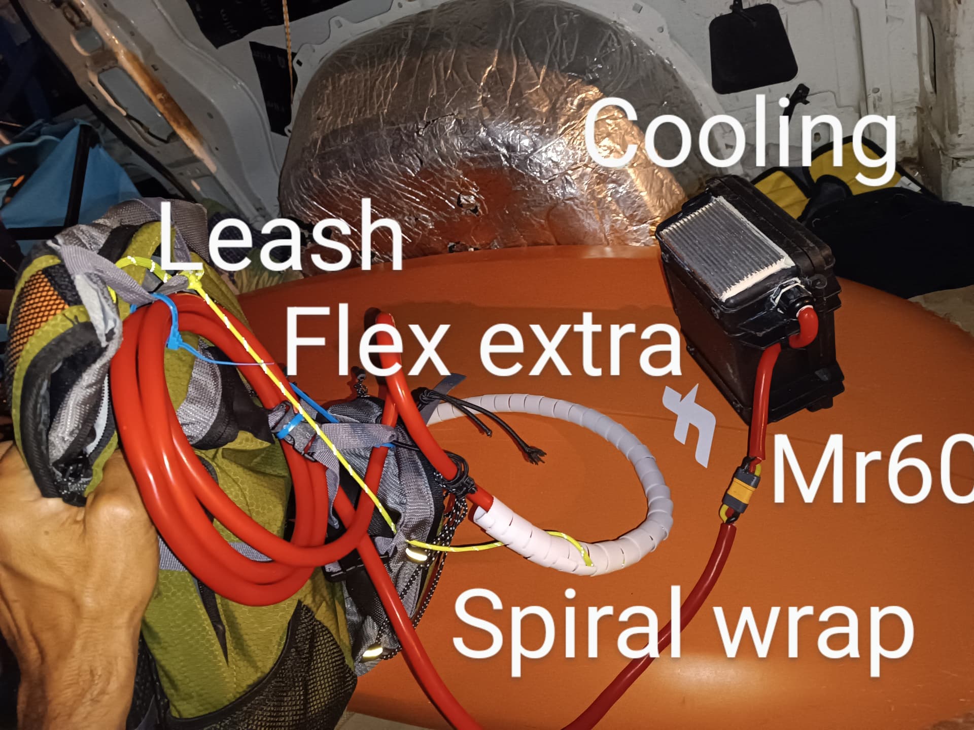

In the backpack ¿Cómo se hace para tener un buen enfriamiento de la unidad de velocidad variable?
It’s a classic heatsink like Foildrive

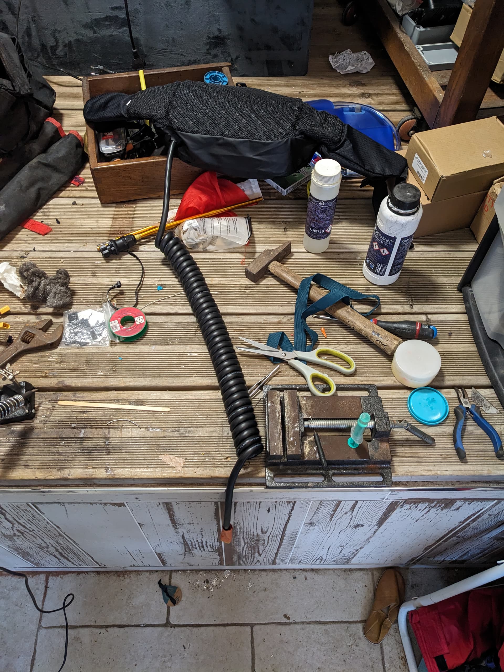

Why not run a coiled cable and leash through the centre? That way they have a similar stretch.
Or run a coiled power cable with a retractable leash through the centre.

This is exactly what I am doing this days, I felt guilty to leave my backpack foil assist taking the dust because I only use m’y tow since a year and I discovered Flow Custom V2 solution so I took the train :wink:

For the moment, I tried it one time on flat water and loved it. It doesn’t snap my leg when I pump like I was supposing before using it.
As my leash is way shorter than the cable extented, it feels very safe and it is tidy & clean.
By the way, with my backpack, I had 3m of cables, now only 2 with beltbag.

Hey what did u do for your leash setup? How long did u go with the coil? How are you cooling in your backpack?
Here is my current setup.
Cable to the board length up to 2m.
