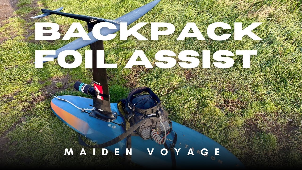

I had my first outing on my backpack mount yesterday. It went better than I was expecting. I need to do a whole load more tests in a variety of conditions but you can see a clip here and I’ve written some ramblings in the video description of my findings compared to my other builds.

Great build congrats! What cable are using in this build, is it lapp 400p?
Thanks. Yes - the 400p cable. I coiled the top part myself with a hot air blower and a wooden pole.

Using the same belt as you for quite many years, great product I am not quite sure what are you using as a main leash.
My plan is to use Leashes - Foil Leash Lite - Manera - EN (90cm version that stretches to 150cm, I’ve removed the shock cord from the strap) hopefully wrap the rest into neoprene sleeve.
That leash looks good. A friend made mine. It’s just some strong dyneema with elastic added. It stretches to 5ft.
